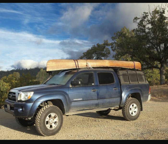

    I did a bunch of searching to no avail. Does anyone know the specs on this truck? What lift/tires were used and possibly if the owner has the build on here. Thanks in advance.

    Tires look like they are possibly 255/85r16

    It's probably around 3" lift

    That what I was thinking. I,was thinking 235/85 on the tires though.
    The way this truck is setup would be perfect for me and what I do.

    "OME lift on it, 886 coils and Dakar spring pack. I like the tires [255/85r16 BFG KM2's] a lot."
    So hey there ya go!

    Thank you all. You all are the best at finding stuff on here. I knew someone knew the truck. I love this truck setup. Its custom but not crazy.

    So this is basically a 33x10r16 tire. I dig the pizza cutter look. Some fit 265/75 with no lift, while others will use a 3 inch lift. I think alot of it is how you drive.

    Yep that's my rig. Looks a bit different now.
    I had very minimal rubbing issues with 3" of lift and the 255/85 tires. I have Cooper Discoverers currently.

    I did not have UCA's then and of course you can't get to the ideal alignment specs. I ate those tires quicker I think. I have Total Chaos UCA;s now.

    What tire did you have then? I have a lift of around 2.5" and was going to buy 255/85 r 16 or just join everyone else and do 265/75. I don't want to have to trim.

    First of all sick truck! The UCA info will come in handy when I start buying tires then. Tires are too expensive not to get new UCAs.

    Those are KM2's in the picture. Trimming for me was 5 minutes with a knife.
