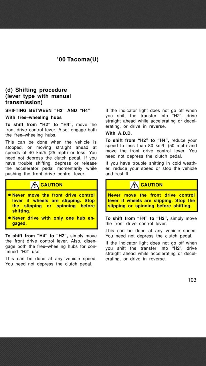

    If by regular shifter you mean a manual stick 2 hi Neutral 4 lo 4 hi transfer case in addition to an auto matic transmission then the hub repair should get you 4 wheeling.
  9. Jan 11, 2020 at 7:46 PM
    Black DOG Lila
    Black DOG Lila Well-Known Member
    Jun 14, 2019
    #296344
    9,116
    Virginia
    2003 Tacoma SR5 2.7 5 speed 4WD
    Stock. EZ pass.Dump pass.Inspection sticker.Convict printed lic.plates.FG cap.
    I'm assuming you know yours is not a shift on the fly 4wd and must be stopped to engage the front differential into 4lo.The manual Tcase may need a little bit of clutch drop before going from 2hi to neutral to 4hi or 4lo. And may require rocking forward / reverse to dissengage the Tcase from front differential. You can drive with hubs locked in 2hi but must come to a complete stop to shift into 4lo.

    Yes I know but the clause "if you have trouble shifting stop" tells it all.

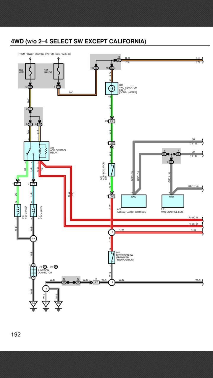

    Sounds to me like it might be just an electrical issue with the light on the dash. If it's really not in 4wd then you might have some sticky locking hubs though.
    Wiring is something like this, except you don't have the ADD stuff.

    That is also qualified as in cold weather.
    I never stop to shift, and only slow down below 5mph to go into 4lo. Always goes nice and smooth.

    It is winter here in Virginia and seeing how OP lives across the river from me and it was 70 today that cold weather clause shouldn't apply so I suspect another mechanical or electrical issue. Although I don't have hub locks shifting on the fly gets more difficult as years go by. No way could I get into 4lo on a slow roll. I have fresh 75w90 am I missing an adjustment which allows better Tcase shifting?
