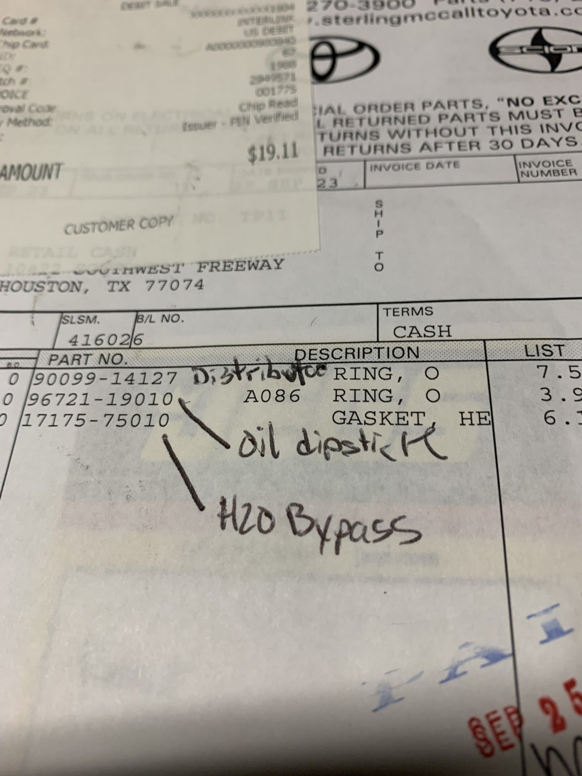

    Easy peasy
    Hardest bolts to deal with are the 2 steel air resonator bolts that go into block. Unless u have a mirror, like trying to thread a sewing needle (upon re-assembly)
    Also…..while cap/rotor off
    See if there is oil seepage from bottom of distributor
    Simple O-ring
    mine is 96 2.4L pretty sure same prt#
