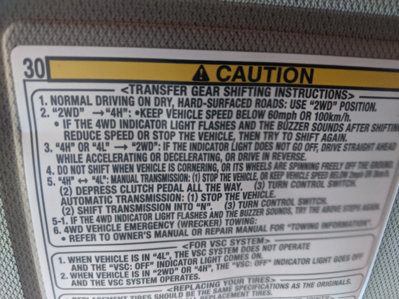

    So what's the truth ??????

    The manual and the sun visor state 55 mph, could be 50. I'll check in a minute.

    We are all a bunch of liars! It's 60 mph.

    Yeah, sorry my mistake. I was thinking 60kM and converted it to miles for those still in the dark ages with Imperial Measure. I will correct in my post. Thanks for catching that. My buddies in Myanmar will appreciate it.
