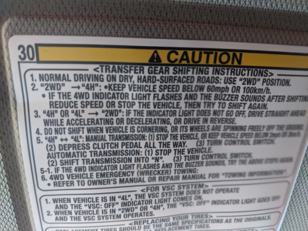

    I think max speed in 4hi is 55mph
    RTFM

    Max speed to engage 4hi is 55-60mph
    Once you're in 4hi you can go as fast as your truck is capable of going, but chances are if you need to be in 4hi then you probably shouldn't be going that fast for the conditions you're in

    Ahhh :burnrubber:

    Wrong

    Nice picture, reinforces what I said. 2wd --> 4hi keep speed below 60mph.

    Agreed. A lot of people give bad info on here about 4wd,when to engage etc.
