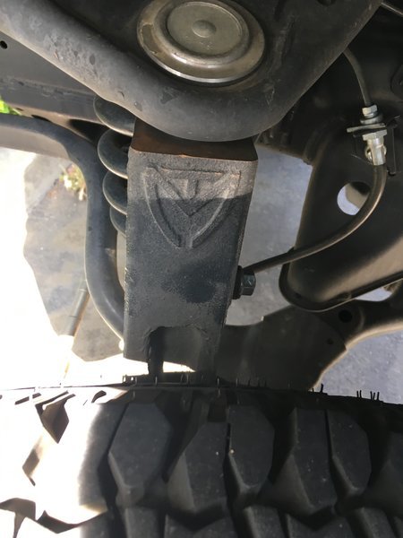

    Hey Tacoma owners. I bought myself a used truck and they gave me no info on the lift kit. Can anyone explain the type of lift kit the truck has ??

    sorry. New to this. I tried to upload more pics. Only uploaded one

    Correct, its a maxtrac spindle lift. This is usually either a 4 or 6.5 inch lift kit from Maxtrac and are only available for 2wd tacos. These lifts allows for the factory geometry and ride to maintain the same, while also using factory shocks and coils.

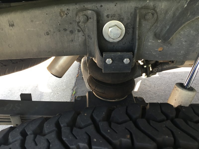

    Oh and thats the pic of the rear. I know its a ride rite air helper spring.

    Not a bad setup. Appears the previous owner did it the right way.
