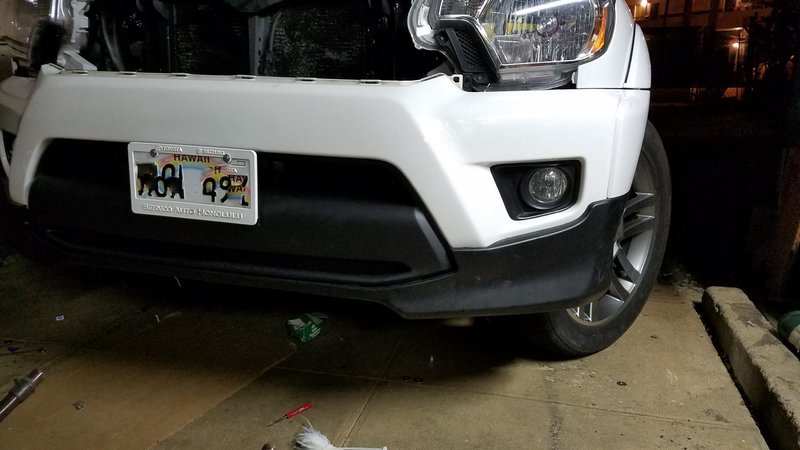

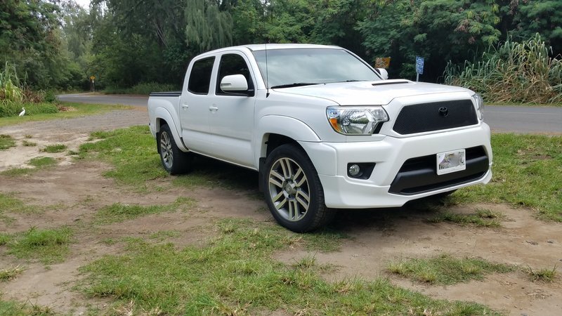

    Finally picked up drop kit and lowered mine.Was always looking for some pics of kit installed on truck but couldnt find any.So got some pics.

    I like it.Ride not as bouncy when bed empty.Need to order short bump stop for front (from tundra racing) because stock one got about a 1/4 inch till it hits .Ride was harsh because was always hitting bump stop.After short bump stop installed was all good.Rear will ride on bump stop about 3- 400 pounds.Handles a little firmer and mpg didnt change.Looking to put some black rims in future.

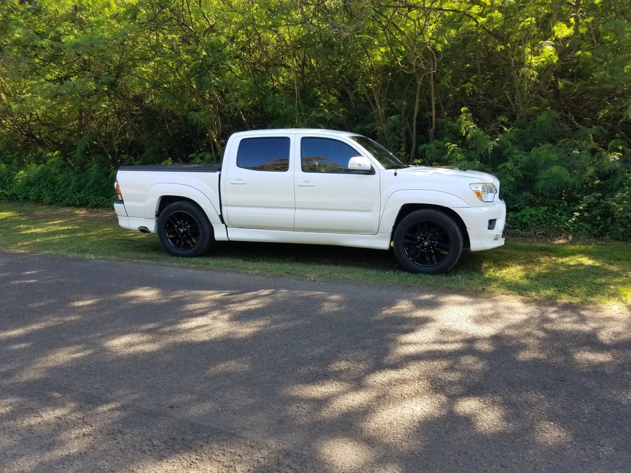

    awhile went by .spent some money lol....
