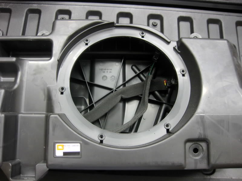

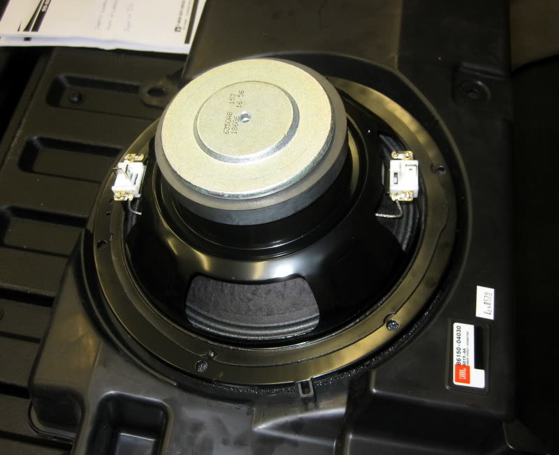

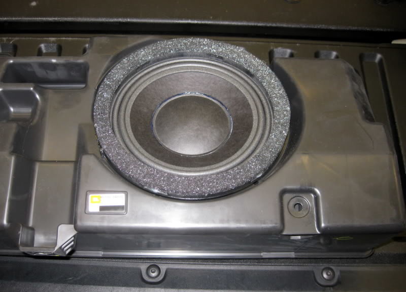

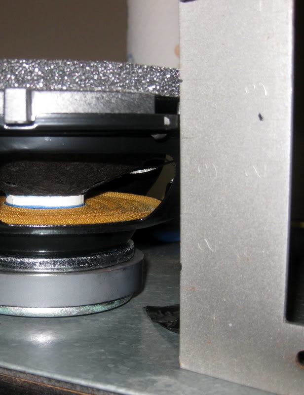

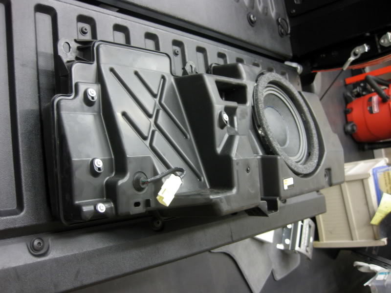

    here are some basic info about the stock sub in a 2006 Double Cab
    subwoofer mounting depth. 3-3/16"
    enclosure depth to bracing/webbing. 3-15/16"
    approx depth of bracing/webbing. .5"
    some pics

    Wow thanks for working this up! So now the question is what can we do with this info? Are there other subs that might work better than the stock one and will we need an amp to drive it? What is driving it now? What is the size of the sub, it looks like an 8.

    i stuffed the enclosure with polyfil, added some deadener to the outside and connected it to a 150wpc amp and 880prs doing sound correction duty.
    although, it's not capable of much volume/spl, i'm pretty happy with the sound quality.

    This might sound like a stupid question, but is the oem jbl box 100% sealed ? or does it apear to be ?
  10. Jul 24, 2012 at 5:46 PM
    ashman5
    ashman5 [OP] Member
    Aug 30, 2009
    #21977
    10
    Yes, completely sealed.
