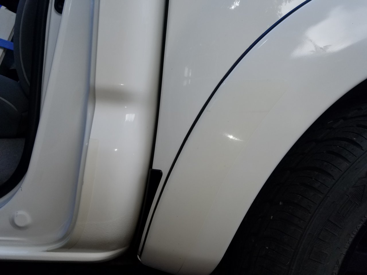

    If someone hadn't replied to this just now I would have forgotten all about it! Based on a suggestion from a Facebook group.. I bought 3M 03618 Adhesive remover and some plastic razor blades with scraper handles. It took some scraping, but it came off pretty freaking easily. I did the entire driver's side in about an hour.
    I took a pic about half way through. I'd done the vertical portion and you can see the before on the bottom part. It looks so much better now that it's all gone!
    These are the products I bought.. just for reference. Hope this helps someone!

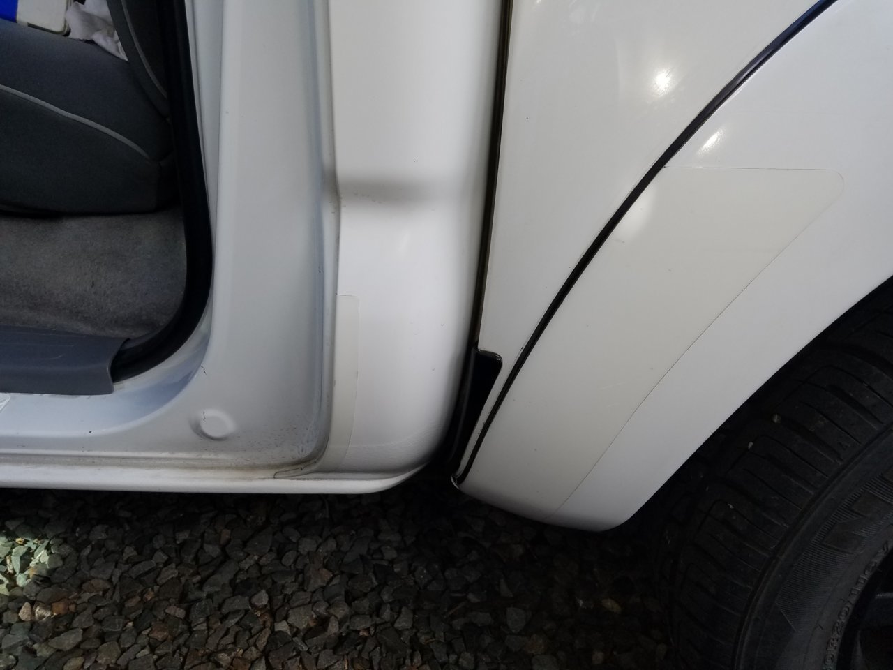

    I used tub o towels to clean mine . 2nd pic shows the edge still dirty . Already had cleaned film before thinking about taking pics .Was pretty dirty . . Cleaned most of it well. 1st pic cleaned edges with tub o towels .Need to use finger nail with towel to get all dirt out . Also clean interior well. On door panels gets dirt out of all the fine grain of the panel .
    Hell it cleans everything lol. Home, work what ever. Pretty amazing .
    Was going to change film but cleaned up good .

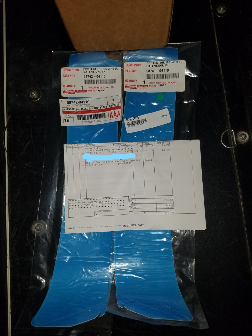

    Pic of part # if you need to order
