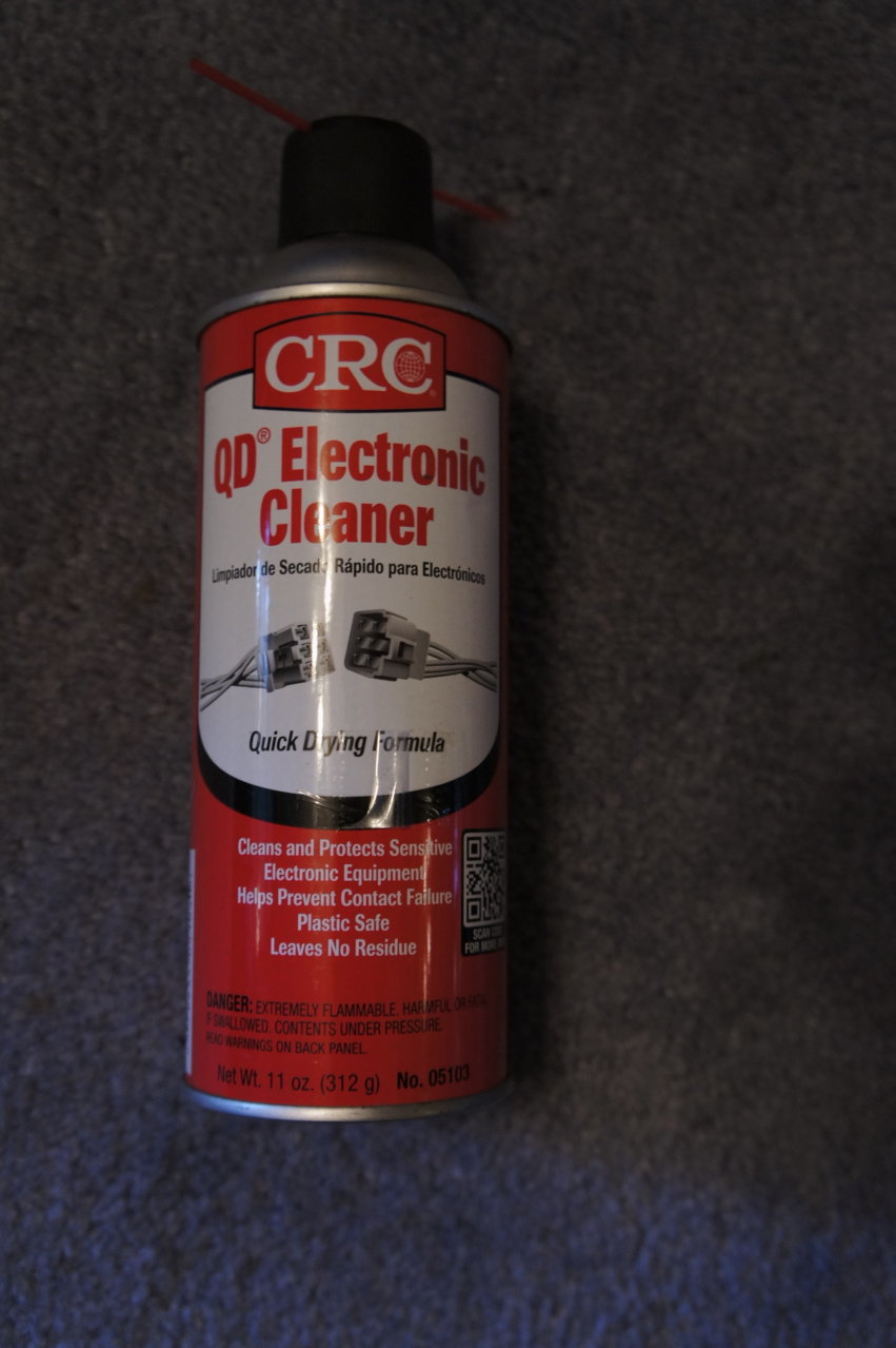

    My guess that fluid got in/on contacts. That needs to be cleaned. They make spray contact/electronic cleaner.

    :hattip:. Thanks. I've got some of that on hand!

    Using the Dell service manual, I removed the touchpad and click buttons, spayed it down w the clear as above, dabbed the connections with the cleaner and swabs, let everything dry and reassembled.
    Touchpad and click feature seemed to be working fine but now I’m getting boot errors. HD was removed and reinstalled per procedures...
    Saved the limb only to kill the patient me thinks..
    Appreciate the help though :hattip:
