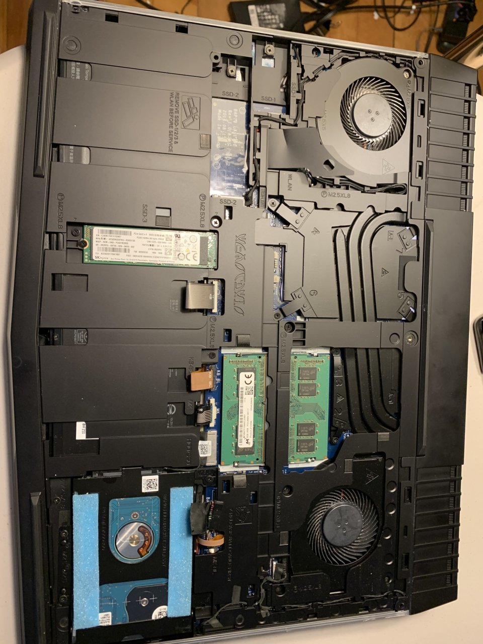

    Huh...
    I’ve scrutinized the HDD cable connection and it doesnt look damaged. Maybe something internal to the ribbon.. It’s definitely not seeing the HDD.
    Edit: checked the Service Manual- you are correct in the keyboard backlight ‘guess’. :hattip:

    Could you post a pic of the laptop without the bottom on?

    This is a pic as I was closing ‘er up yesterday.
