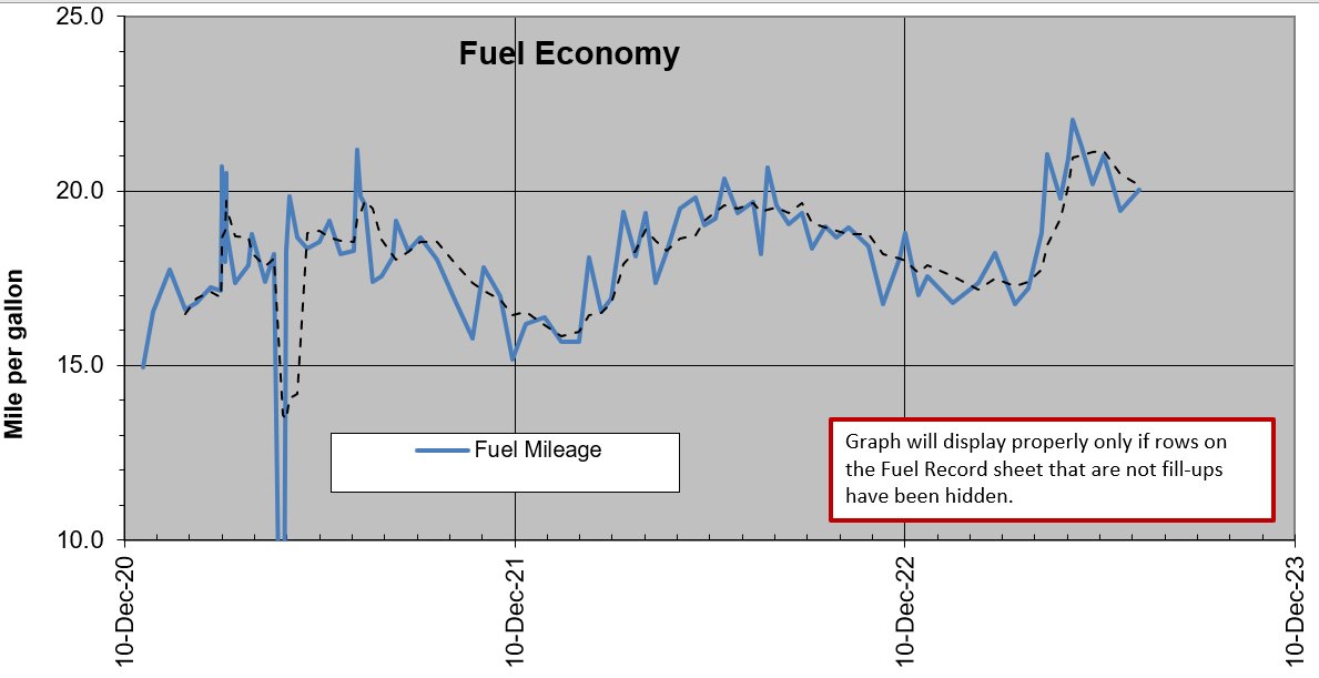

    This is the mileage history for my current '21 TRD OR AC Auto:
    The most recent numbers are from <60 mph on 2-lane state roads (i.e. NOT interstates) and long miles (>40 mile trips).
    My experience with my previous 2nd gen TRD OR was that fuel mileage improve slightly beyond 30K on the odo.
    My '21 seems to be leaning in the same direction.
    Lift, tires & tune are not going to gain you any significant improvement.
    It's all in how you drive and the duration of each individual trip. Frequent short trips will result in crappy mileage. Peak fuel economy doesn't start until the entire drivetrain is warmed up to normal operating temperature.

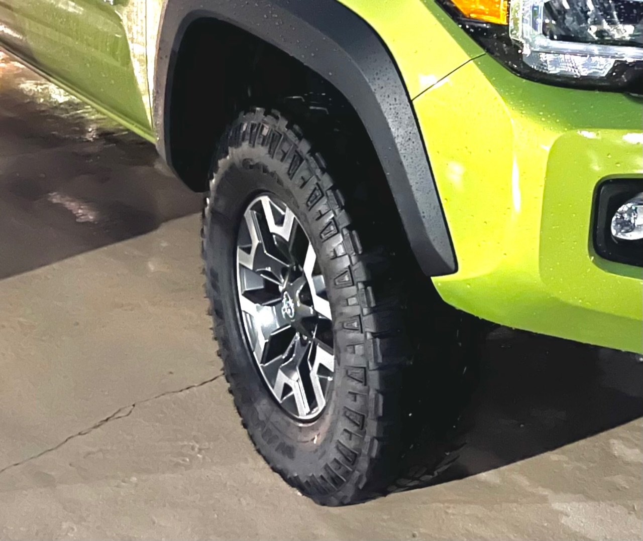

    Well these are a little more aggressive, but still essentially stock.

    Looks like Goodyear Wrangler Duratrac tires. I believe those will be heavier than stock. That'll definitely affect MPG, as will the tread pattern/compound.

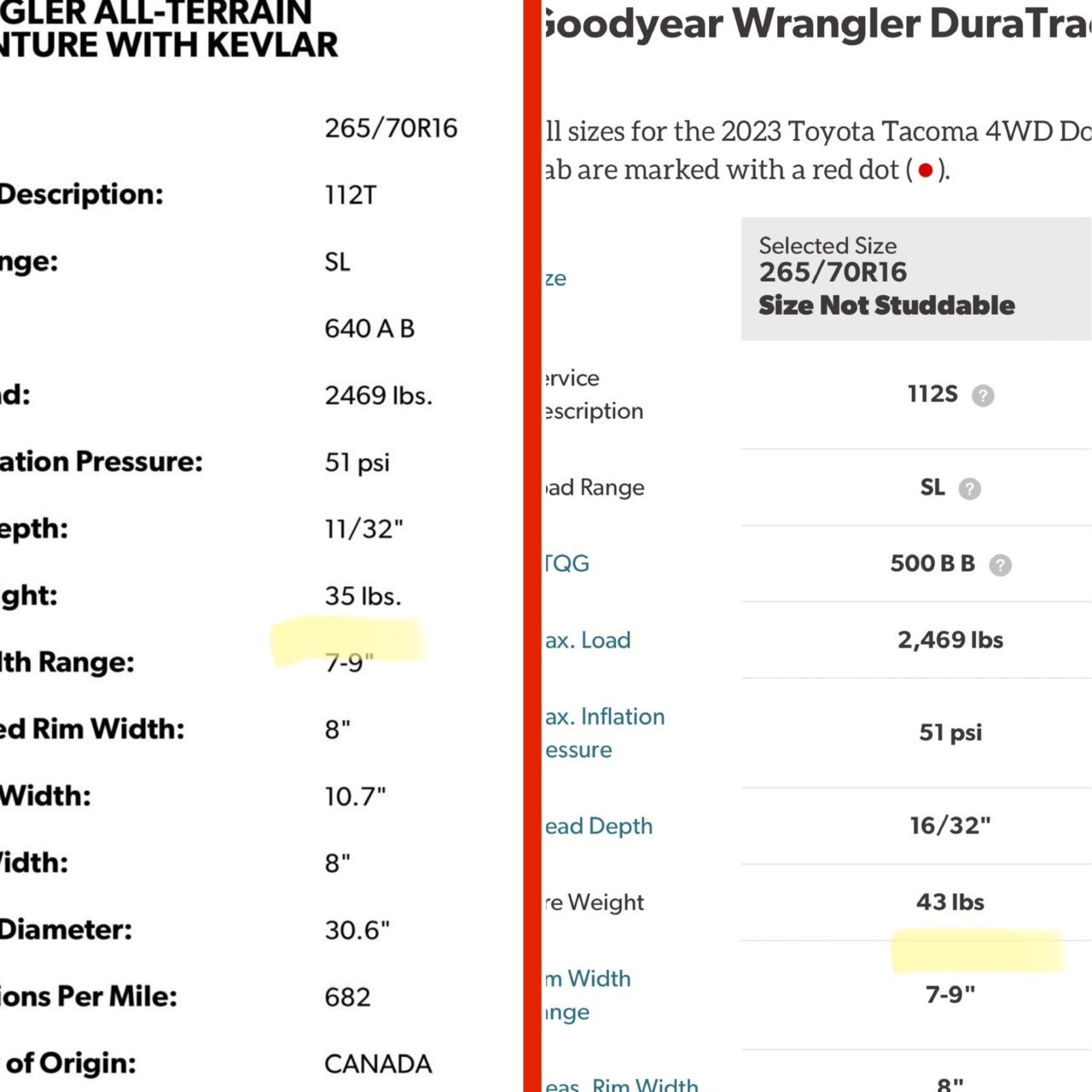

    Yes that’s exactly what they are, good eye! (I know the photo wasn’t the be) Kind of ridiculous they charge over $1k for them as an upgrade, but they do look good. I am thinking the tires might be the cause of the lower mpg… I may just be tempted to throw on a set from my old SR5 to run for a few tanks.
    edit: turns out they are 42 lbs versus 35 lbs… doesn’t sound like much, but it is over a 20% increase:

    You need to know what those tires weigh. Tires are rotating weight, any more weight than the stock tires, you're going to lose hp, and performance which hurts fuel economy.

    That'll certainly make a difference. Somewhere on here I heard someone say every lb of extra rotating mass is equivalent to 20 lbs of payload. No idea where that figure came from, but even if it's just an analogy it makes sense to me.

    Weight of the tires will affect the mpg .

    Two wheels being of equal weight, rolling friction of tires should be considered, as should tire inflation.
