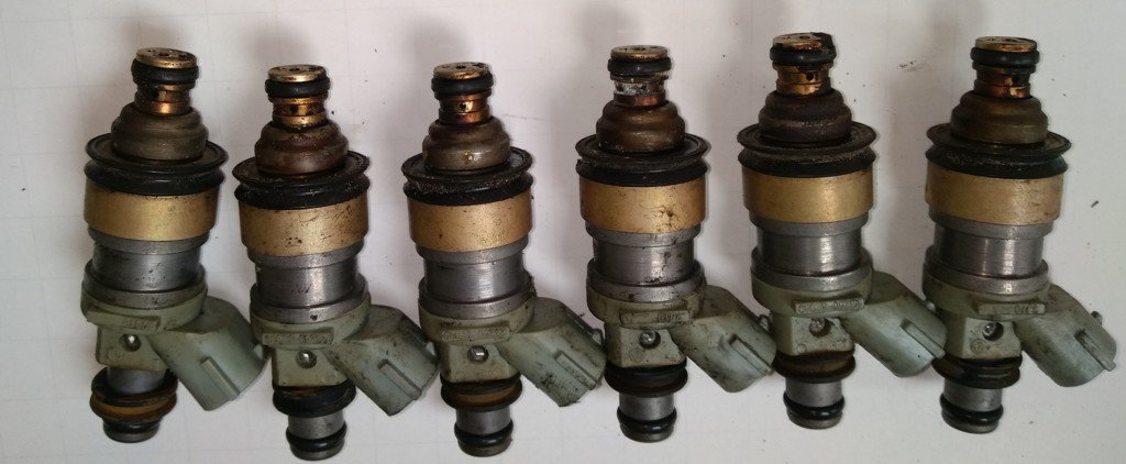

    This afternoon I pulled the injectors out of the replacement engine. I purchased a kit to refurbish injectors for the 1999 model. Based on the kit contents I felt comfortable with the 1999 model style injector.
    When I pulled the 1998 model injectors, here's what I found in the picture below.
    Are the lower intake manifold, injector rail, and other fuel delivery parts different between a 1998 and 1999 model?
    These look like the injectors that you will find on a 21-year-old engine. They need professional servicing.

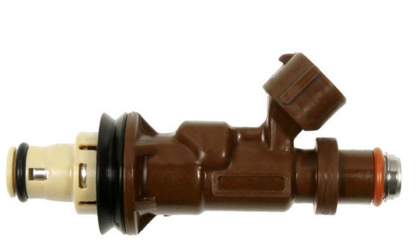

    Here's a picture of a 1999 model injector.

    They made two different injectors for the Tacoma.
    The early style which went up to 1999 I think.
    The latter style 1999- 2004 up is a much better injector and has a larger flow then the early injectors.
    I’m not 100 percent when the newer style was switched to.
    Some of the newer injectors style needed an adapter for the wiring harness and some seem to plug and
    play with a little Manipulation.
    You definitely want the newer injectors if possible

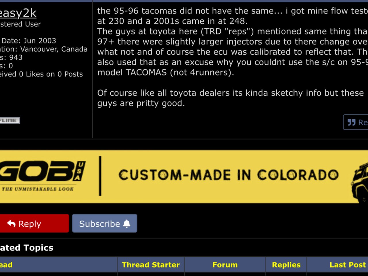

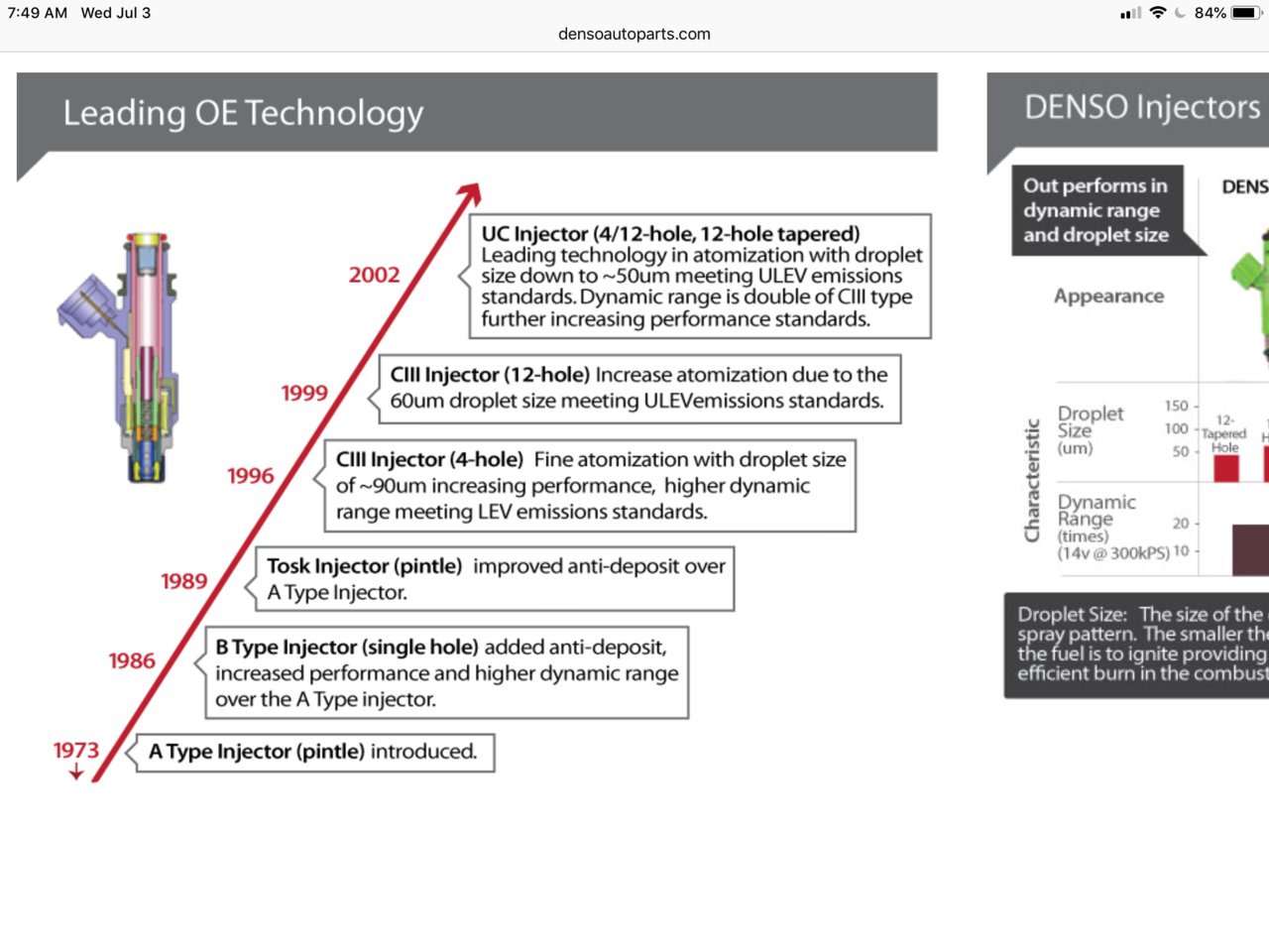

    There is a difference regardless what Gadget says in flow rate on the early 3.4 fuel injectors, it’s not much, I do remember reading the different numbers somewhere from 230 for the 1996-98 or something to 240-250.
    Because it’s a small change probably is referred to as the same but when superchargered it made a little difference.
    This guy actually did a flow rate on the two types and the early style shown 230 flow and the newer style 248.
    I definitely noticed a difference with the supercharger with less pinging with the newer injectors before
    I went to the methonal.
    So they did change the flow rate just a little for some reason and the droplet size is probably better with the newer injectors, better spray pattern.
    DENSO was also making a lot of upgrades right in these years (1996-2002) to their Fuel injectors too
