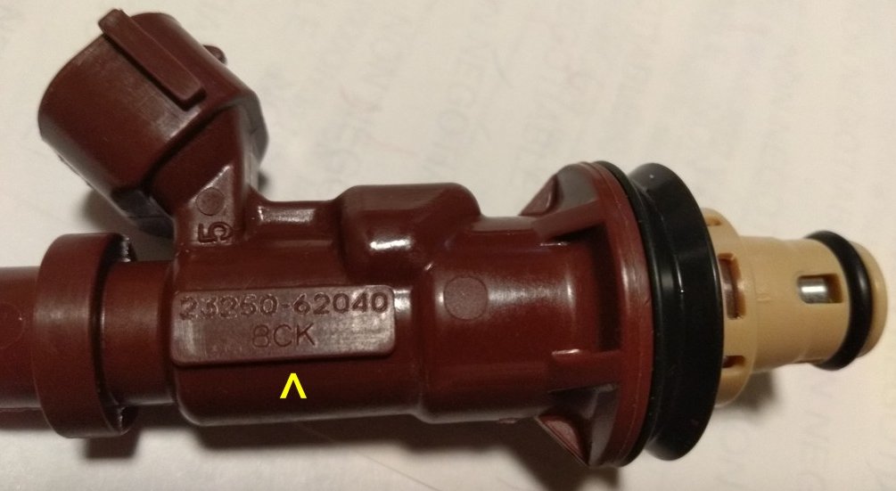

    I'm a lurker here, but a long time toyota truck addict. I've owned multiple 5vz vehicles, some were motor swaps others were OEM. but all had some level of misfire in their lives. the point of this thread is to hopefully help other people who want to fix their injectors and upgrade from aisin to denso. Im a mechanical engineer and my company specializes in modified turbo engines, Denso and bosch are the only injectors we use (but we dont sell or support 5vz so please dont call unless you need a turbocharger)
    ^^this is an OEM 3.4L V6 truck injector, 25lb/hr flow flow rate. Toyota trucks ie Tacoma, tundra v6 and 4runner all got these brown Aisin brand fuel injectors.
    Flow rate: 25 lbs/hr, 264 cc/min at 43.5 psi (3 bar)
    Resistance: 14.4 Ohms
    When youre mileage is somewhere around 220k-250k miles an OEM Aisin injector, or two, is likely to fail. these typically have an internal solenoid failure at or near this point. Note: Solenoid failure is most obvious during a warm start, they tend to behave fine at cold start. They also have a really poor plastic cap design that is junk IMO. You can clean/service or replace with new OEM but the old solenoid windings are still there.
    On the other hand, the Lexus RX300, toyota highlander and a few other vehicles got the identical size 25lb/hr injector from Denso.
    This Denso injector is superior to Aisin, it does not fail. It has a one piece stainless steel injector nozzle. And it is plug and play replacement for 5VZ-Fe. no changes, just swap the injector
    95-97 5vz denso equivalent lexus es300 = 23250-20010
    98-03 5vz denso equivalent lexus rx300 = 23250-20020 or 23250-0A010
    For a cost effective supplier, you can buy (6) Injector-Rehab.com reman denso injectors for $95 here
    Whatever you do Do not buy the cheap ebay injectors for $59, they are fraudulent knockoffs and will fail
    i hope this helps! good luck

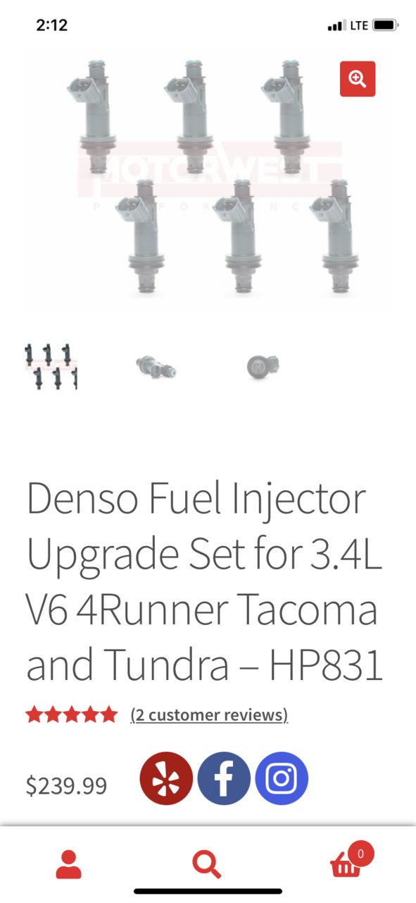

    Have you had any experience with injector-rehab?
    Their price for the set is almost to good to be true, for example motor-west wants 239.00 for what sounds like the same injectors. Same cleaning and testing etc..
    I’m in the market for a set is the reason for my interest.
    thanks

    I'm looking to purchase this set from Motor West, do they come with O-rings on them already?
  18. Dec 14, 2023 at 6:19 AM
    #18
    otis24
    otis24 Hard Shell Taco
    Dec 3, 2012
    #92402
    6,466
    Mark
    California
    OtisBound Outdoors Bodonkadonk
    OtisBound Bodonkadonk
    The injectors I bought from Motor West a few years ago came with o-ring plus extra o-rings in case one gets pinched when you install them.
