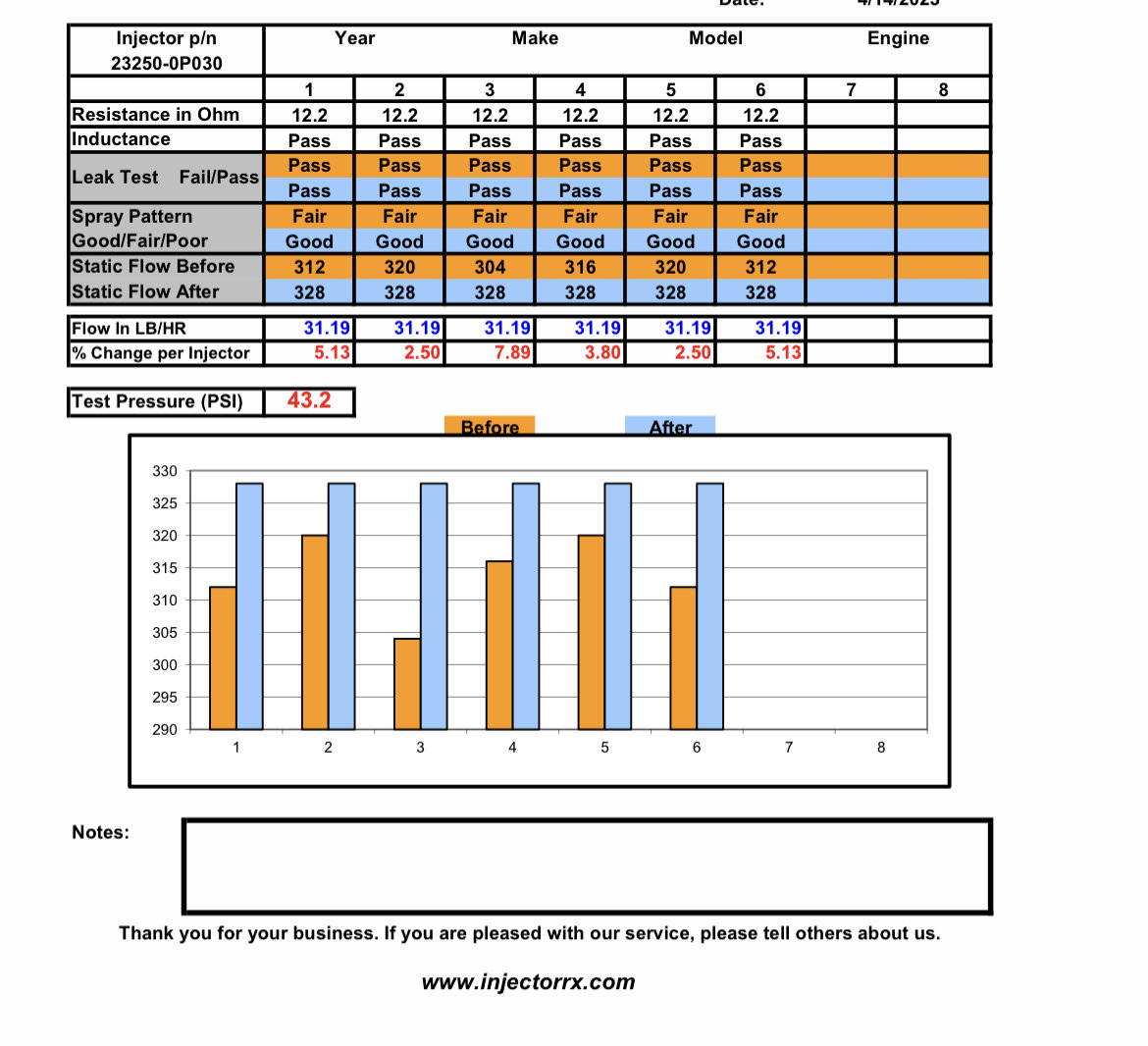

    Had a local shop test and clean the fuel injectors since I’m installing a new engine.
    They give some before and after results which is pretty cool. For $130, it seems like good deal to know they’re all working properly.

    Do you notice a difference while driving? Thanks for posting.

    Would be nice to see an after-test after running a bottle or two of a good reputation fuel additive like Techron.

    I bought the truck with a blown engine. I’m just piecing it back together now.
    Every time I go to reuse an old part I feel guilty putting it on a brand new engine. I’ll end up putting a new fuel pump and pressure regulator on it too.
