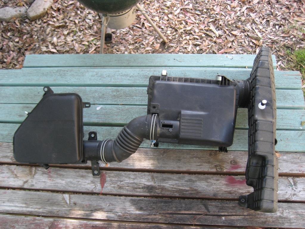

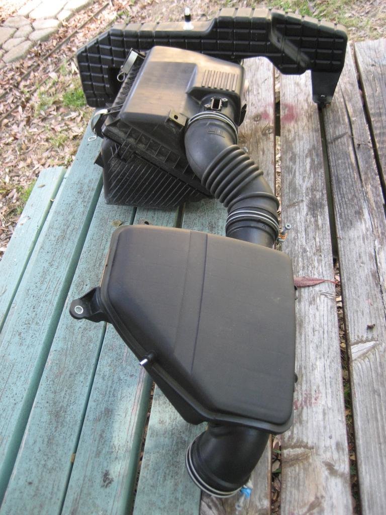

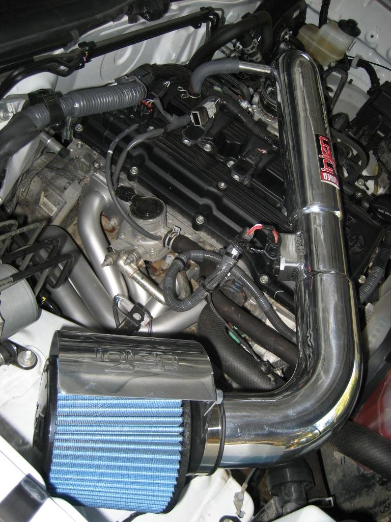

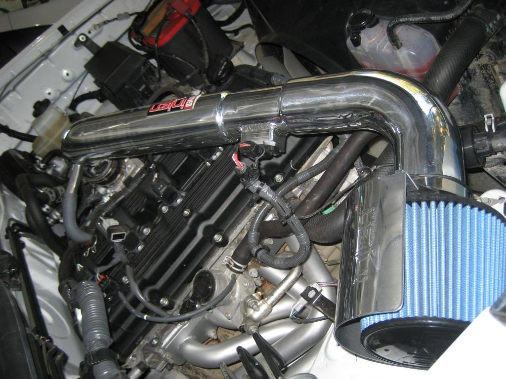

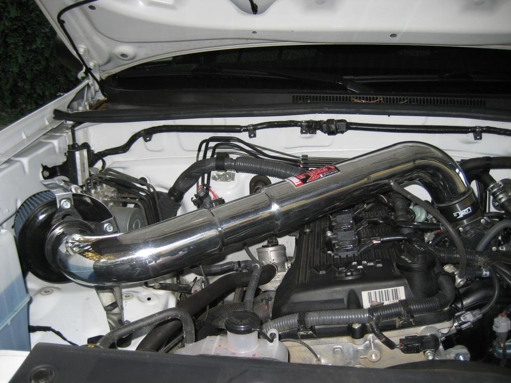

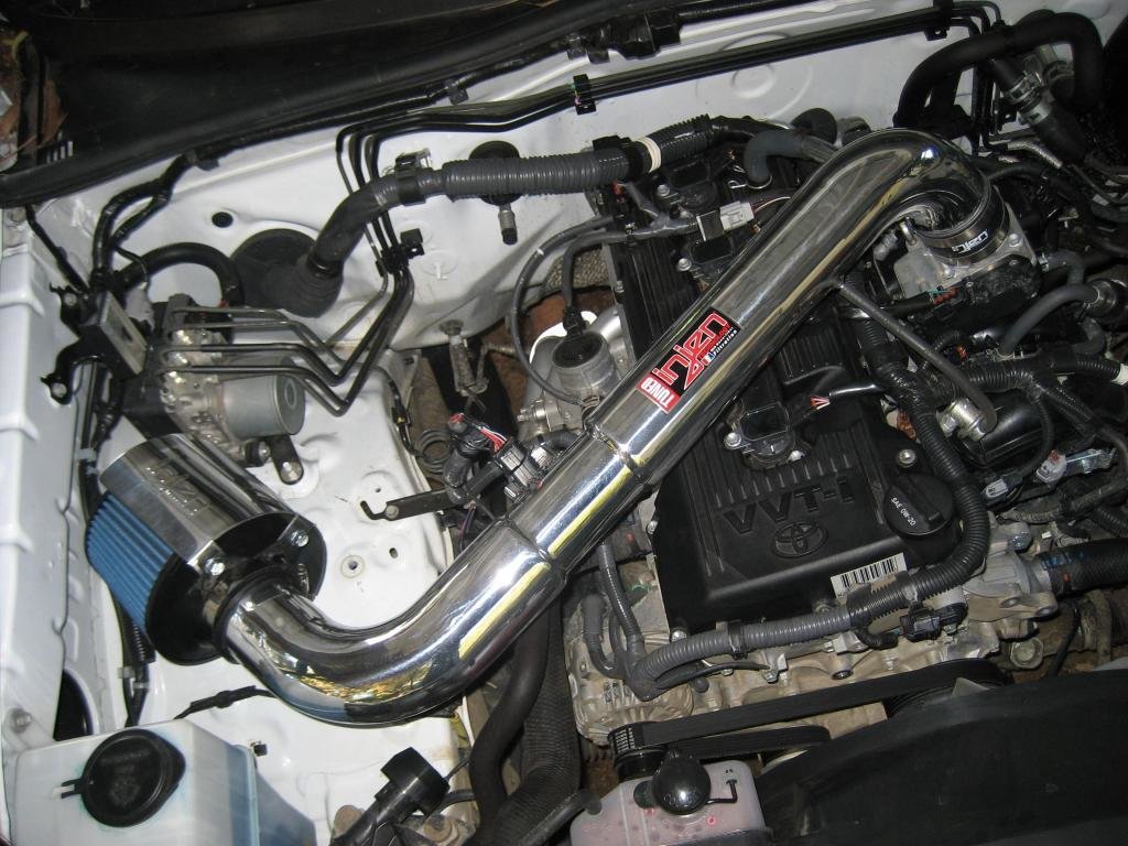

    I was trying to decide whether to put this in the "Performance and Tuning" or the "4 Cylinder" section and figured it was more topical here. This is an Injen intake that fits the 2nd Gen 2TR FE 2.7 4 cylinder engines, that I just installed today on my 2012 Base Model Standard Cab Manual Transmission 5 lug 2 wheel drive Taco.
    At 3 feet,it's a long ass intake! :eek:
    it installed pretty easily even though the mounting bracket needed to be bent to fit the vibration isolation bolt screwed in where the stock air box used to be.
    The air filter is located right next to the hole in the fender well, so I'll be removing the stock plastic resonator to allow more air to blow in when the truck is moving.
    The Injen unclutters the engine bay so that the engine is easier to see.
    So far I've only taken it up and down the road to see if there would be any Check Engine light. No light. :) It's actually very quiet, with just a little ssssss sound in normal driving. I have a stock muffler so it's hardly making any sound either I think the intake is quiet because the filter isn't inside of a box that makes the sound resonate. The tube is also a lot longer than any other intake which may also be quieting it down. I'll do a review after I've driven it long enough to have more to say.

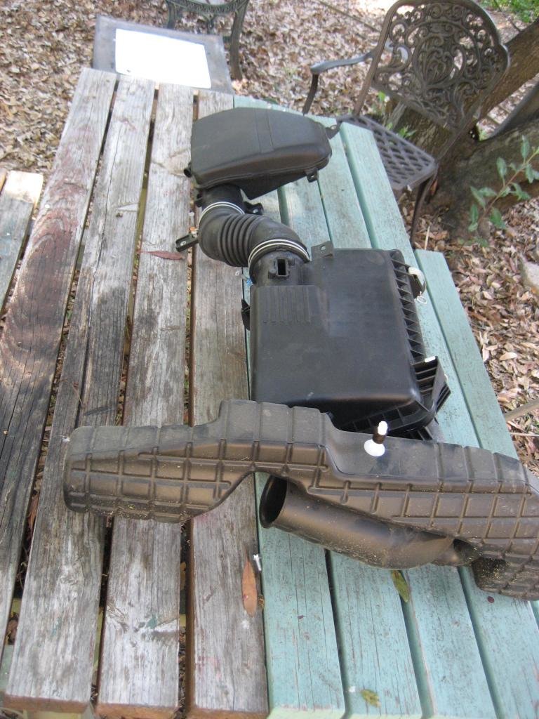

    Took the wheel well apart to remove the last piece of the stock intake. It's actually quite an impressive collection of chambers and baffles...
    All that stuff can't be just to keep the intake quiet, because you can't even tell that the Injen is on the engine except for a very mild low pitched "waaah" sound when you mash the pedal.
    The fender hole next to the filter is now completely open into the wheel well...
    But heck, who knows.... probably more air flows out of it than in! :laugh:
