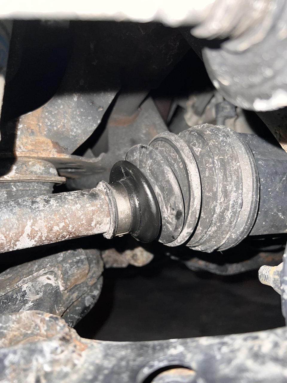

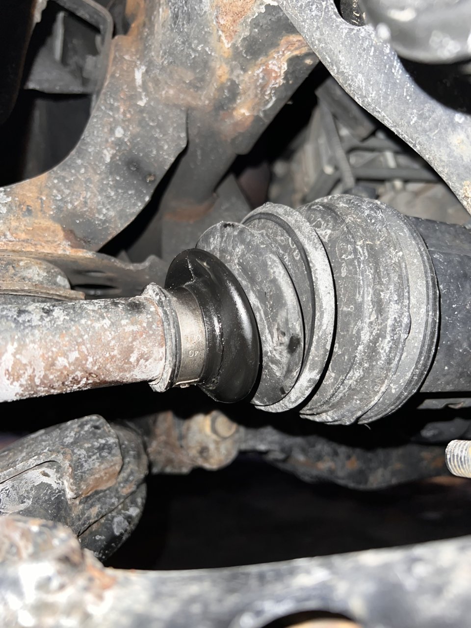

    Just happen to take a look under my truck, noticed it was leaking a little bit and happen to notice a slight tear. Is this something I need to take care of now or could it wait till it gets a bit warmer? Should I upgrade to high angle CV’s?

    High angle not necessary, just get new OEM's and do the boot stretch mod.

    Eehhhh....
    Once a CV starts puking grease (which is going to happen here soon as that's a pretty major tear in the usual spot) they don't last too long.

    not leaking anything at all on the driveway, it’s just damp. I don’t have much of a commute everyday, we’re talking about less than 4km a day.

    Doesn't even look like where the boots are rubbing together.

    That’s what gets me lol! To be honest I don’t know how long it’s been like this.

    Yeah its happening where the clamp is, another common spot for the boots to tear when the angle is too high. Puts more strain on the boot where it's clamped and it starts to pull apart there, have had it happen to mine a couple times.

    Can I get away with it for about 2-3 months, till
    it gets warmer? Really debating if I should get CVJ axles with high angle boots or should I just replace the inner boots with high angle ones?
  10. Jan 20, 2022 at 3:54 PM
    eon_blue
    Mar 4, 2016
    #180213
    69,391
    Azusa, CA
    People drive around with blown CV boots forever without realizing it or not wanting to address it. It does put the axle at greater risk for failure though, once water/dirt/debris start getting inside the boot its just a matter of time

    I wouldn't bother with the CJV's heard to many mixed things with them.
    OEM CV's with the boot stretch is plenty good enough.
    It might be fine for you for 2-3 months with your commute so short but I would avoid any dirt dusty or muddy driving, if you don't replace now it might be get foreign grit into it or loose too much grease and be too worn to rebuild in that time but if you're just planning to replace and return those as cores then doesn't really matter to you.
