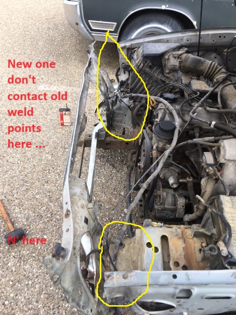

    I am a novice to DIY bodywork but have a decent facility to work at with tools for loan. I am replacing damaged radiator support with a new aftermarket from Summit Racing. The problem I'm having is the apron (where it was welded to the old radiator support) has about a one inch gap in most places where it's not lining up/ reaching to the replacement radiator support. I have made sure the frame is straight, and nearly pinched out and banged out the creases and dents in the apron to where it should reach all the spots the old one is welded. I measured the new part vs the old and it seems like critical dimensions are good. I cannot see where or how the apron is bent that it's not reaching to where I can weld it.
    So it's an open-ended question of 1) needing advice on what techniques work best to stretch the sheet metal of the apron forward to where I can weld it to the new rad support?, or 2) is it acceptable and safe to just use vice grips to hold everything together at the front corners and weld there if it'll reach, and not bother with the points where it was spot welded at the middle-front of the apron? Then the bumper bolts should provide lower support.

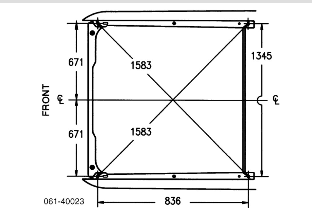

    i would measure as best as you can
    suppose to use 'tram gauge' (expensive) but you can use tape measure
    these are specific measurements from a 2000 Tacoma
