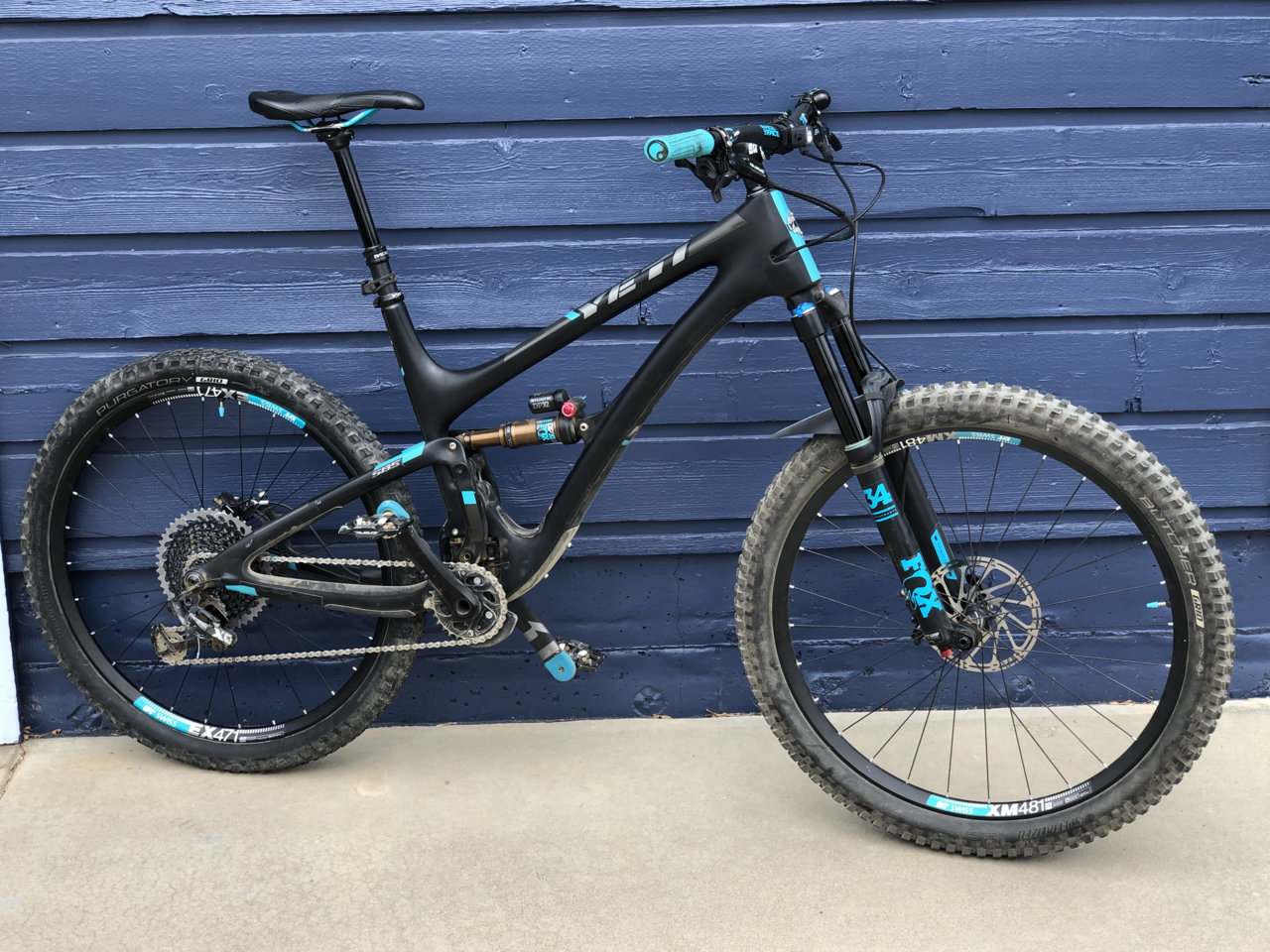

    Sorry for the late post... but here's some more bike prn. It's had a bit of a face lift!

    :drool:

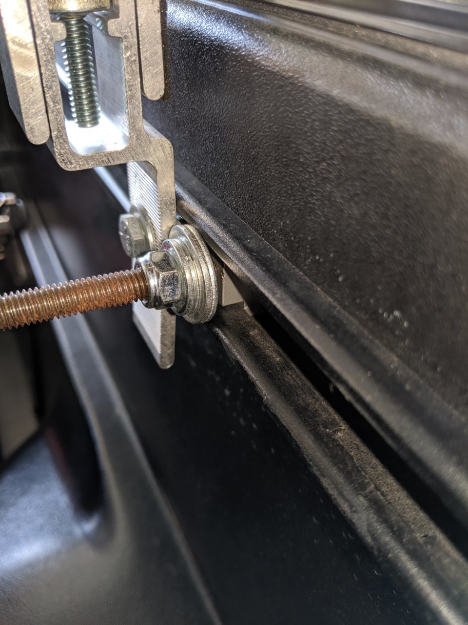

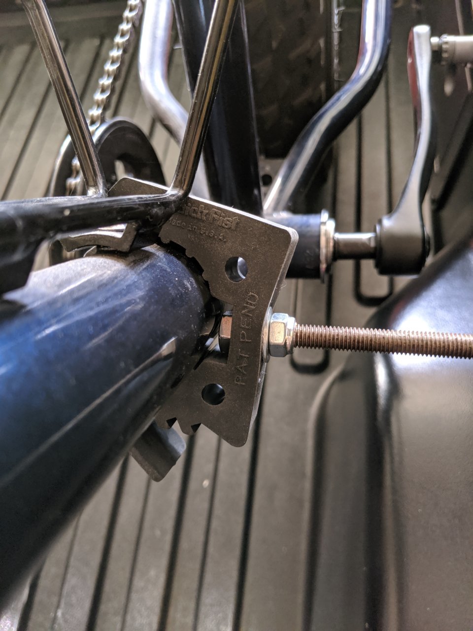

    I made my own version of this with Hondo accessory rail nuts, some threaded rod, and a QuickFist.

    Can we get a few close-ups of the attachment pieces? The attachment at the rail and attachment at the bike frame?

    Will do! Gimme a few hours.
    Basically, Hondo accessory rail t nut, thread lock, four stacked washers and a nulock nut, about 8.5in of M8x1.25 allthread, another nylock and washer at the QuickFist, and a plain nut on the bike side.
    I wanted plated allthread, but selection was very limited.
    I wish they would thicken QuickFists so that nylocks would fit.

    Here you go:
