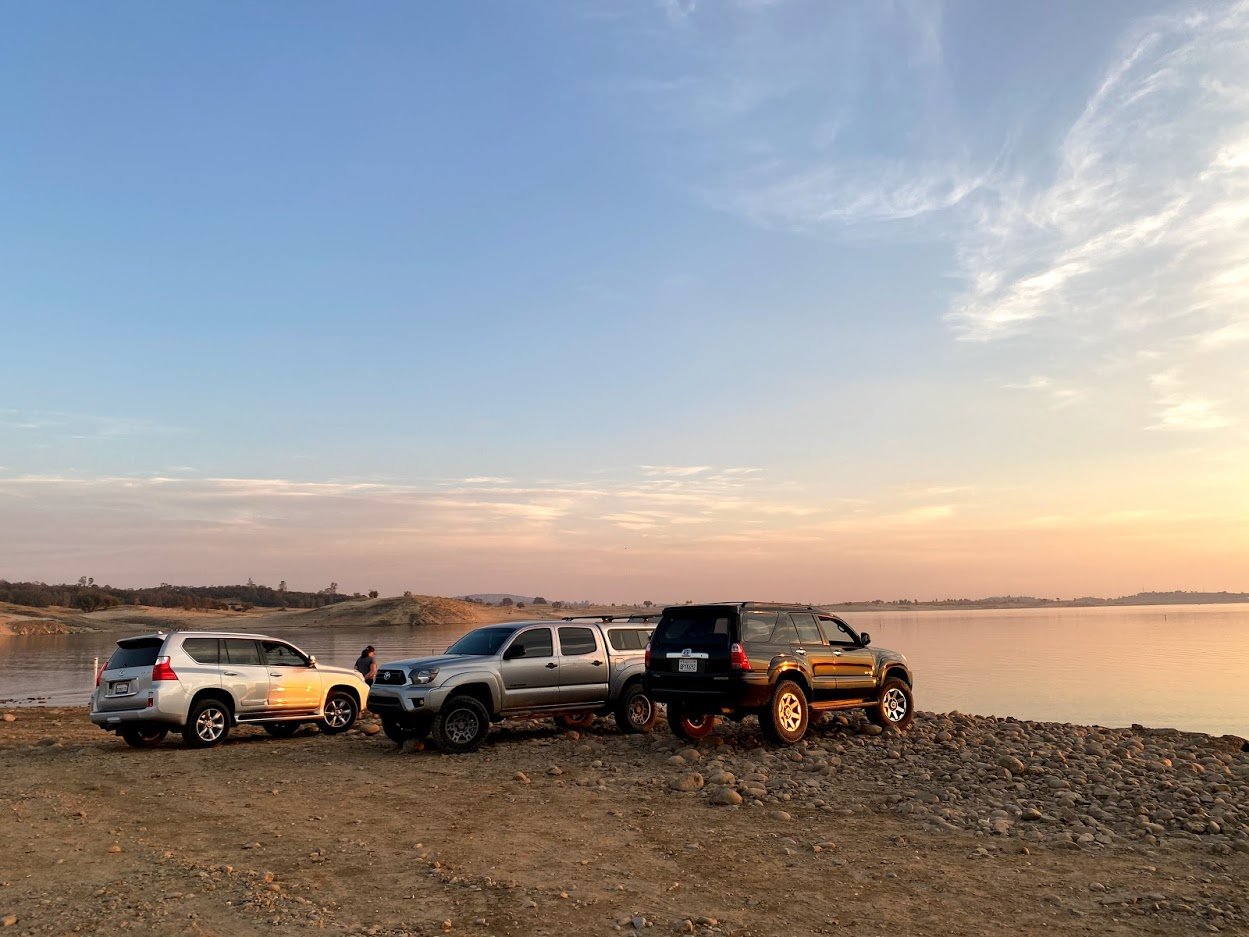

    (Picture of my 4runner and taco for fun. GX460 is what i made my sister buy instead of a RX450 that she wanted)
