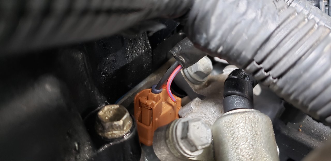

    As you can see in the picture, I pulled the wire out of the injector plug/connector. I went to the dealer and we couldn't find a match for the connector, only for the whole harness. I called a couple of wrecking yards and they would only sell the whole harness as well. I was hoping to find a pig tail type of deal that I could just solder on and go, but no luck so far. Id appreciate any input. Truck is an 08 2TRFE20200123_152541.jpg

    Look on the face of the plug. Take your camera and zoom in. There's a number on it more than likely. With that, you should be able to get a repair wire for it.

    Or de pin and re pin the connector.

    The connector housing for the V6 injectors is 90980-11875. I am 95% sure that the 4 cylinder uses the same connector. I'm also 95% sure the V6 connector is grey and the 4 cylinder is brown. I don't know what color that replacement housing is. I am 100% sure that the part number of the pigtail for that part number connector housing is 82998-12790. However, that pigtail is between $16 and $27, depending on where you buy it. Here's a much cheaper source for the 90980-11875 connector, however, you need to confirm with them that it comes with the pigtails. It says pigtail in the description but they're not shown in the pic.
    https://www.bmotorsports.com/shop/product_info.php/products_id/2074
    There are also a few ebay sellers that sell that connector with pigtails. Here's one.
    https://www.ebay.com/itm/Scion-Fuel...r-Repair-End-90980-11875/133032479806?vxp=mtr

    Thanks guys, that's what I was looking for.
