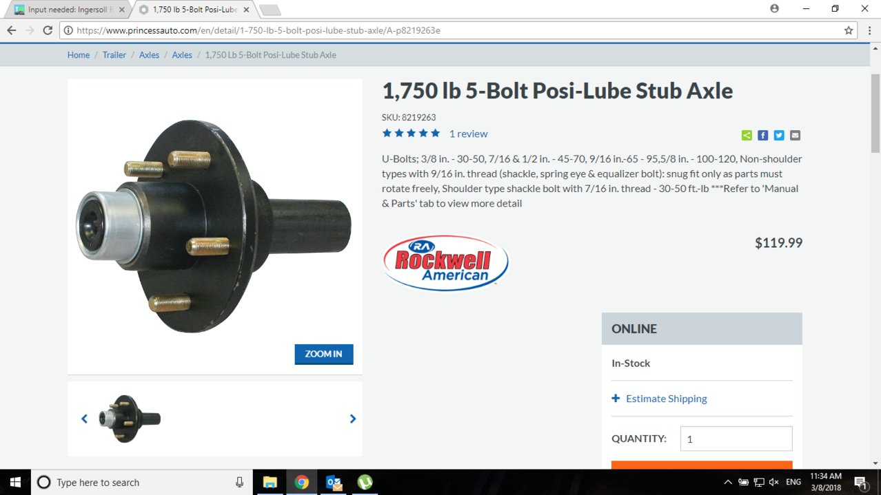

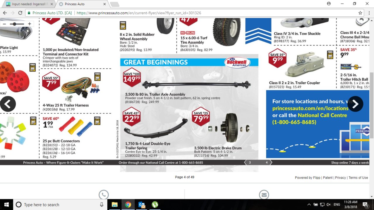

    Axle parts on sale at princess auto :)
    just remember you will have to cut and modify most any axle you put in this trailer.
    you might be better off just buying the stub axle and making your own
    Edit it would be cheaper to buy this one that is on sale and section it in the center and slide a tight fitting oversize pipe and weld it to the required width.

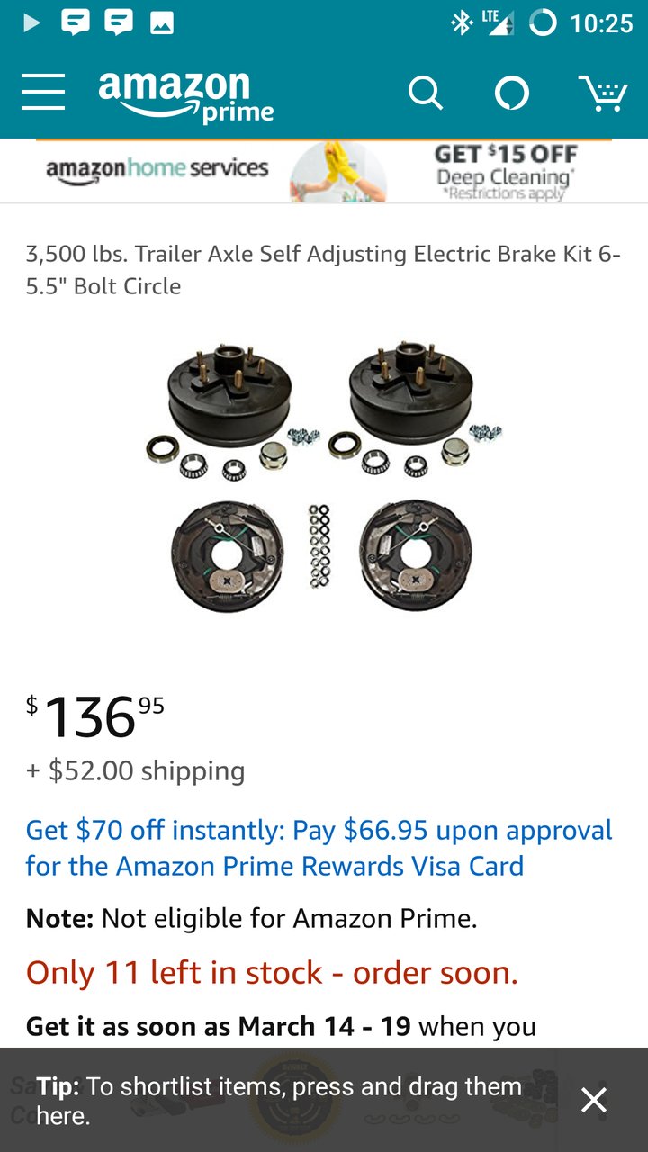

    I'm looking at these + new axle and my stock Tacoma springs
    I want to be able to swap out tires between the truck and trailer.

    Nice find! I have a little trailer that I could swap the hubs out....didnt even think to use Amazon for that.
    only thing I would worry about is the centerbore..I dont think it would be an issue as our trucks have a huge centerbore on the rims, and im sure the centerbore on that is smaller to accommodate chevy's.

    Like I say though I don't think it would be an issue since these are probably smaller to accommodate smaller center bore's of other sized wheels. You may need cone style nuts to centre the wheels on the studs...

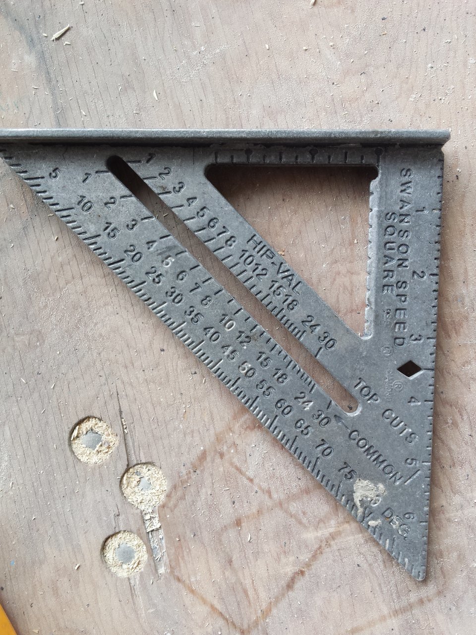

    Please scratch that speed square.... It's way too new. IMG_20180308_121020.jpg
    tacoma16[QUOTED] likes this.

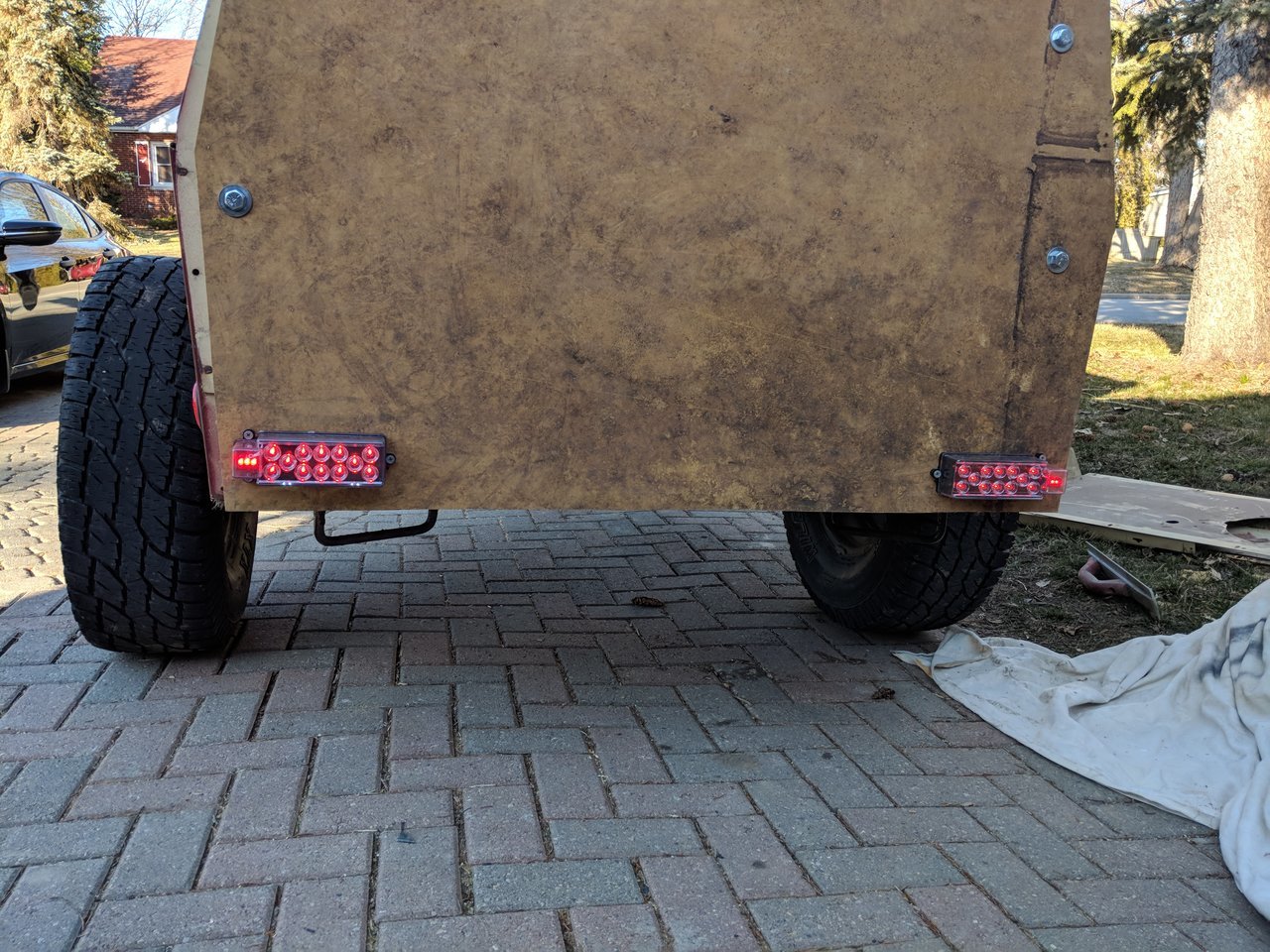

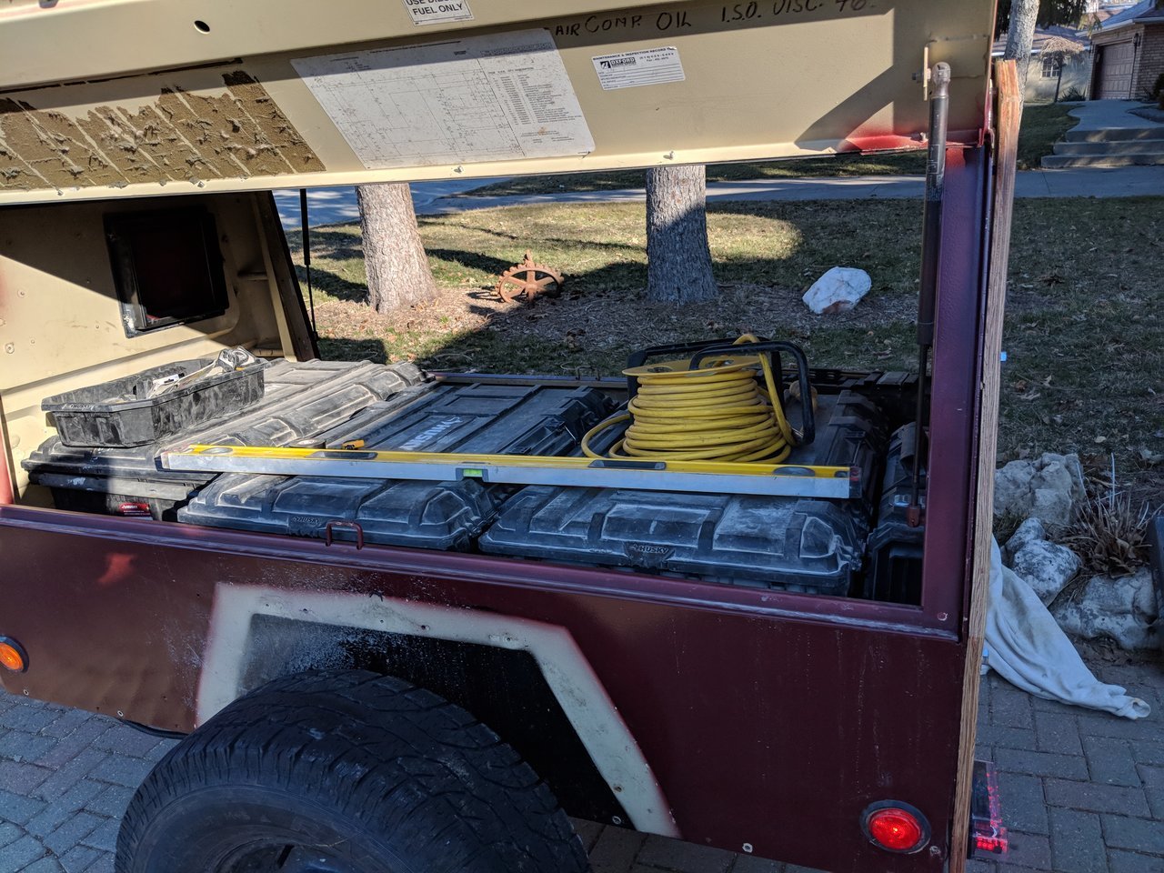

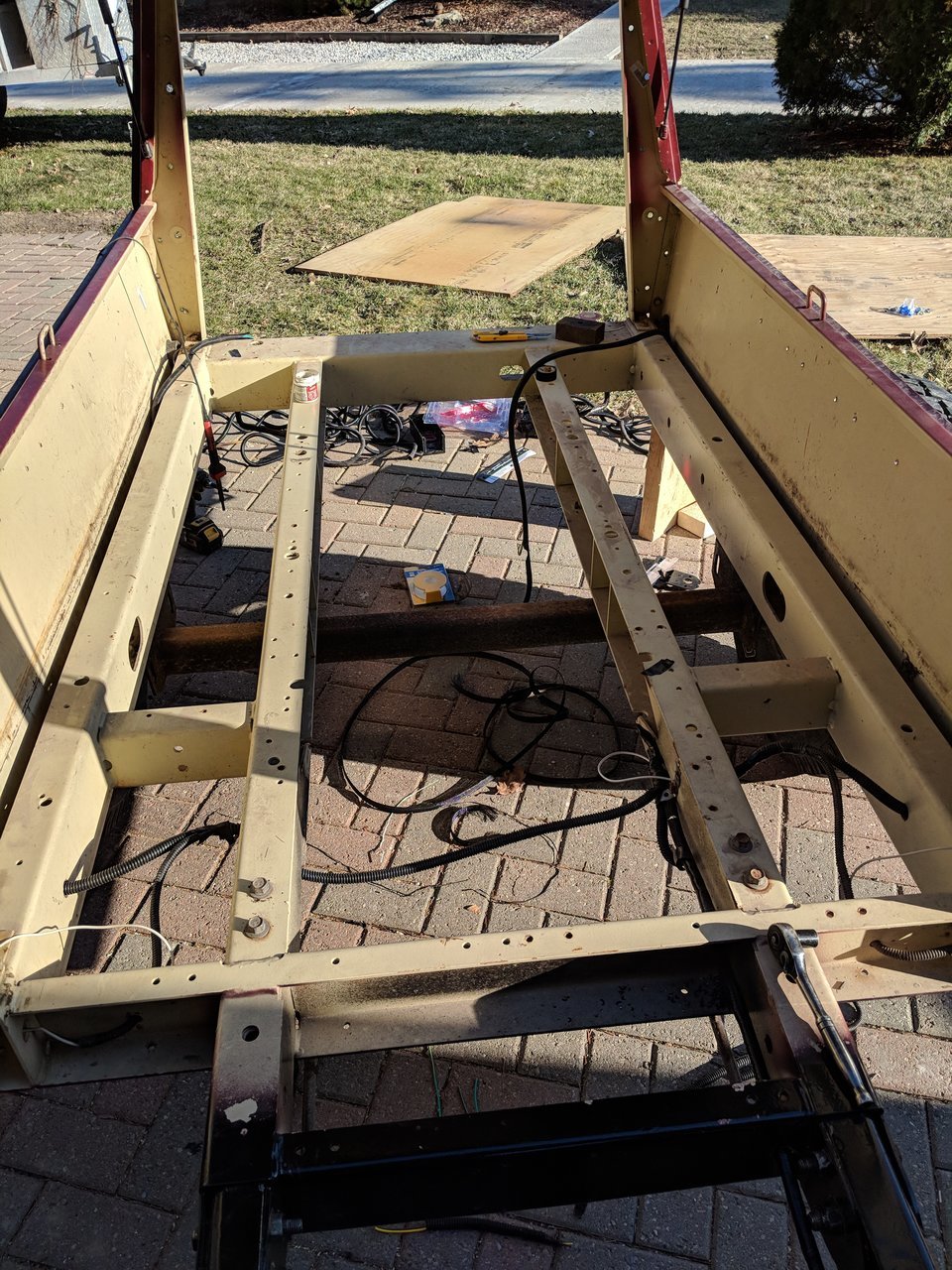

    Updates....
    7 pin wiring done with all new wire.
    I realized I need a tool trailer more than an off road trailer, so I put it back together with just a plywood back for now. Bought some trailer lights from princess auto and removed all the casing to bring them down to 2/3 the original size. IMG_20180323_092317.jpg
    Loaded the tools and everything fit fucking perfectly. Easy access on both sides.
    She's a little bumpy so I think the suspension is shot. If and when I replace I'll be going with these
    http://timbren.com/products-page/asr3500hds02/
    It's a little difficult to maneuver in reverse but I'm sure I'll get used to it. I decided not to do a drop down gate on the rear. Instead I'll be doing a tire carrier mount.
