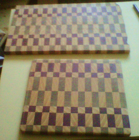

    End grain cutting boards, B walnut, birch, purple heart. Used Mineral oil and butchers block wax. Use A LOT of mineral oil. I put so much in that i stand it on its edge and its seaps down through the wood. Id reapply yearly or when a dull spot comes up.
    DONT cut any berries or food with lots of color. Mom ruined a all birch cutting board by cutting strawberries on it.

    Wow.... those are nice looking! I keep applying mineral oil daily for almost 2 weeks before I mounted them. The guy at the hardware store told me the same thing, just keep applying til it won't soak in any more.
    Thanks for the tip on the berries! I've never had counters like these before so it's all a learning experience.
