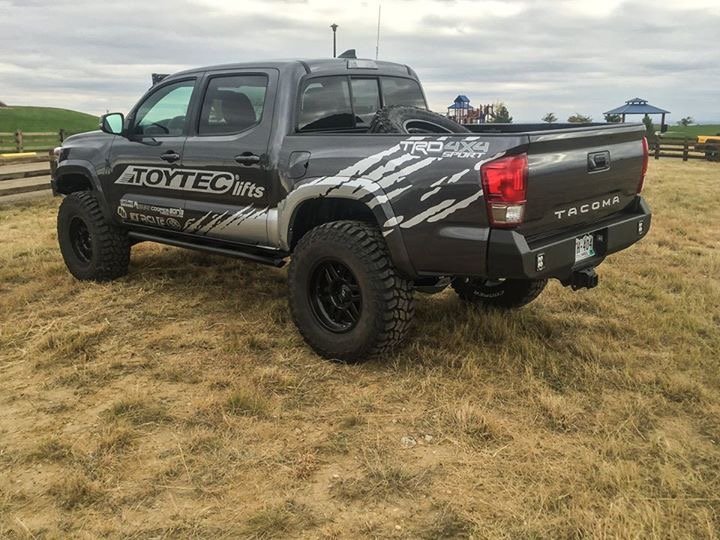

    I would strongly disagree. Insain actually does some bad ass fabrication. Have you not seen the last couple years of Toytec SEMA vehicles? This rear bumper does not define the quality of their work or what they represent.
    My opinion is because the bumper is tan instead of the traditional black it shows the gap that is present between the tailgate and bumper much more prevalent. Look at your stock 2016 tailgate and bumper and you'll notice the same gap. Is this because of how the bumper folds down and needs room to angle? I agree there could have been a backplate folded up and painted the same tan color to mesh better with the tailgate, but maybe that's what the owner wanted when they talked through the project. Only Insain could answer these questions.
    I jumped on the bandwagon and talked trash on the bumper also, but in no way does that give us no namers the right to come on here and trash this very reputable company on TW. I'd really like to hear more background on the reason for the design.
    Just as an FYI, here's another back bumper Insain did for the 2016. I'd buy this all day:

    I agree. Now that bumper, paired up with the front bumper on the Quicksand, would work very nicely.

    I like this rear bumper.

    The tailgate on a 2016 Tacoma is bowed out further in the center then on the edges. So when the tailgate is down it sits about 3/16 of a inch above the bumper. If the bumper was any higher then this the tailgate would hit the bumper and damage the paint. The reason we did not put a back plate on the bumper going up to cover this gap is the back plate would have to be made out of 22 gauge metal as when the tailgate is down it comes extremely close to the bed of the truck. The gap that remains is less then 1/4". With this thin of material it would not be sturdy enough to ensure that the tail gate would not hit that back plate causing damage to the paint. The color match of the bumper does help emphasize the gap as the black does stand out more then with our standard black bumper. As was mentioned the Toytec Rear bumper is a slightly different design but the gap is the same on both of them but it appears completely different due to the color. We are also working on a tire swing that will help hide this gap.

    That front bumper is awesome! I like the toytec rear bumper a lot. These are on my short list for my build.

    That rear bumper looks great, makes me wonder why they didn't advertise this one more than the other.

    I take it you are talking about the Toytec rear bumper. The reason for this is that bumper is made out of Aluminum vs Steel. It does not have a built in receiver like our production version and is a slightly different shape along with the license plate mount recess area. We are trying to stay honest with the version that you would receive if you order one.
