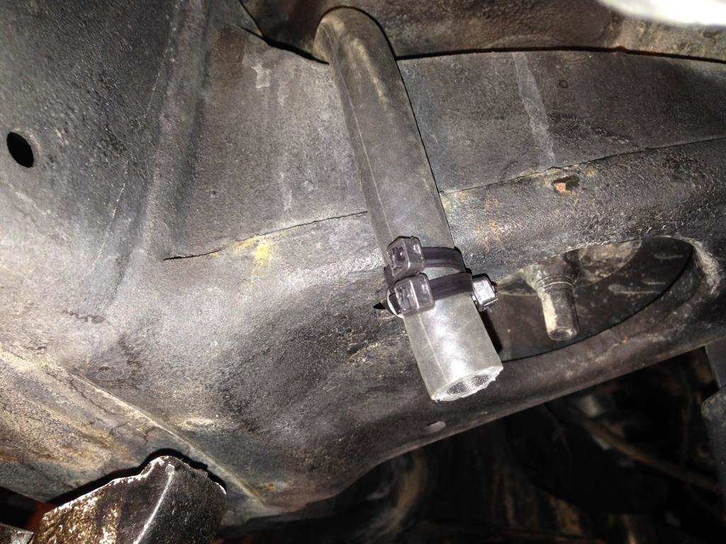

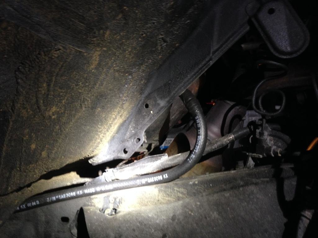

    Re-route your AC line. I have just the smallest amount of rust on my frame right there with heavy applications of Fluid Film. I only recently relocated my AC line. That's where the water will come out if it drips on your frame so that's what is causing some of that.

    thanks! I rerouted my AC drain yesterday.;). Hopefully I can sleep better from now one.
