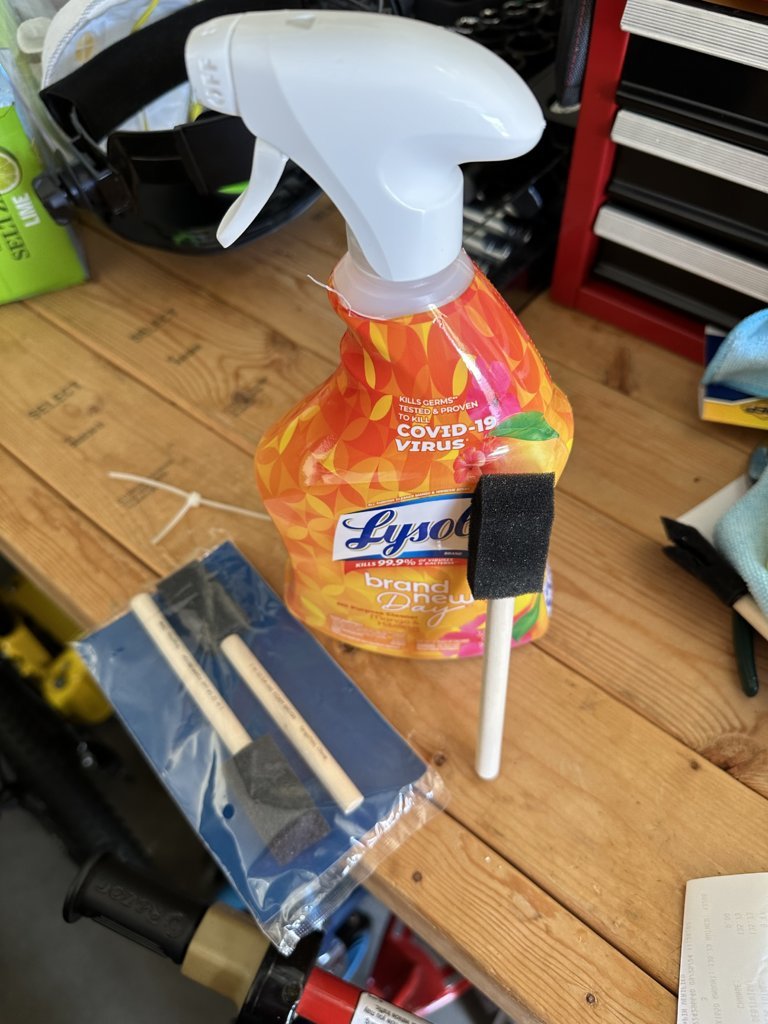

    Most likely. I think I’m going to try to get one of those skinny foam paint brushes and soak it in Lysol and to try and clean all the felt on one window to test it out.

    My theory is it’s been raining a shit ton in FL this past month, and I park in a garage. It’s possible the seals just held water and didn’t dry leading to mildew. I do my best to blow the water off the truck before I park. And drive it the next day after it rains so it can dry off, but maybe those attempts may have been futile. Never had this happen in another vehicle though.
    None the less, i got some foam brushes and Lysol and worked it in the seam. It SEEMS better, but the Lysol scent may be masking. I’ll know for sure in a few days after that wears off.
