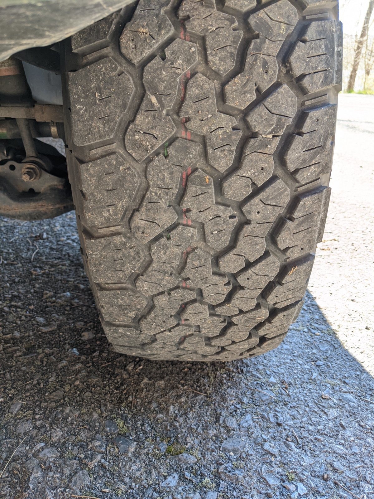

    Pic attached, the inner shoulders on my front tires have worn down quite a bit and I haven't really been keeping an eye on them. I put these on about a year and a half ago, the truck is a 2021 DCSB SR5, tires are General Grabber ATX 265/75/R16. Everything else is stock, Does failure to rotate really look this bad, or is this toe needing alignment? I read in older gen forums that negative camber issues don't generally look like this. Truck has ~60k mi and I put these tires on ~10k ago.

    I vote bad alignment.

    Mine looked like this after changing my suspension and immediately driving to Colorado to visit family, I would start with an alignment, and probably rebalancing afterwards too.

    I agree…..

    Alex the answer is “Alignment”

    Can see a lot of negative camber in that photo.

    Tacoma should have positive camber, but a lot of shops run zero camber for some stupid reason.
    Definitely get it aligned soon.

    rotated tires changed oil threw out the old air freshener.
    Put those on the back pronto!

    That's what negative camber will do. Better rotate and get them aligned asap, or you will have to retire those tires very soon.
    If you hear lots of road noise from those tires, that is a bad sign.
