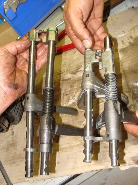

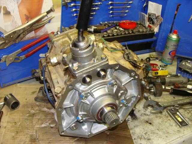

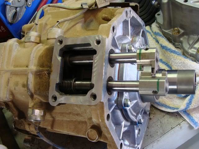

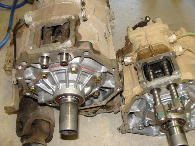

    Those will not work unless they are top shift case's. Most of those case's are forward shift case's that shift from the back of the transmission like this '07 case that we converted while in Australia. What is needed here are top shift case's found in FJ Cruisers.
    Here is the build thread for this truck, an '07 Hilux from Australia.
    http://www.rocksolidtoys.com/forum/showthread.php?t=38
    We had to go to a junk yard to find a top shift case that we could pull the shift rod out of. The only ones the w could find were right hand drop case's not the left hand drop we needed. so we bought one and took it apart along with the '07 case and made the only top shift left hand drop '07 T case in a Hilux at the time. We pulled this case from a Prado.
    At the time, the only left hand drop '07+ top shift t case for an automatic Hilux.
    Also, the other thing we found while doing these crawler installs in Australia is that while the bolt pattern for the t case is the same going to the back of the transmission, these diesel trucks usded the old A340F 4 speed auto transmissions and not the A750F 5 speed auto tranny that we use over here. Will that make a difference? No, not if that case has been converted from a forward sift to a top shifting t case.
