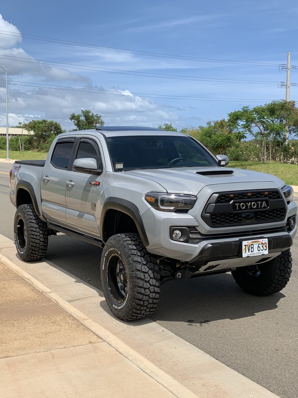

    I have a 6" lift and have zero issues! Does it say that the SS is turned off? Is your Pro grill an aftermarket grill?

    I agree, @toku58 nice truck.
    Bracket lift looks great, to me, more clearance under the frame, perfect angles on the front axles, probably rides like stock.
