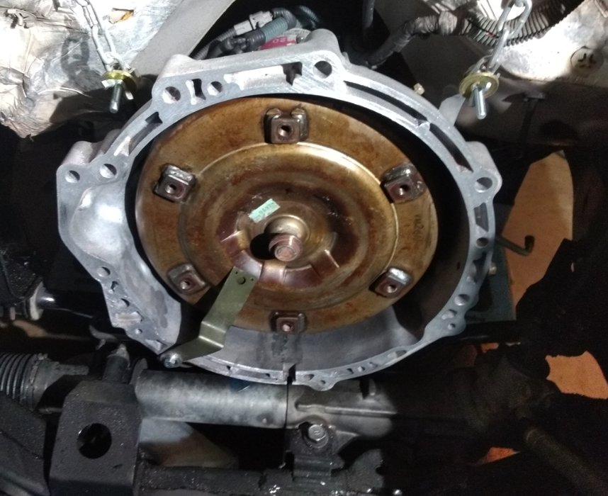

    I used a slim piece of metal hold the torque converter in place while I installed the engine. Once I had the engine lined up during installation, I pulled out the piece of metal. It would have been better if the piece of metal was completely flat, but it did the job.
    You should be able to rotate the torque converter after you install the engine to make sure its not in a bind against the flex plate before installing the black bolt.
