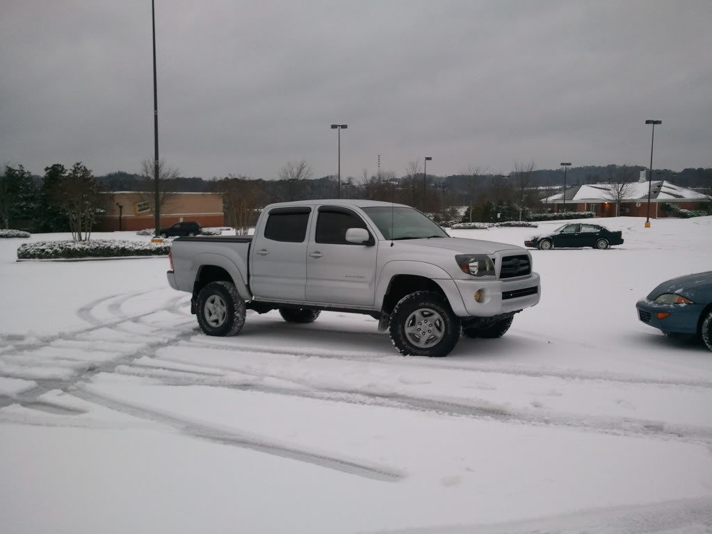

    Nope I'm just running the 5100's at 2.5 on stock coils. I didn't even bother to measure the amount of lift. I have the 2" AAL on non tsb springs. It lifted it a lot in the back but it seems to be settling a little since I installed it. If you can get the dealer to go for it, go with TSB and the AAL. Having an extra leaf spring won't hurt. I wish I had the TSB since during the summer I'm hauling my landscaping equipment around a few days a week.
    Here is a pic

    Excellent advice from everyone, thanks. Mac, your truck looks great with the 1st gen wheels. I have an extra set of those, may have to toss them on my 2nd Gen taco sometime. What size tire you have on those 16's? I'll called Toytec and they recommended the 1.5" TSB AAL, like RLD mentioned. I thought you had to have the TSB for those but apparently works with or without TSB. Did you do the drops on the diff or carrier or change uca's? thanks again

    Thanks, I'm running 265/75/16 duratracs right now. As soon as these tires are done I will be upgrading to 285's. I'm trying to find a set of Tundra/Sequoia 17's to replace the 1st gen wheels.
    Yep I have the diff drop and CB drop. Stock UCA's. Cherokee County Toyota got my alignment dialed in pretty good with the stock UCA's. (.8 camber both sides, .05 toe both sides, and 1.9 caster on both sides). I plan on buying some UCA's in the future though.
    I need to get some axle shims, I have a takeoff shudder and some vibes between 55-60mph.
