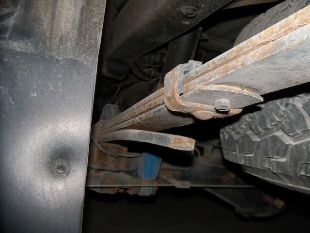

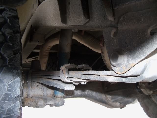

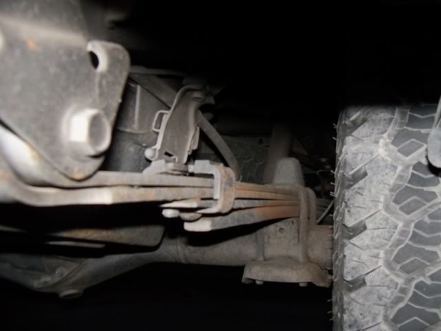

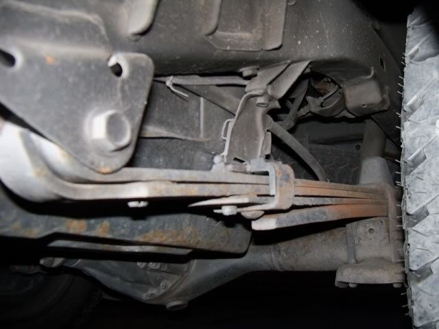

    I am looking to upgrade my suspension, but I was not sure if I would be wasting my money with an AAL. Based on my pics, are my current leaf springs suitable for an AAL or do you think I should replace the entire pack?
    Left side
    Right side

    how many miles do you have on your truck?

    id say new leaf pack...they're bowed pretty far

    Just over 78,000

    ok well it depends on your budget. the 3rd pic looks like theyre sagging a good bit so if you have the means to get a new leaf pact i would go for it

    yea i would say new leaf pack

    new leafs

    Get the leafs man :) yours do truely look sad... :(
