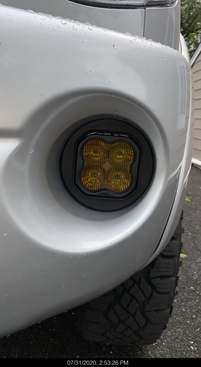

    If you want to upgrade I recommend diode dynamics SS3 fog lights. Reasonably priced for a good legal fog lights 56C1608D-16ED-491D-9779-CA257A2A11F1.jpg

    How did you get ur lights to mount like that?

    Its a kit from diode dynamics. You get everything you need plug and play
