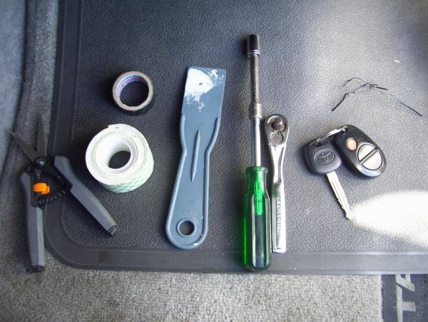

    Well, let's get started. First off, lemme advise on some tools/stuffs to have handy:
    • 10mm Socket w/6+in. Extension and whatever preferred ratchet
    • Plastic/Rubber Putty Blade
    • 2-sided tape and/or electrical tape
    • Scissors
    • Twisty Ties
    • Truck Key :D
    Also, of course, make sure you have all the GROM adapter equipment:

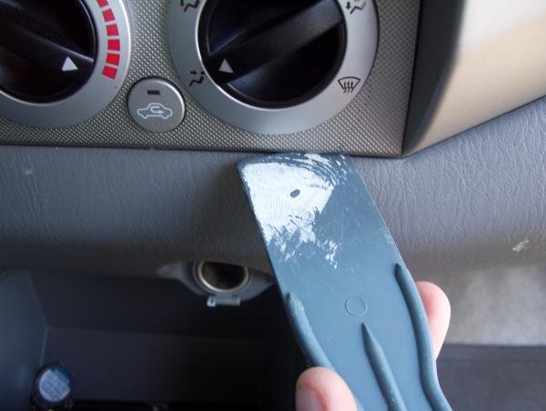

    1. Remove the A/C Controls panel

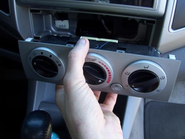

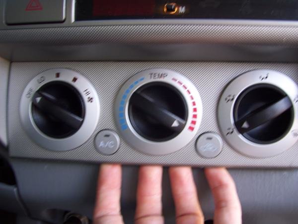

    Get your plastic/rubber blade ready. Any plastic/rubber prying item will do really. Just be easy and try not to scrape the plastics. Taking this panel off is a snap. Just:
    pry under/into one of the corners of the panel,
    and push down on the blade. You'll feel and hear a dull pop as the bottom of the panel pops loose. Once you have the bottom loose:
    Get your fingers underneath the bottom. Gently lift up/out aaaand:
    Presto. You'll feel and hear another pair of dull pops as the unit comes right out. That's all there is to that panel. Option: Have a rag/cloth/tape handy and prop the panel out of the way, anywhere. Be mindful, corners can scrape dash plastics.

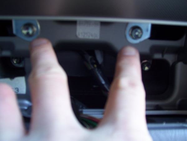

    Get your 10mm. setup ready. You're gonna unscrew 4 bolts located here:
    and here:
    Just unscrew them, remove them from the holes (the bottom two might take a bit of working to get loose, but they will come out), and stow them nearby.

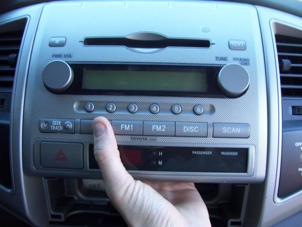

    Get a hand under the bottom-center of the unit itself and
    just like the A/C panel, pull gently up and out. The entire unit till pop out (pops around the top), easy as that. Option: Again, and more importantly here, have some rags/cloths/tape handy and secure this unit out of the way. There ARE metal corners that can and will scratch the dash plastics bad if not cushioned preemptively.

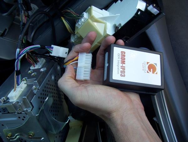

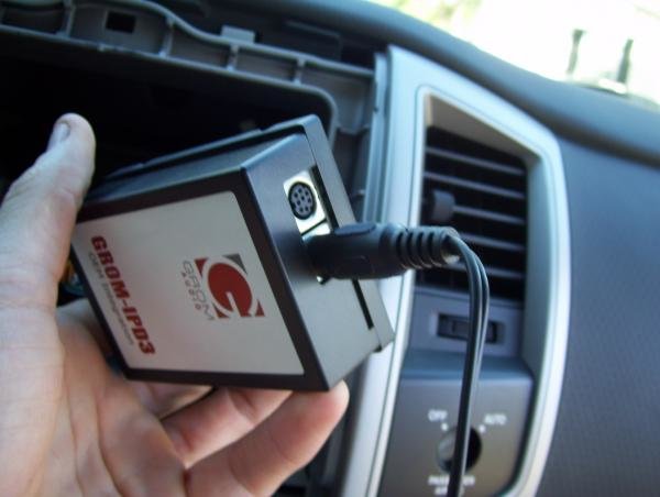

    4. Refer to your instructions and install your adapter/cables accordingly
    This adapter is fairly plug-and-play. Not much to get wrong. Simply connect this male end of the y-cord:
    into the back of the stereo unit:

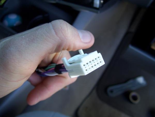

    If you have something else pluged into this port, utilize the female-end of the y-cable accordingly. Next, plug in the male adapter-end of the y-cable into the adapter itself:
    plug the PS2-end of the audio adapter cable into either of the ports:
    And *ding* it' installed. Now would be a good time to plug the power cable back in, grab your playing device, hook it up, and make sure everything works. You have to double-tap your stereo's CD button to switch to the AUX CD input. You may have to do a system restart on the system by Key ON > Key OFF > Key ON for the stereo to "pick up" the adapter & player.
    Once you've verified everything works, the next part is personal preference: where to route your cords/mount the adapter. There is a fair amount of space on top, on the sides, and behind the stereo unit to mount the adapter itself. Use some 2-sided tape and secure it where you would like. Same idea goes for the cable protrusion: it's where you'd like it. Some have the cord extending out into the glove box, some leave it out from under the A/C panel (if so, put a band of tape to prevent rubbing/chafing); it's wherever you'd like to place it. Use some ties to keep excess cord bound up and neat.
    Once you have everything placed where you like, simply reinstall the stereo unit, screw the 4 screws back in (carefully, or you'll lose a screw into the abyss like I did :eek:), pop the A/C controls panel back into place, and you're all set!
