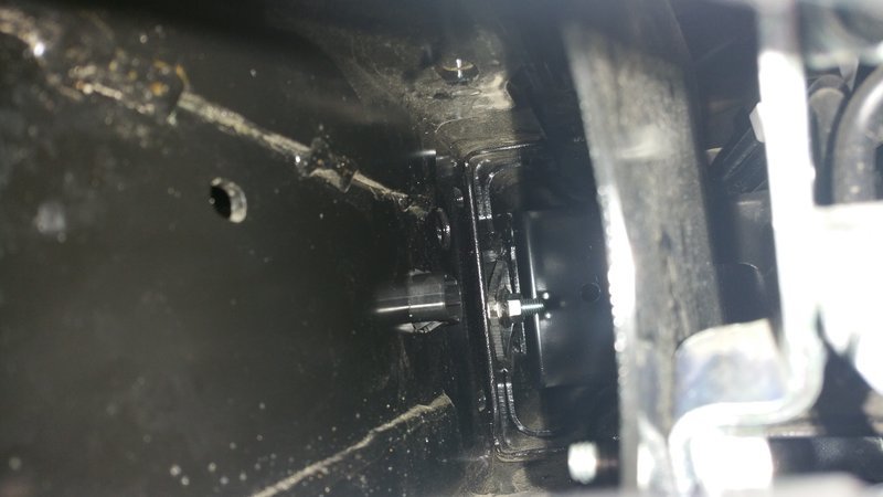

    Got the sliders installed. The suggestion to tape the back plate to a wrench was the right idea!
