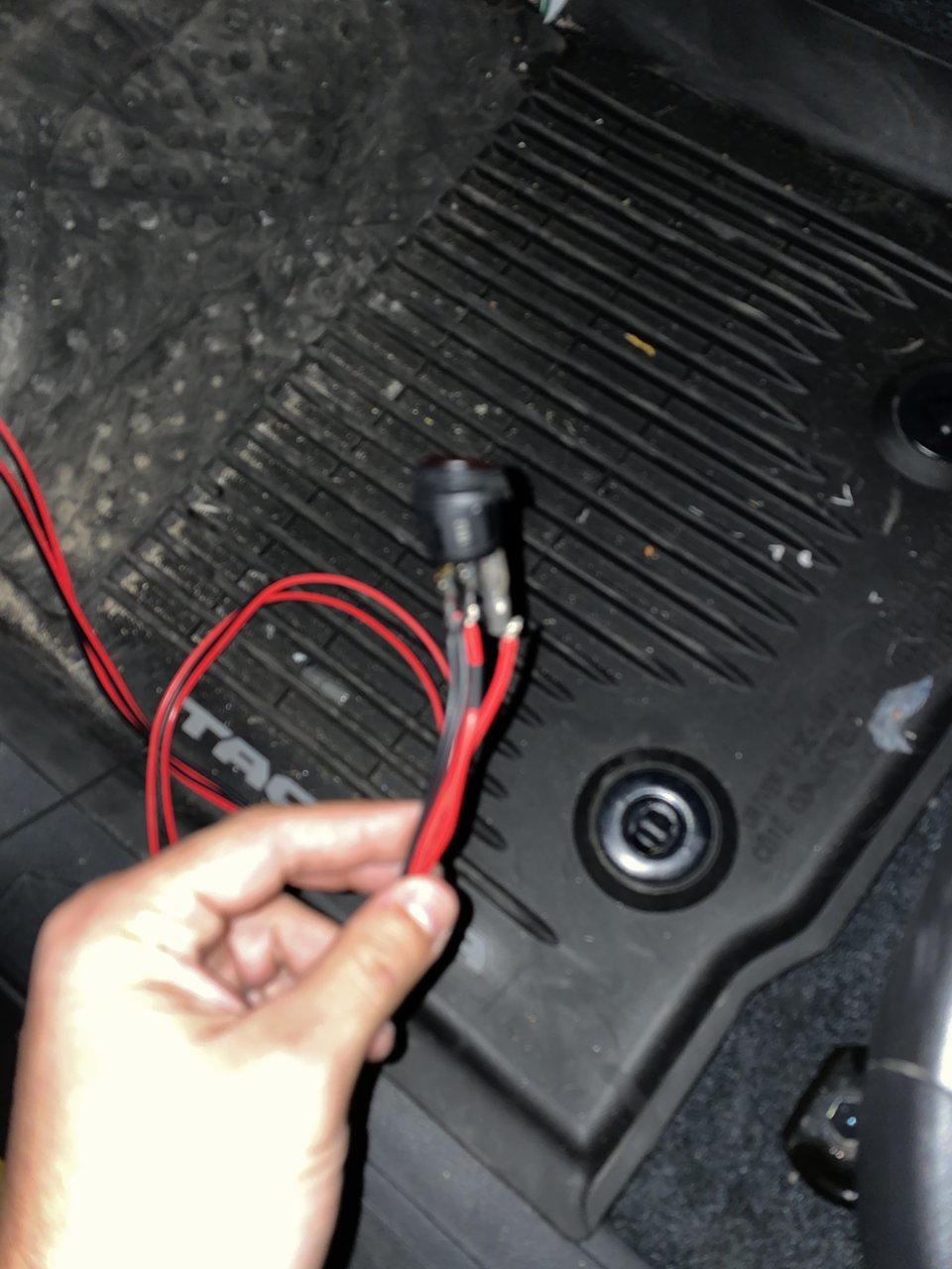

    So I recently bought a new truck and wish to make some modifications to it, one being ditch lights, which have been installed successfully but they came with a circular button from Rigid, and now I wish to add them to my empty spot on my switchboard (see image). I get the wiring is color coded on both the lights and the switch itself, but they don't match. How would I go forth in connecting them appropriately?
    Whats the cable color way to match?

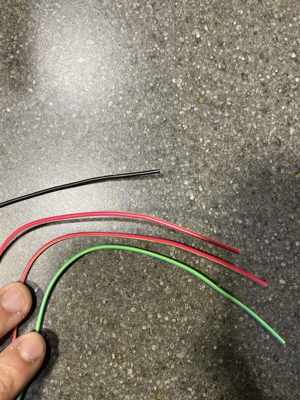

    On the Cali Switch, best I can tell is (starting left to right in your pic)
    Black = Ground
    Red = Accessory lighting circuit
    Red / Green = Lights / Relay
    Green = 12 Volt
    I cant see the Rigid Switch very well. But looks like only 3 wires?
    1 will be - Ground
    1 will be - Lights / Relay
    1 will be - 12 volt
  8. Nov 15, 2019 at 8:51 PM
    tijuanataco17
    tijuanataco17 [OP] Well-Known Member
    Sep 4, 2019
    #304272
    68
    Andres
    2020 TRD Offroad 4x4
    The rigid lights have three wires.
    1. black- ground
    2. red+black- switch output to lights
    3. red- switch input power

    Update:
    I figured it out, I stripped some of the wires on both the switch and the lights, connected the ground connections on both, connected the red to the green and red/black to the remaining two. Got it on the first try. Anyways, thank y'all for the help.
