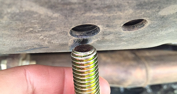

    Do you remember what size bolt you used. Toyota won't tell me the size and would have to order them.

    1.5" long
  3. Dec 12, 2015 at 4:24 PM

    Thanks, I finally was able to get one off and measure. Looks like 6/16 or 7/16. They're all mounted up just need to go get new bolts, I broke my C clamp trying to get them in!
    Thanks for your help.

    Sorry I couldn't help you on the thread count. I don't remember what it was. I had to take it to lowes and use their template. I got 1.5" long and could probably be shorter but it doesn't matter as it's just a welded nut on the other end. So extra length won't matter.

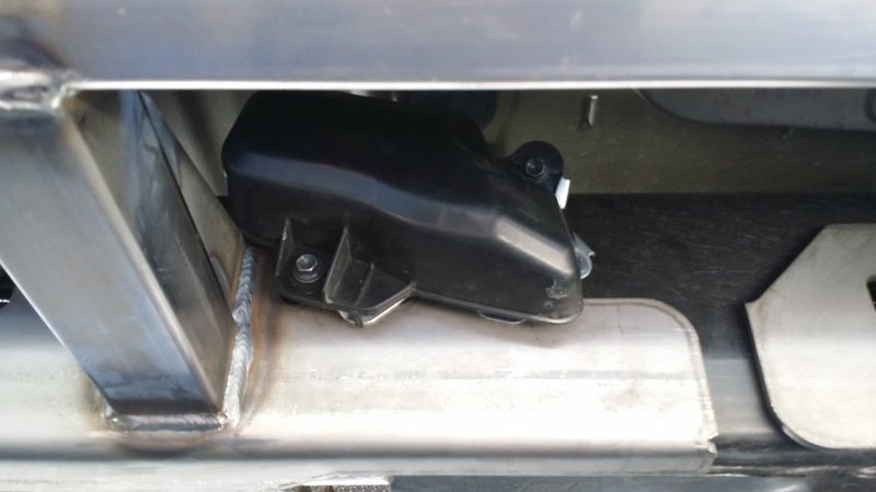

    OK... i installed these today. I have a plastic box on the outide of the frame underneath the passenger side door. It houses some wires. i cannot put it back in its stock location because of the gusset that is on the top of one of the legs that attach the sliders to the frame. Anyone else have this issue. I have a 2015 TRD off road DCSB. I haven't found another tacoma with this same little plastic box.

    @ragincajun35 My gen 3 has this box too. Did you ever find a solution?

    Yea I just unbolted it and moved the box forward one hole. I called BAMF about this and they said that that changed in 2014 I believe. It's the electrical bits for the plug in the bed. I haven't found a long term solution for it. I haven't had any trouble with it the way it is now though. What I will prob do is once I get them dinged up and am ready to repaint I will prob relocate the gusset on that front passenger side leg. Sorry not much help. Good luck

    Jerry looked at my truck when I picked up my sliders and what he ended up doing was just moving that box forward a little and securing it with just one bolt.

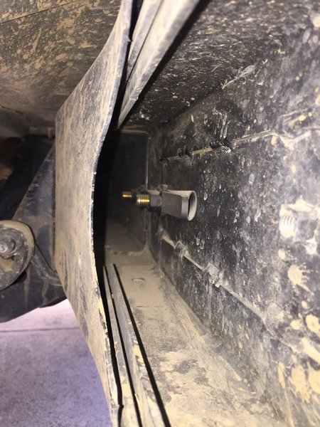

    I would make sure you have the right bolts in the right spot when you get to the install. There are two sizes, mine all went perfect.
    And the picture below should explain the lever portion. It's near the front of the truck and inside the boxed section.
