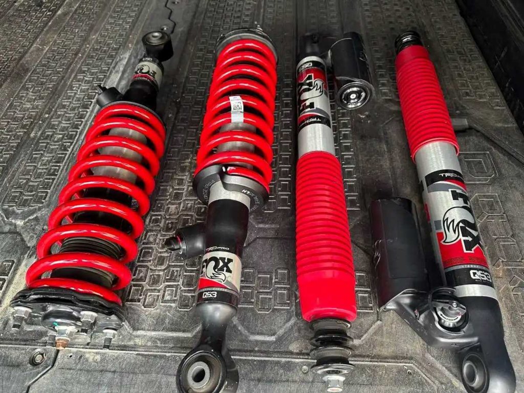

    Just wondering y'all opinion, I just got a front set of TRD Pro Fox suspension. I have a TRD Off-Road and I am interested in installing it for my truck. I only have the resources to get the front suspension. Would there be any problems or quirks of doing this?

    No problems I can think of with that.

    Not sure, but here's my story. The suspension parts shipped in stages. RXT packs first, then 5100 fronts, and finally 5125 rear shocks. I reused my stock front coils. It was odd but fun as I installed each as they arrived, and before the rear shocks showed up, I did a 4,000mi trip. During that trip, I would hit a bump every so often that just did not feel right. I chalked it up to just the way it was going to be. But after I installed the rears, the feel changed pretty significantly and was more cohesive.
    It is cool that there is no jittery-ness with an empty bed, like stock did. Just feels planted empty or with stuff back there.
