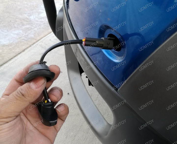

    buddy gave me these after upgrading to smoked. I can always upgrade to smoked later as well; Morimoto sells the set for $70.
    Was originally going to copy this thread:
    https://www.tacomaworld.com/threads/vled-mini-pod-side-markers.692362/
    but why get $90 VLED kit for parts I already have.
    I run without flares like this:
    So while yes, the VLED would hopefully fit into one of the holes (currently plugged with a pin)
    or require slight boring out of the hole with a drill bit (circular shape)
    the Raptor markers likely have better visibility from more angles. As they have multiple LED's, and a diffuser lens.
    I found a thread on Xterra forum where guy did this job:
    Question is this. How do you make the holes? They are oval shaped.
    AND, the rubber grommet (press fit) has a pretty weird shape (multiple lips) that is hard to measure, to figure out precisely the right oval size.
    If I make the oval too small, it will not fit, pop out, or deform.
    Too big, and it will be loose, move around, or fall out.
    I have never drilled an oval hole before either, only circles.
    I think I'd have to drill 3 circles, then shave the remaining metal off with a reamer.
    That's the benefit of VLED; it would probably require enlarging circle hole. Not that big a deal.
    But if this route, it would require permanently "altering" one of the clip holes of my fender, which would prevent re-attaching flares later on if I decide to.

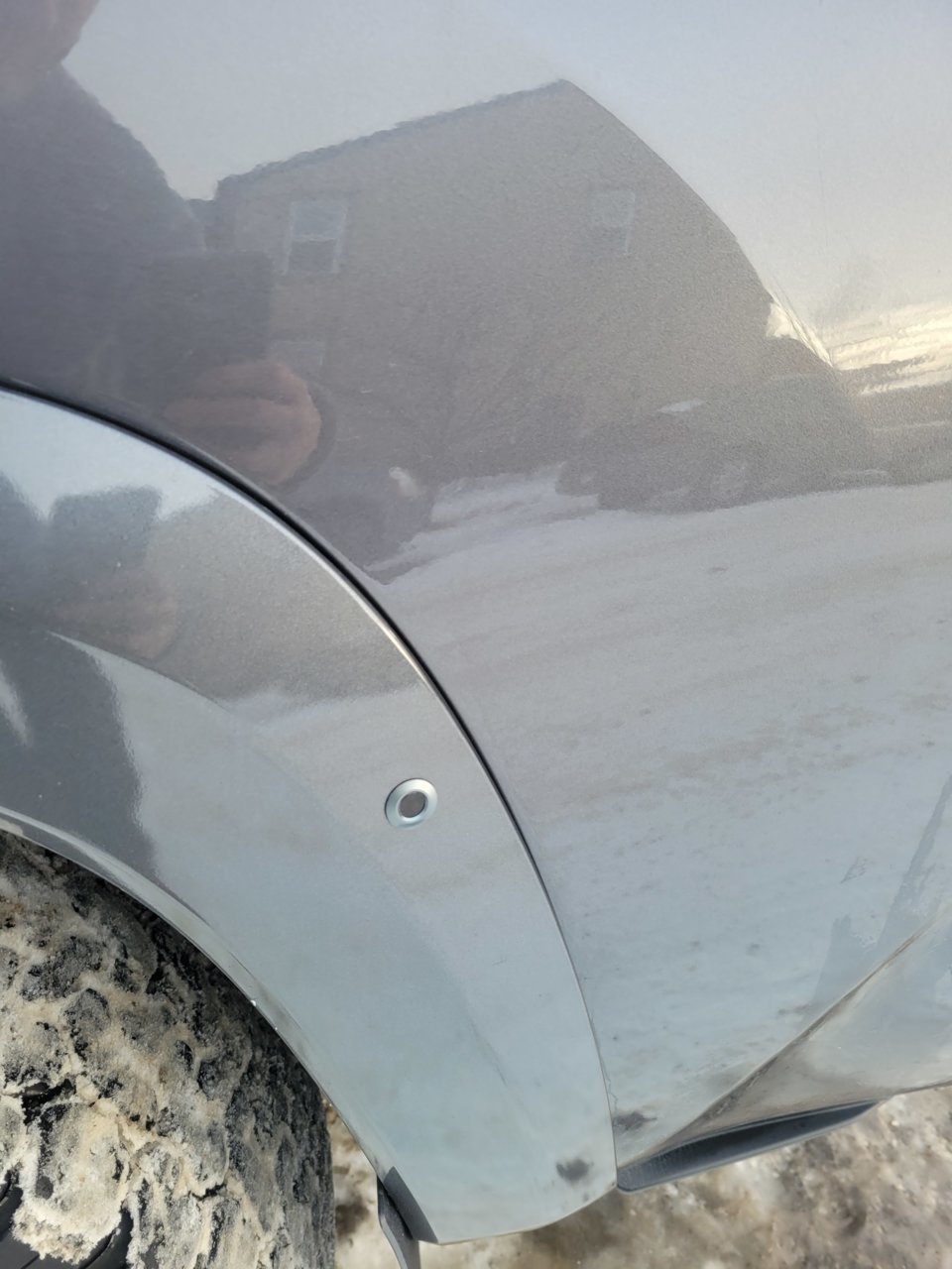

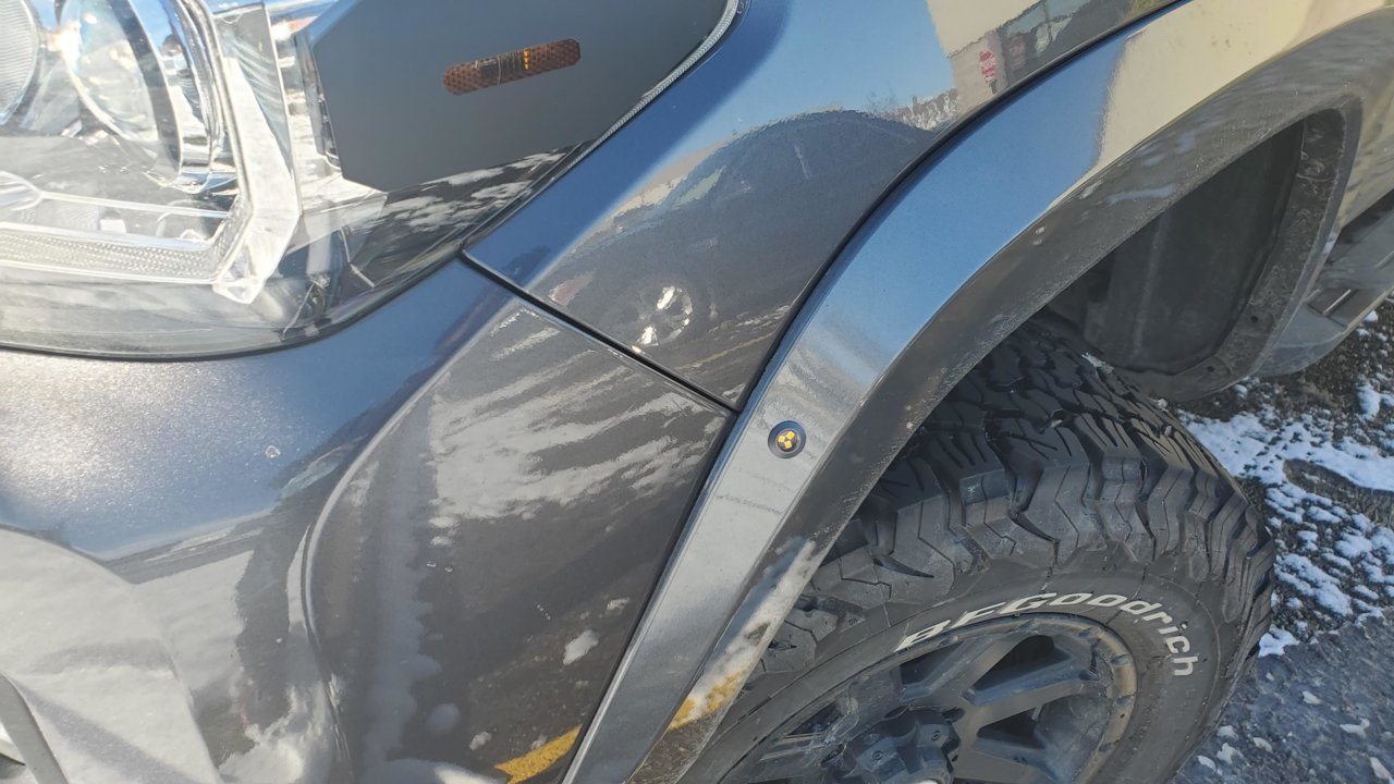

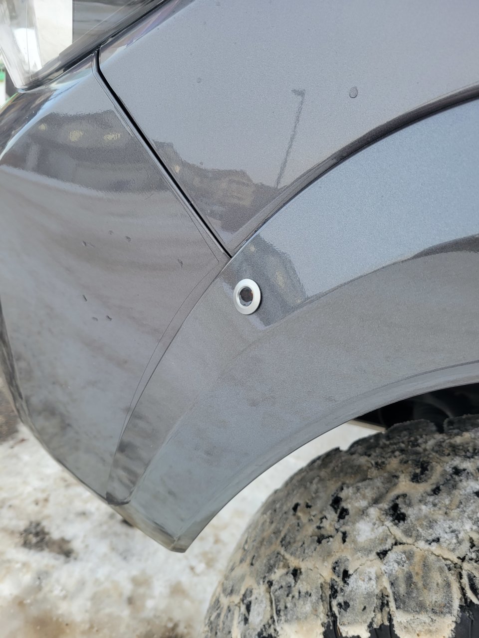

    Definitely a safety improvement was my number one reason I did it. Agreed that most people just are not that aware while driving.
    Surprisingly the VLED kit does throw good light for what it's worth. They are still holding up as well after a couple years and harsh winters here.
    For your choice though and without having speciality tools I would make a template from tape and drill out maybe 4 small holes around the oval and then try to dremel in-between? Hope that makes sense.

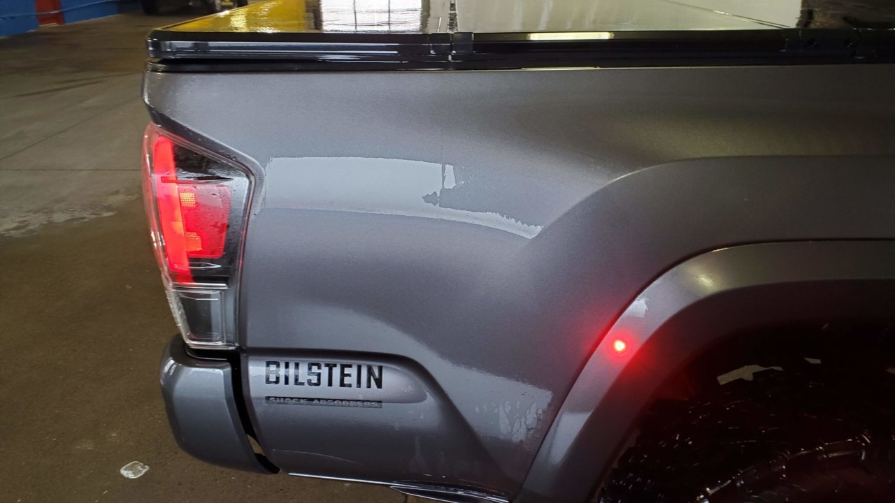

    Here's a couple updated shots of what the VLEDs look like if you're interested. A bit of medium tint 3M film on each one. Has little effect on light output but a bit more stealth. Strangely enough the black casing has somehow faded to a mear MGM match lol. 20230105_142222.jpg 20230105_142236.jpg
