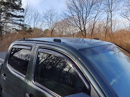

    Just removed the rack for winter. Here's how it is with the caps over the mounts.

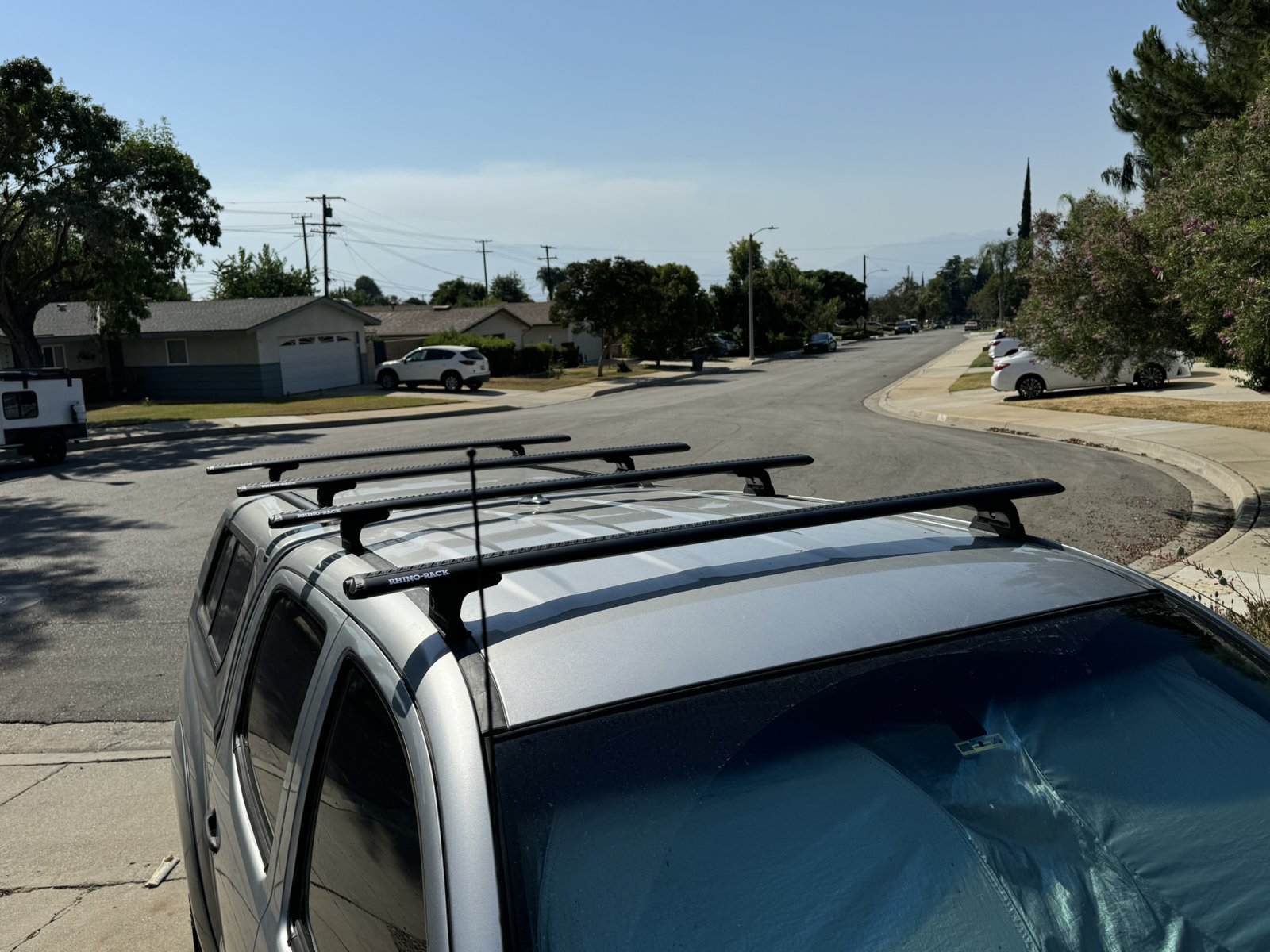

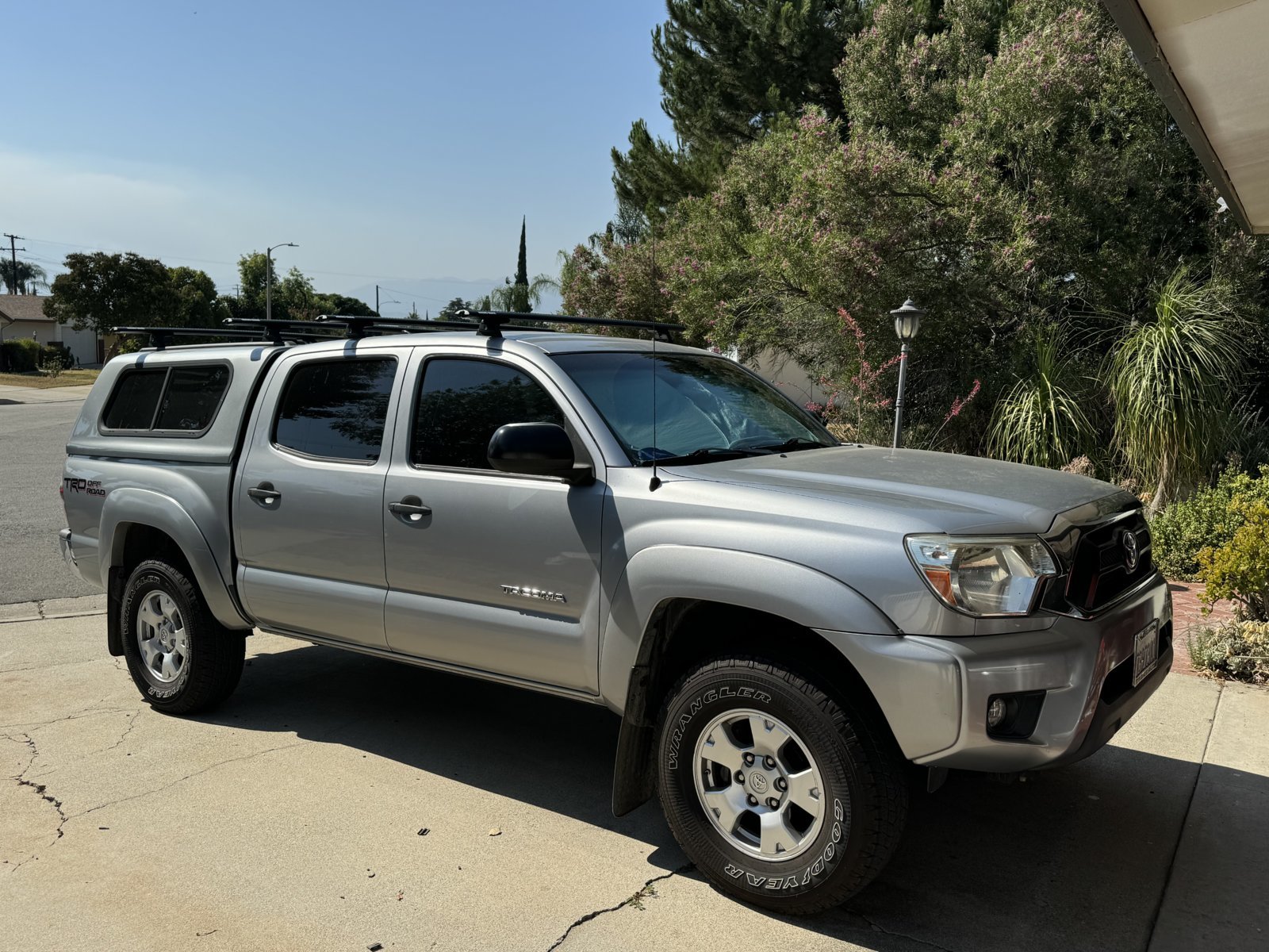

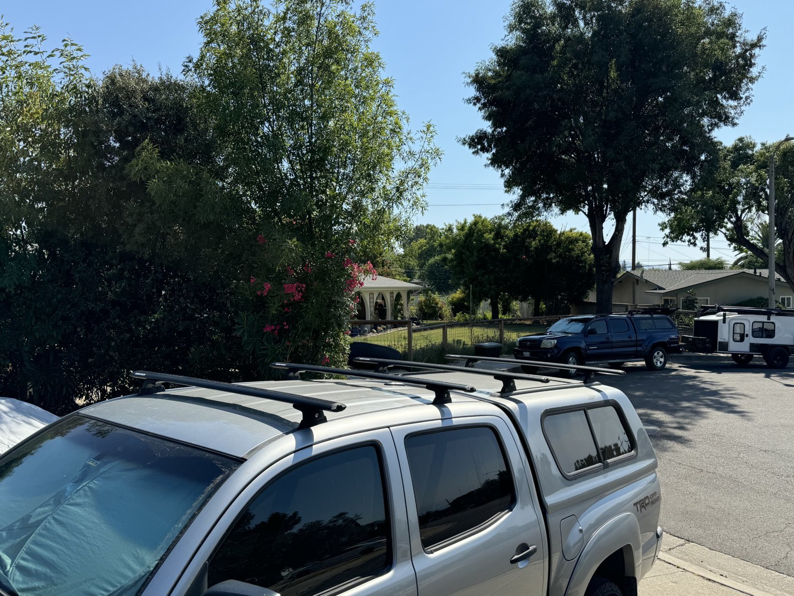

    Old thread I know but I just finished up this install on my 2014 DC TRD OR. I am super happy with the results, but the install is not a walk in the park.
    Pro tips I learned:
    - You need a bigger rivet gun than you think you do. I had to buy a new one from Harbor Freight just for this job
    - saving the rubber strip in the ditch is a pain, but makes the install look a lot cleaner. There is a lot of trimming required to get it to fit around the RR ditch brackets.
    why not Prinsu, you ask? I looked hard into all the options and I wanted something quick and easy to put on and take off. I also love the quality and value of Rhino Rack products. They are not paying me, I am just a happy customer. I paid etrailer prices for all 4 racks and the camper shell track.
    Overall, I would recommend, but they are not the cheapest option out there and the cab rack install is not for the faint of heart. I now have 12 more holes in my roof than I had this morning. I do have high confidence in the water tightness with butyl tape and a topping of silicone - it’s at least as good as the factory rack mount points - and all the racks are super sturdy.
