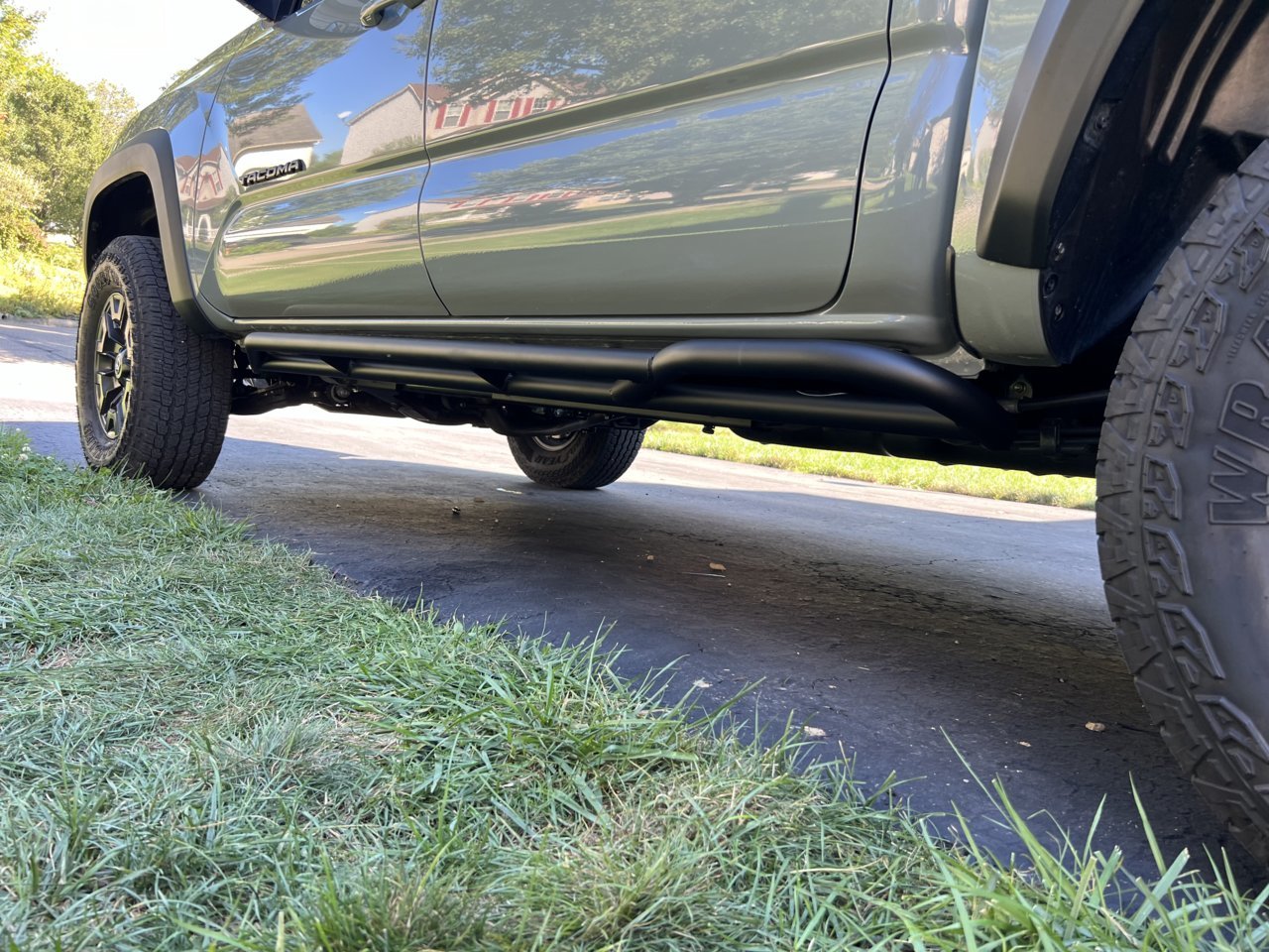

    Just got my Revo sliders from Body Armor 4x4 installed yesterday. While there is plenty of info on this install out there already, I wanted to share a few tips and tricks for issues that I came across during the install. First off, I used the BA4x4 install sheet (https://cdn.bfldr.com/T4M9XMBZ/as/6gkw4z99vvv66k2px28rf37/TC-4125-INST) and the following video (https://youtu.be/FlrF0nBUMwU) as a guide. These two resources will get you most of the way there.

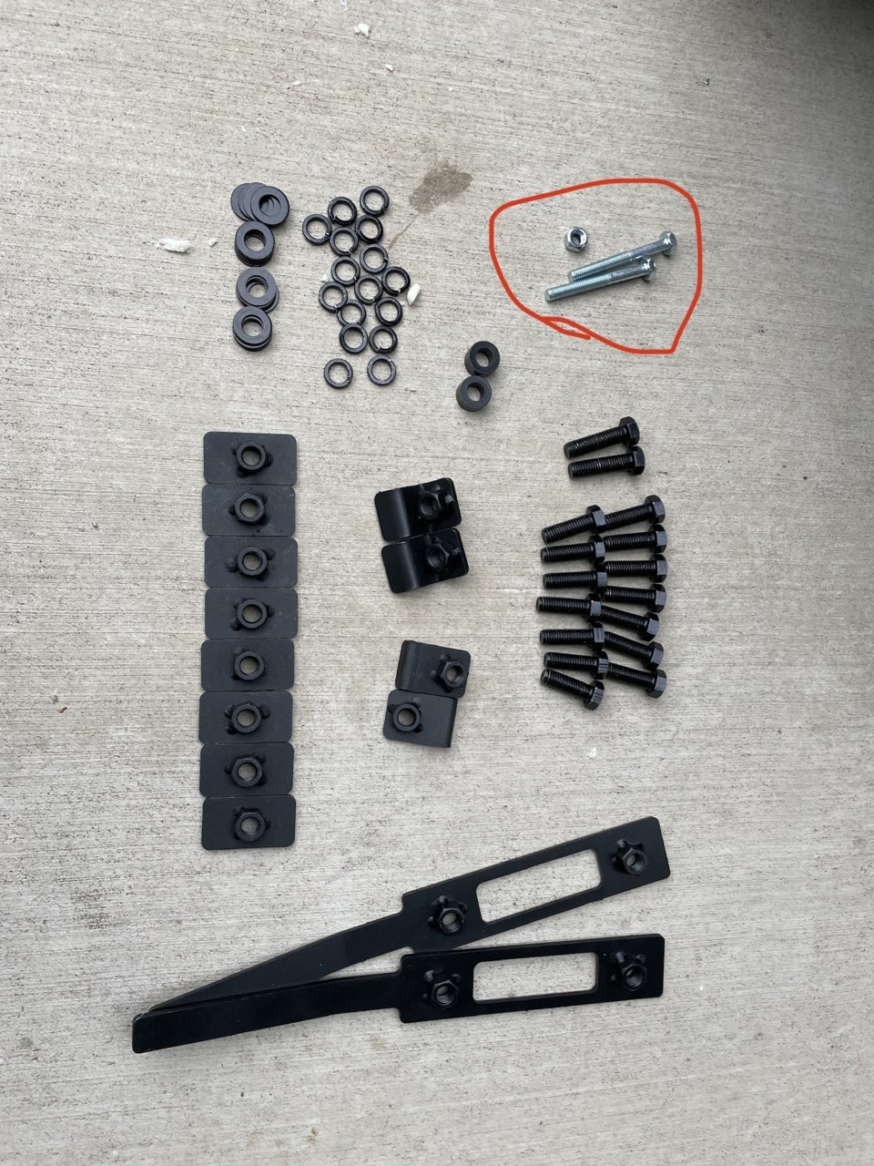

    Next I laid out all the hardware to ensure it’s all there. Everything was in check and I ended up with some other random grade 8 hardware. Tip 1 - The two longer 21mm bolts are for the very front mounting point on the frame rail. Also get yourself some blue loctite handy at this point.

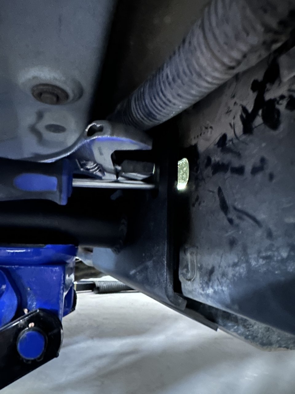

    Next, like the video says, start with the passenger side (as a warm up) and remove the 14mm rear crossmember bolt and hoist the slider into place. I did this by myself with two jack stands. Reinstall the 14mm to help hold everything in place while you get the other hardware installed. Tip 2 - use some foam or cardboard to protect your rocker panel if the slider rotates upward. I almost screwed myself when the slider slipped out of my hand and rotated upward when mocking it up.
    Loosely install all the hardware. The front two bolts inside the frame rail can be a source of frustration. Keep small children away while you swear and curse, and keep a beer handy.

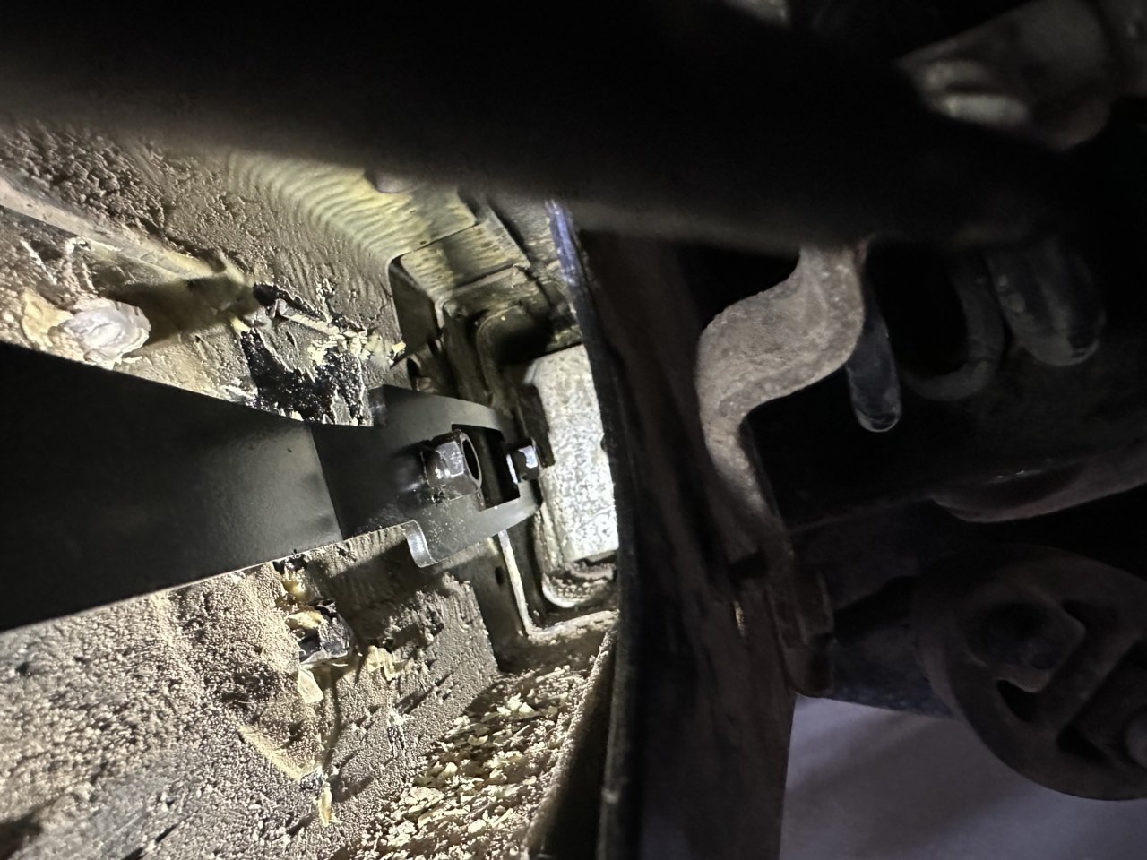

    One of the center mounting points that uses the L bracket (as they call it in the video) is poorly designed. The bracket sits on the frame in an area where the frame rail is tapered. When you go to finish tighten this bolt, it will sit cockeyed and not flush against the slider. I left this bolt off because of this.

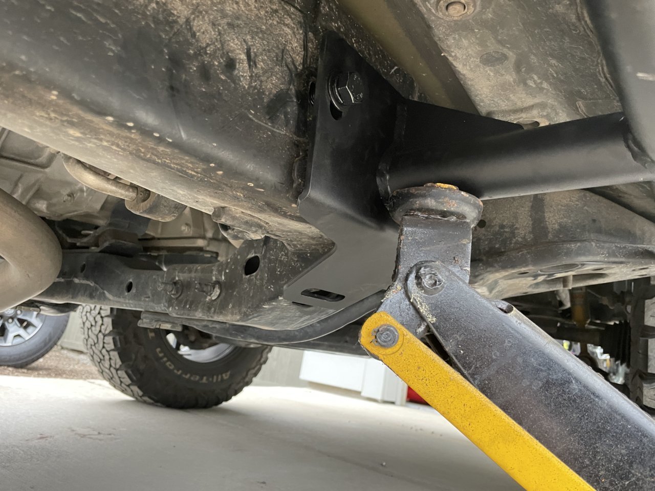

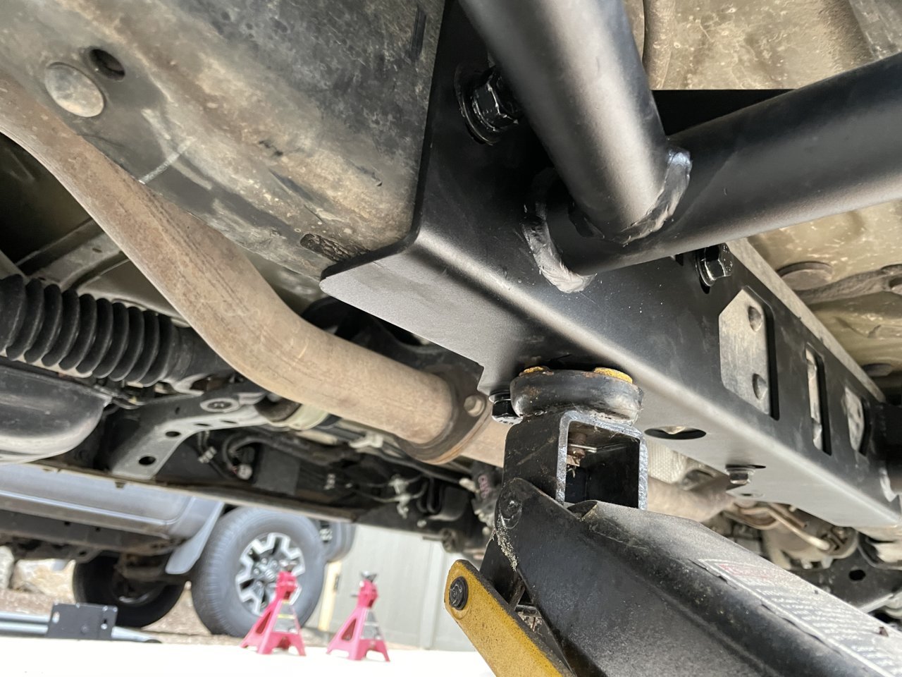

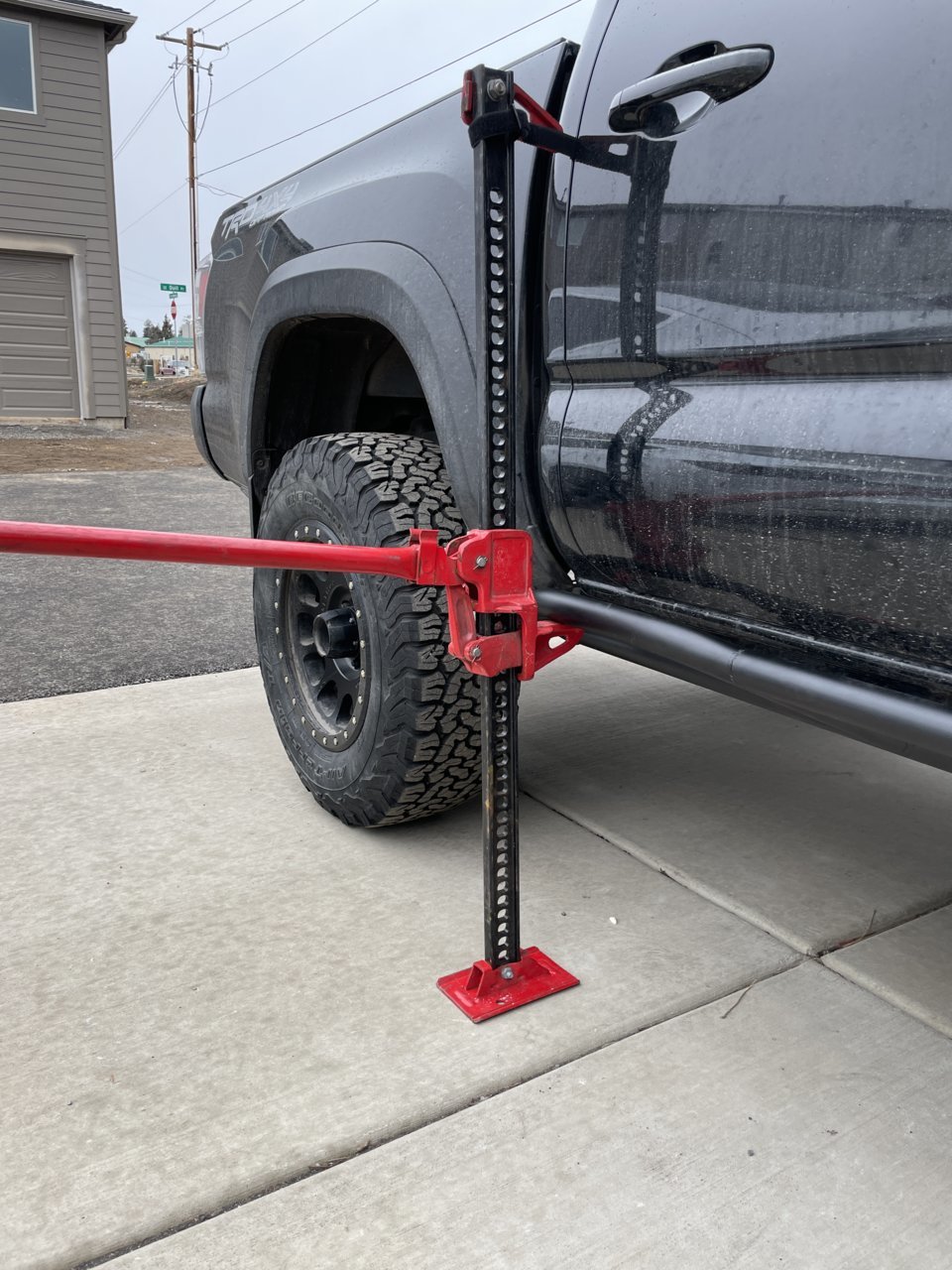

    Once you get all the hardware loosely installed, start tightening from back to front. Tip 3 - Use a jack to lift up the slider flush against the frame before finish tightening.
    6A5BF86C-A263-4316-A797-FB1C70D055FA.jpg 90C3B5FE-0B02-4290-940E-C2C93276D2E2.jpg
    Passenger side done! Now for the driver side….

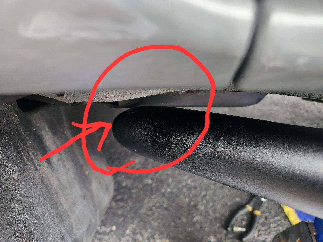

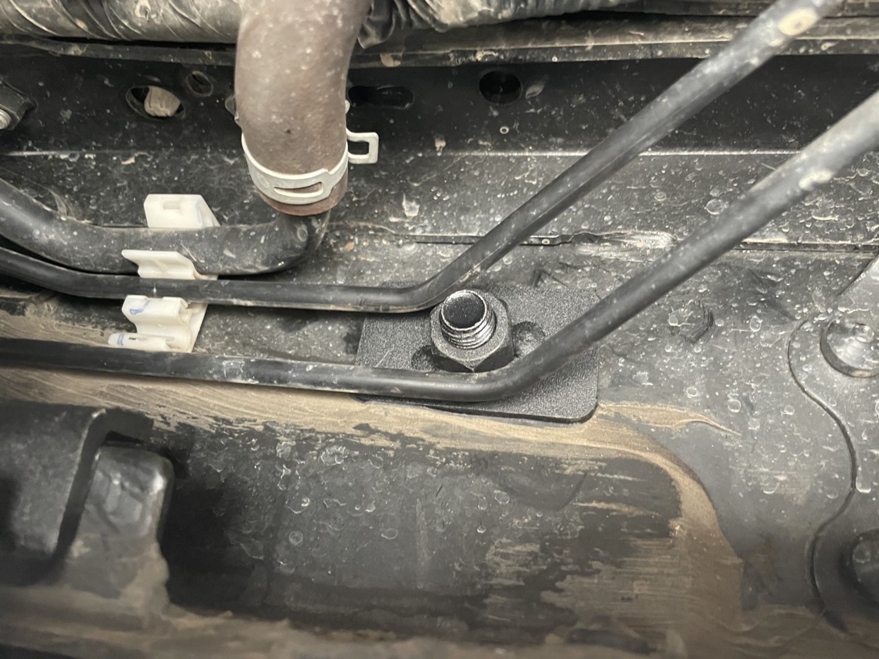

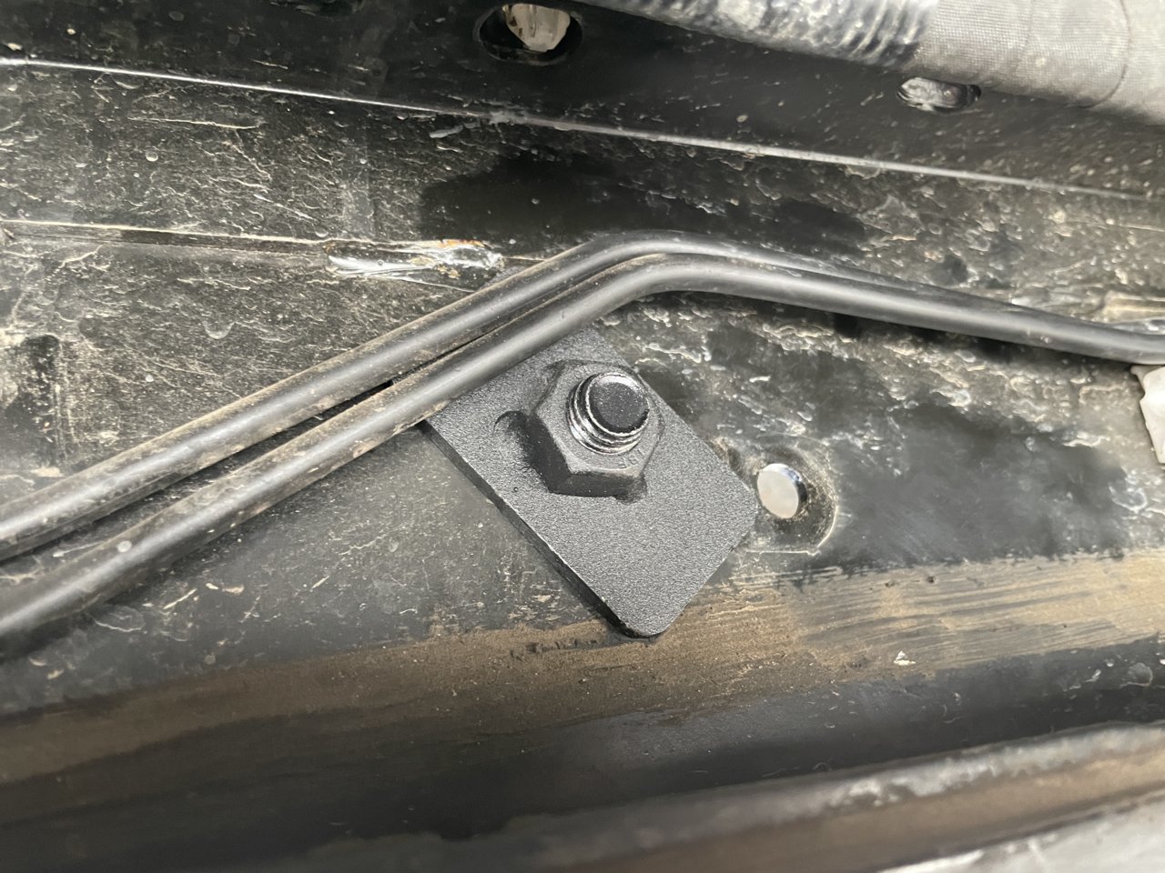

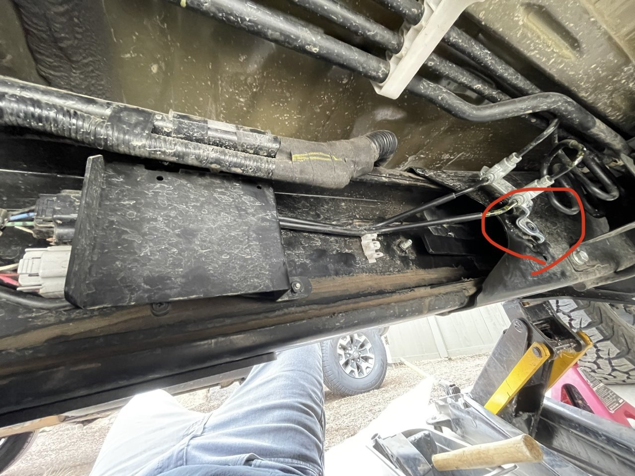

    This one was a bit tougher. Steps are essentially the same, but the brake lines and other components on the inner frame rail make it more challenging. You’ll have to remove the plastic clips for the wire loom on the outer frame rail and push the wire loom up out of the way. Tip 4 - Remove the 12mm bolt holding the brake line manifold and push it out of the way while you install the front mounting bolts, which helps a lot.

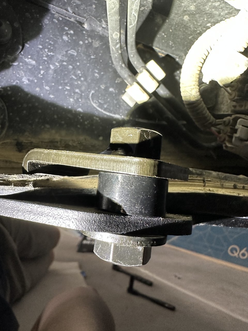

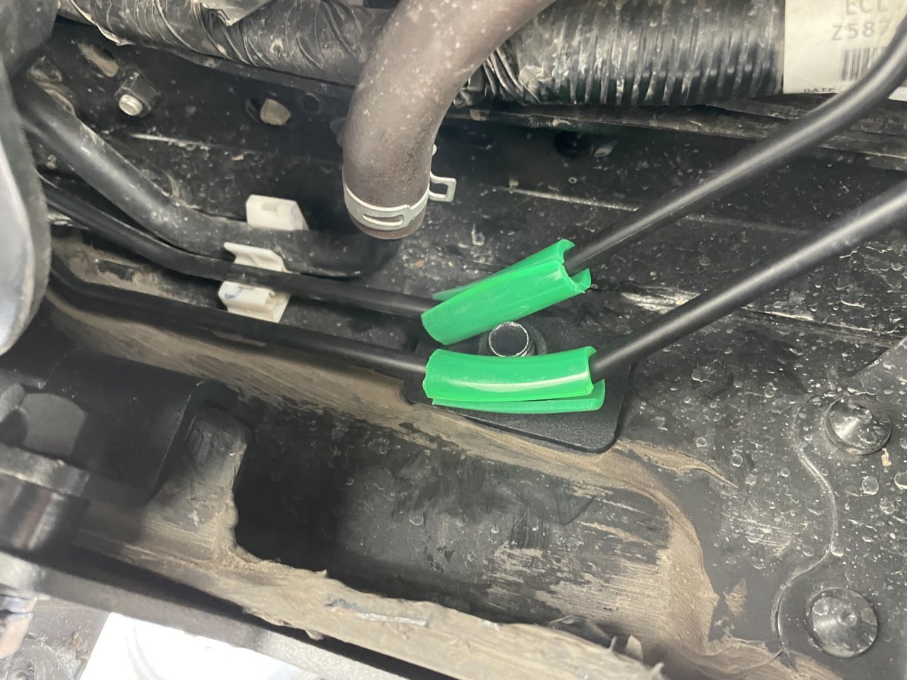

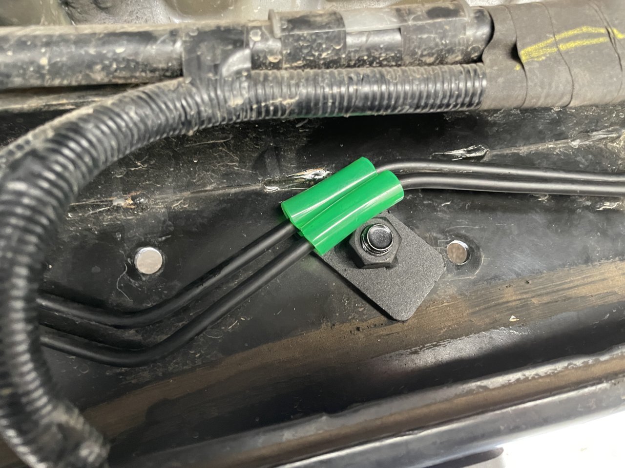

    The front-center mounting point is obstructed by the electronics box on the inner frame rail, shown in pic above. Remove this with a 12mm via the nuts on the outer frame rail.
    You’ll have to unclip the brake lines from the frame with a flathead in order to get the welded nuts in. After hoisting the slider into place and getting bolts started (one by the fuel tank can be pesky), tighten back to front again using the jack to hold flush in place.
    You’ll notice that the welded nuts on the inner frame rail are contacting the brake lines. Don’t ignore this! In my personal opinion, brakes are somewhat important so I spent some extra time here. Tip 5 - I used some poly 3/8” water line from my jet ski toolbox to make some shields where there was metal on metal contact. You don’t want the brake lines touching each other or any other metal, so add shielding anywhere where this is occurring. Re-clip the brake lines in place and reinstall the electrical box unit.

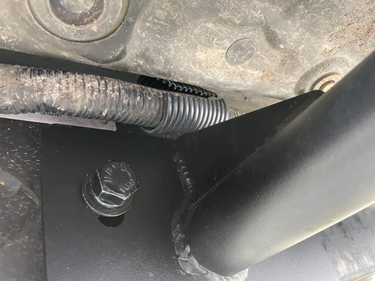

    Finally, reinstall the wire loom clip on the outer frame rail. You’ll only be able to get the rear one, so use some extra loom to cover the wiring where it crosses over the slider triangulation.
    Double-triple check tightness on everything, and you’re done! This took me about 4hrs with struggles, mistakes and pitfalls. Your results may vary. I just wanted to make a post about this to fill in the gaps in other install instructions, in case it’s helpful for others.
    Overall review after install, it’s a great product for a bolt on. Some fit and finish issues but nothing that makes me regret my purchase. I like tube sliders because they are a great lift point for a hi lift jack and they are cheap insurance against rock strikes. Now to go bottom my truck out on some rock shelfs!

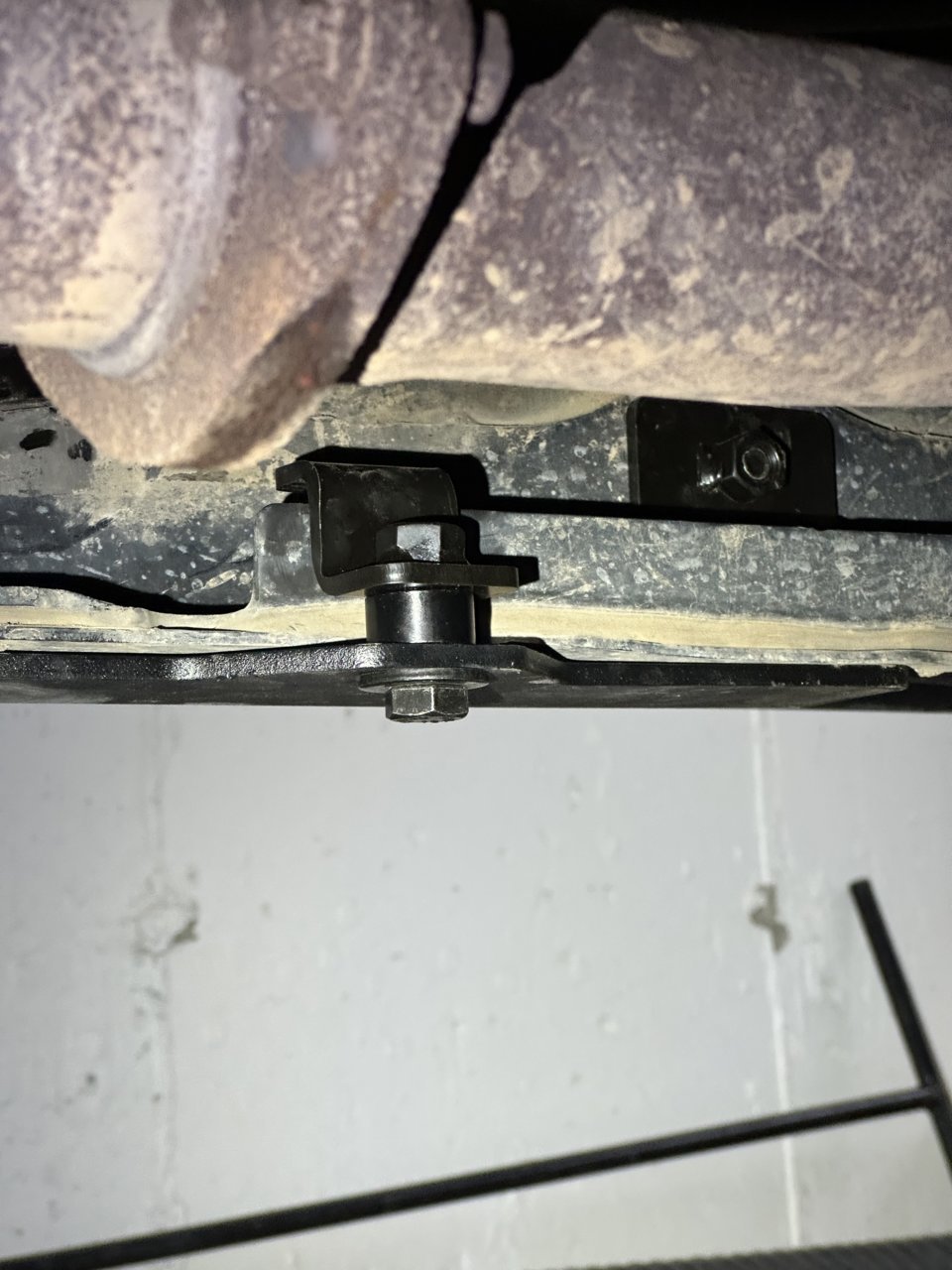

    Thanks to everyone in this thread for the knowledge shared! Some learnings for the next person who attempts this.
    1. put the nut into the front cross member before positioning the slider.
    2. the “s” bracket will not actually contact the frame with a spacer. Don’t follow the video on this! The instructions from body armor are actually correct in this area.
    413B246B-3242-488E-8237-C023C2BF2AC9.jpg 313D08DE-6CE2-423D-BBF6-D097E189423C.jpg
    pic shows L bracket correct and S bracket not contacting frame.
    3. the “L” bracket is where the spacer should go, it allows the bracket to sit level with the frame and grab onto the tapered portion of the frame still.

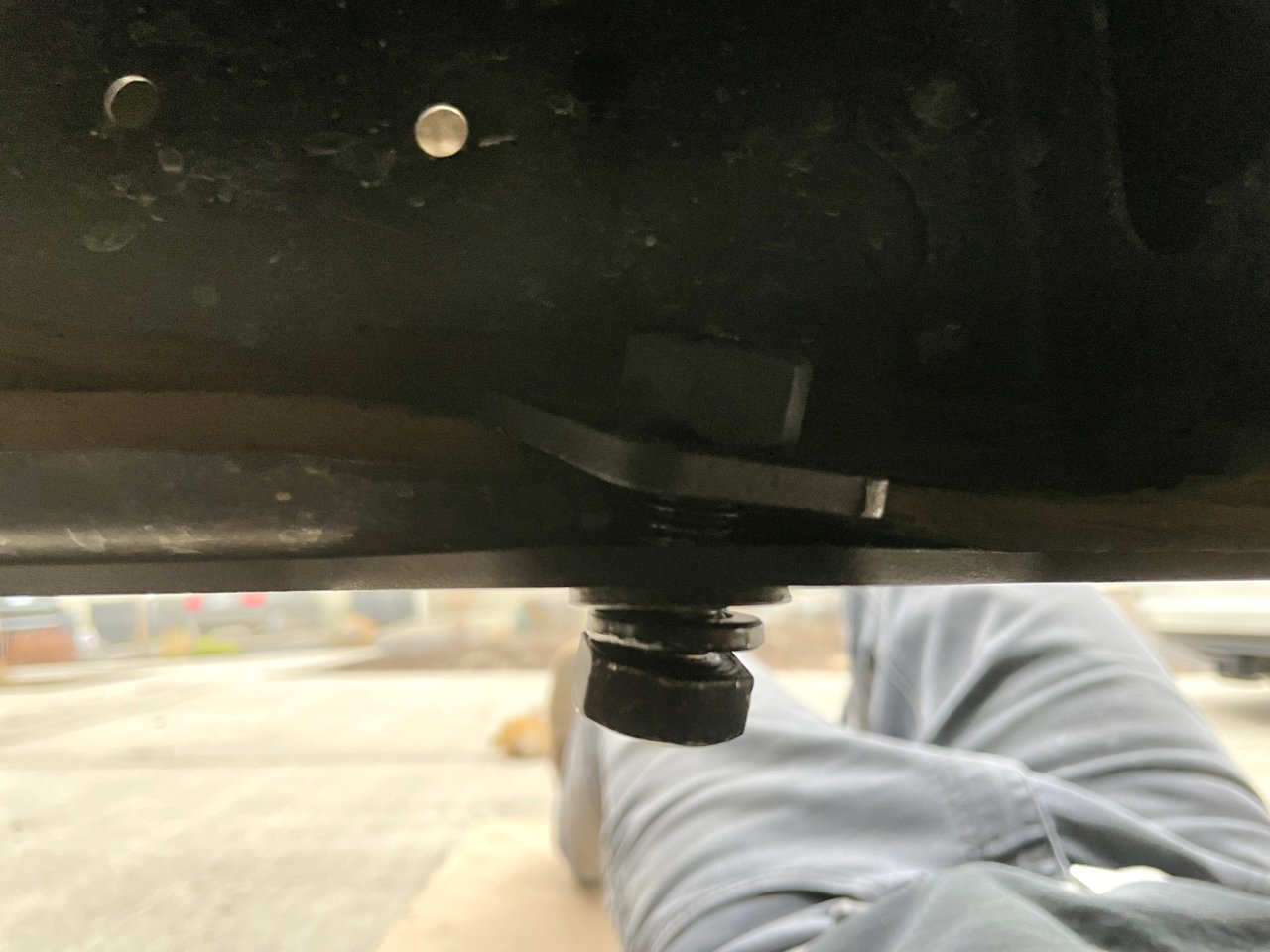

    4. If your frame is like mine, the front bracket has a something sticking out between the bolt holes which is what makes the front bolts so challenging. Do the farthest forward one first so you can use the leverage of the handle on that long double bolt bracket for leverage to flex it back toward the bolt hole.
    notice the vertical metal piece between the bolt holes
    5. I didn’t find it that challenging holding the long bracket for the passenger side in position to line up the bolts, but the driver side is another story. Used a screwdriver and a wrench weighing it down to hold it in position via the rear bolt so I could adjust just up/down and line up the front bolt hole.
