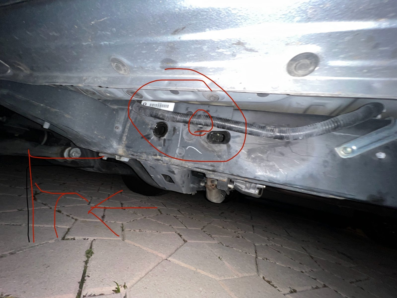

    I tried installing them on a time crunch bad idea. I got stuck on the driver side trying to remove the wire loom clip on the front side without breaking it.

    606
    JB
    19 Cement Grey Tacoma Offroad
    Do you have a picture, I want to see which wire loom you referring to

    Supermansami
    Supermansami Member
    Nov 25, 2019
    #311702
    17
    Sami
    2020 toyota tacoma trd offroad
    Hope this makes sense but it is on the driver side.
    dsmoot and YE2KA[QUOTED] like this.
    Bummer another obstacle to over come. Mime haven't been shipped but trying to get a full grasp of the install. Is the clip accessible from the back?

    206
    2023 TRD OR DCSB MGM
    This should be, the install guide on BA4x4 website tells you how to remove it I think

    I installed these with the help of my brother and it took us about 3 hours I think to install mainly because we started with the driver side. The passenger side took about 30 minutes. The driver side has a few clips you have to move to install. For example the brake line clips and the clip on the harness stated above. That harness came off easily with a tool my brother had I think it’s specifically to remove clips. I will say I did modify two screws on the driver side. I cut them down a bit. Since they interfered. But I did use blue loctite on all my screws.

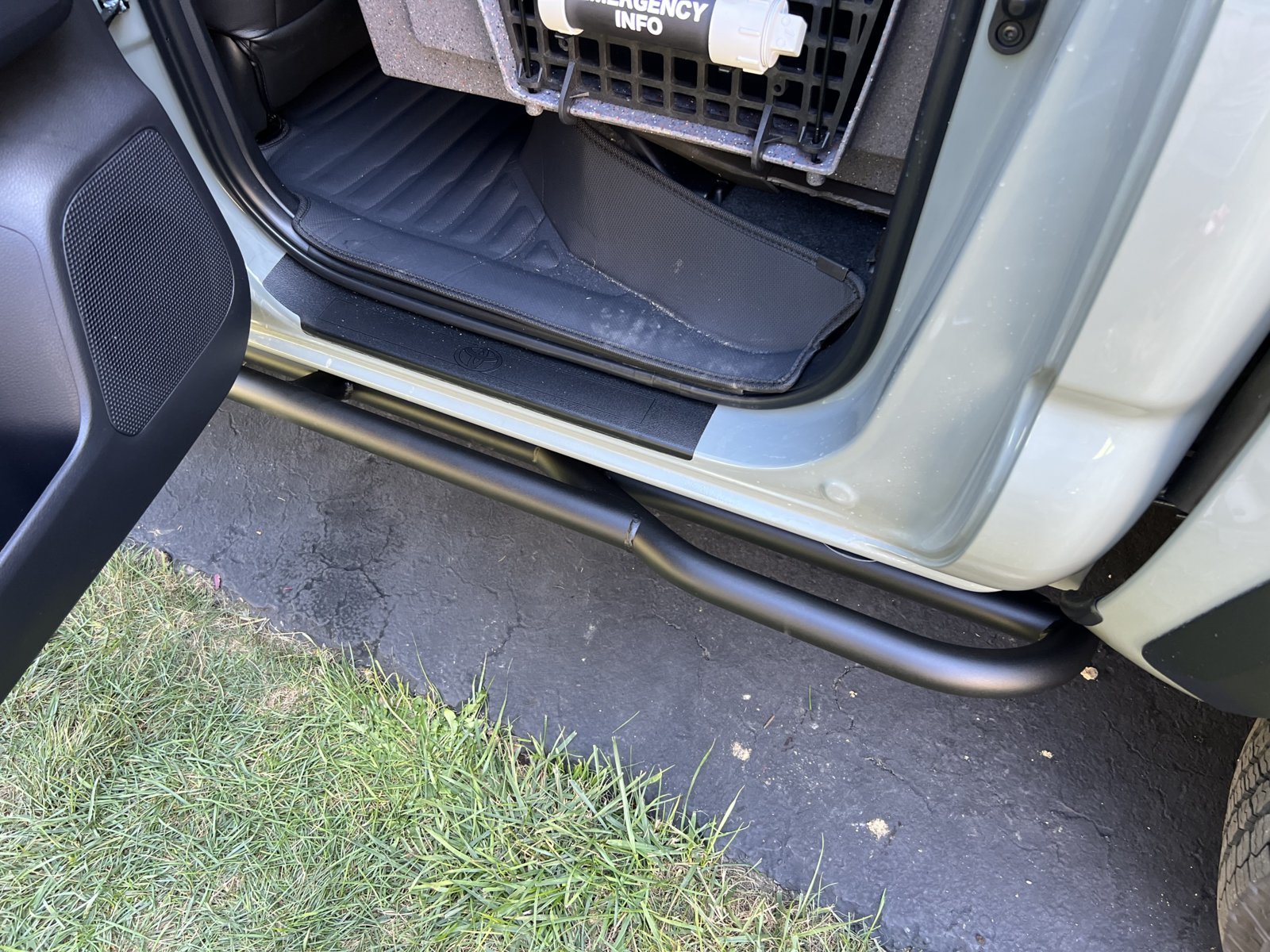

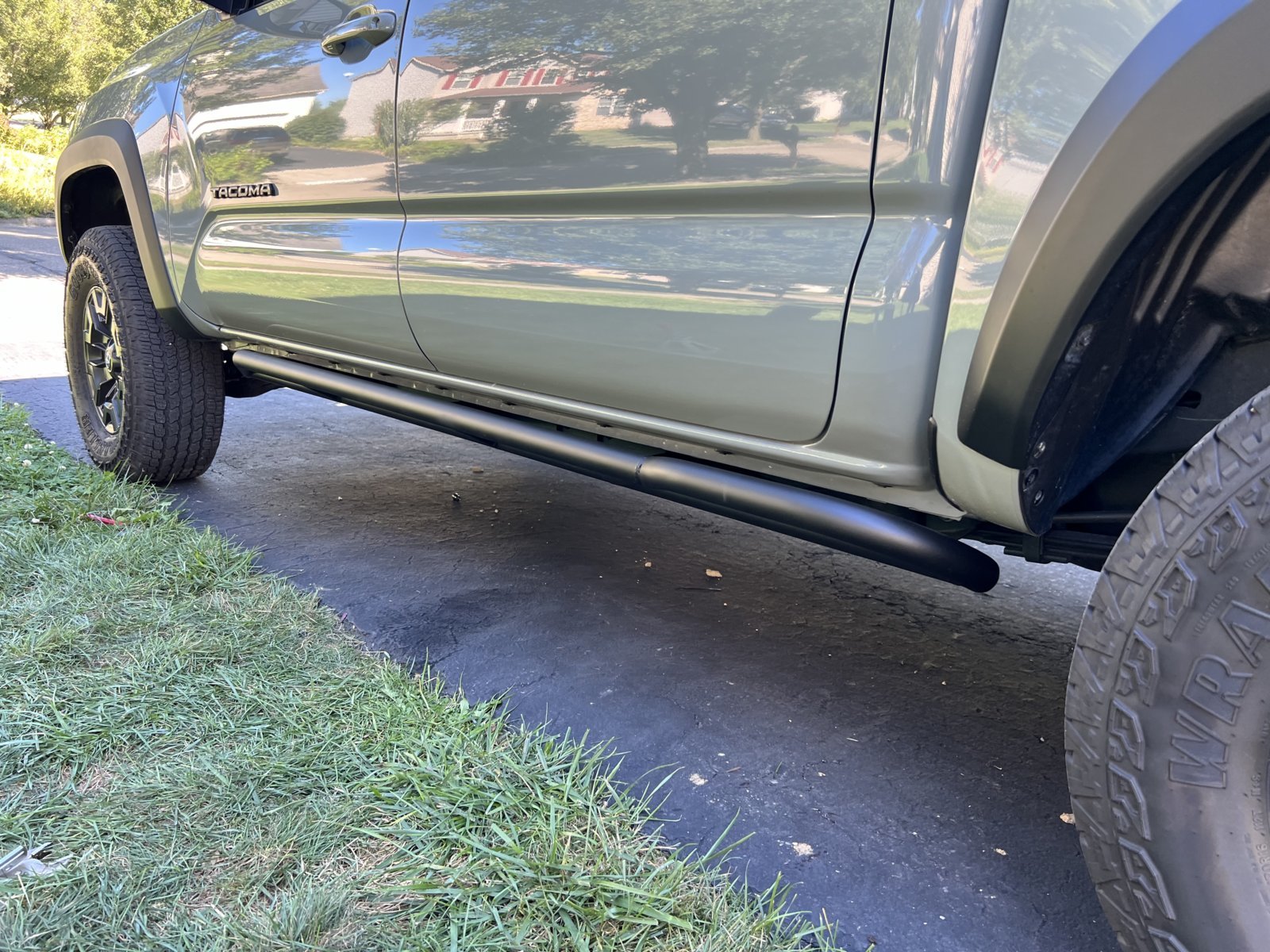

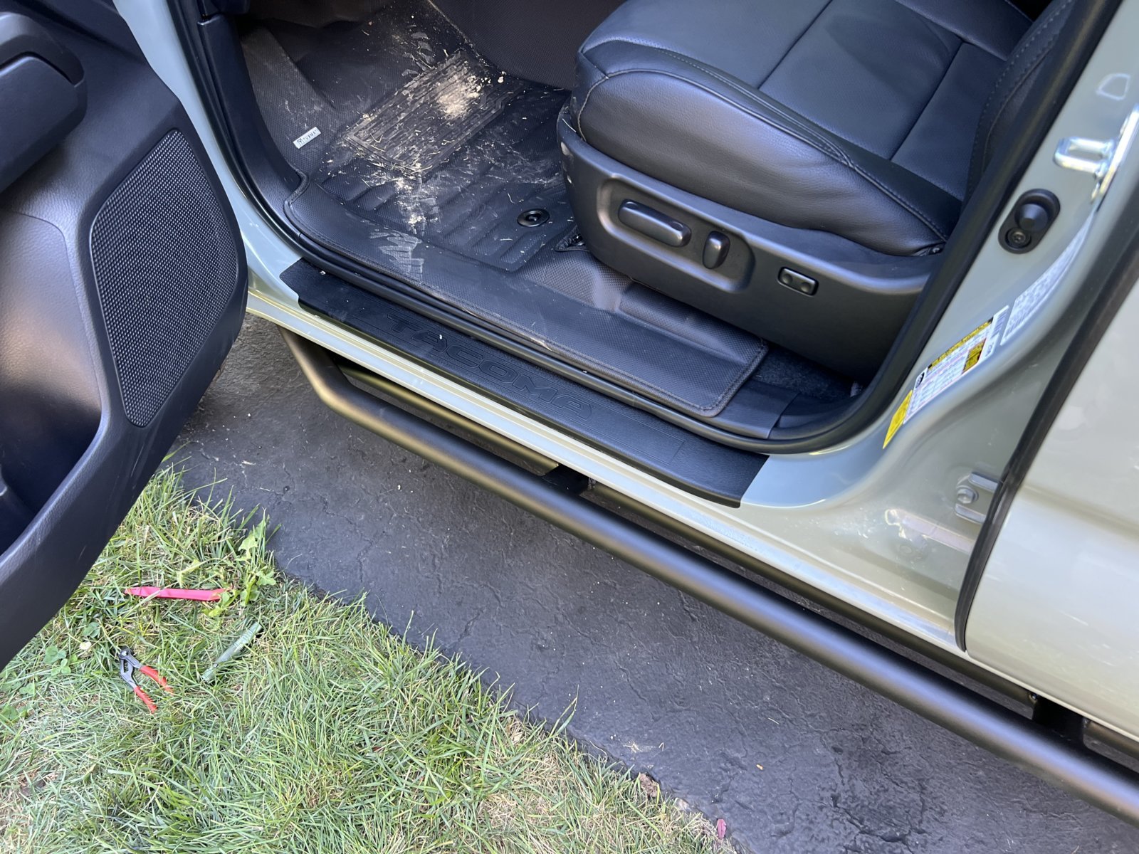

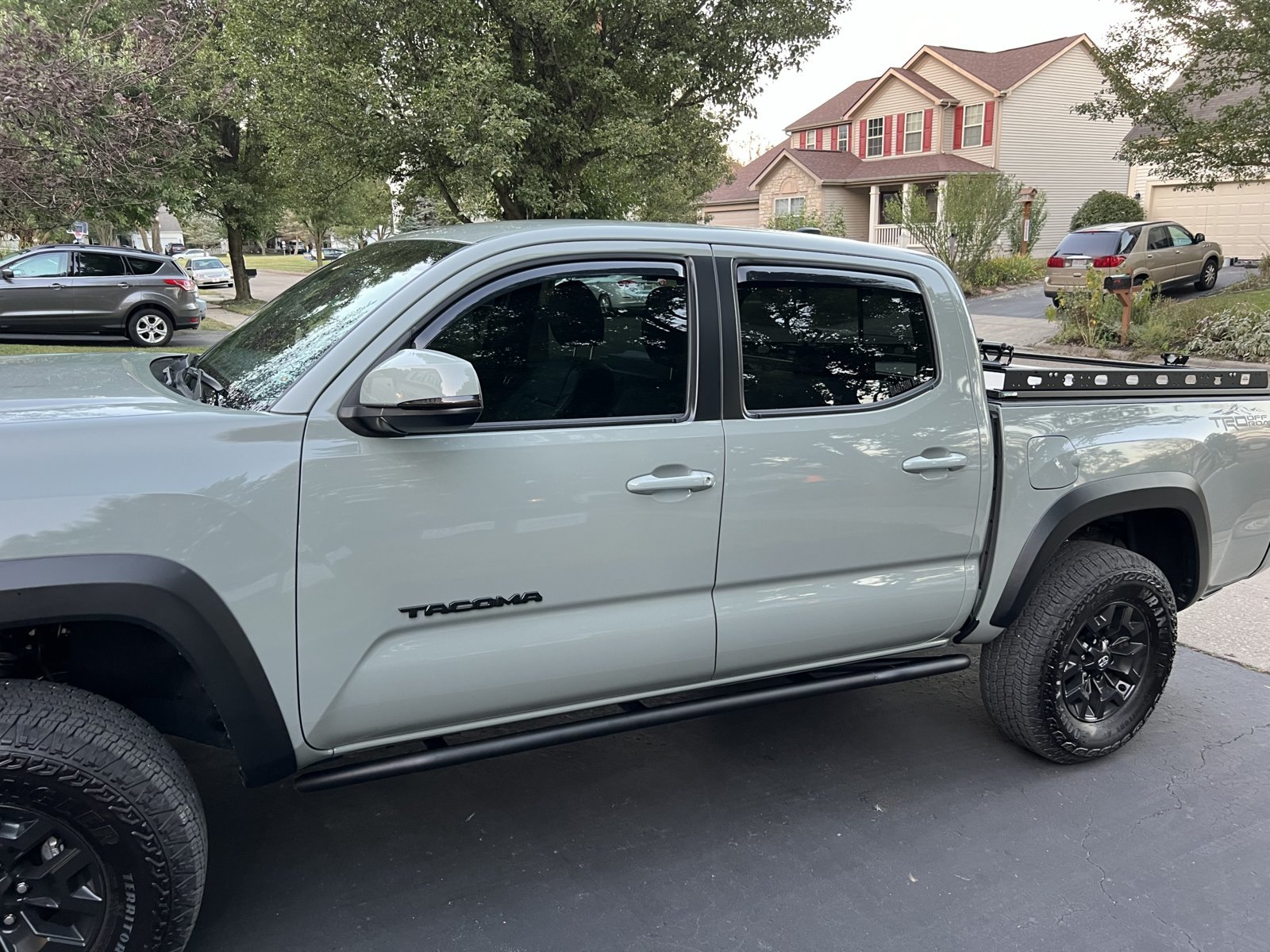

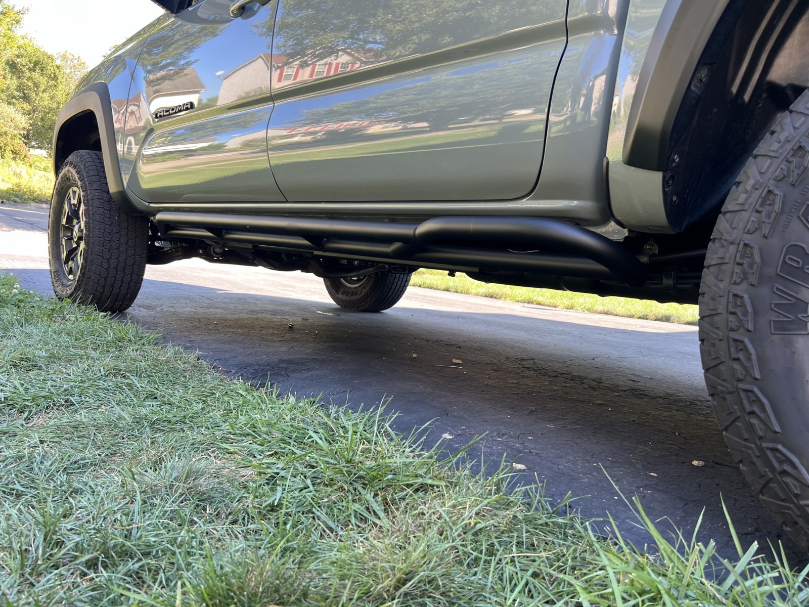

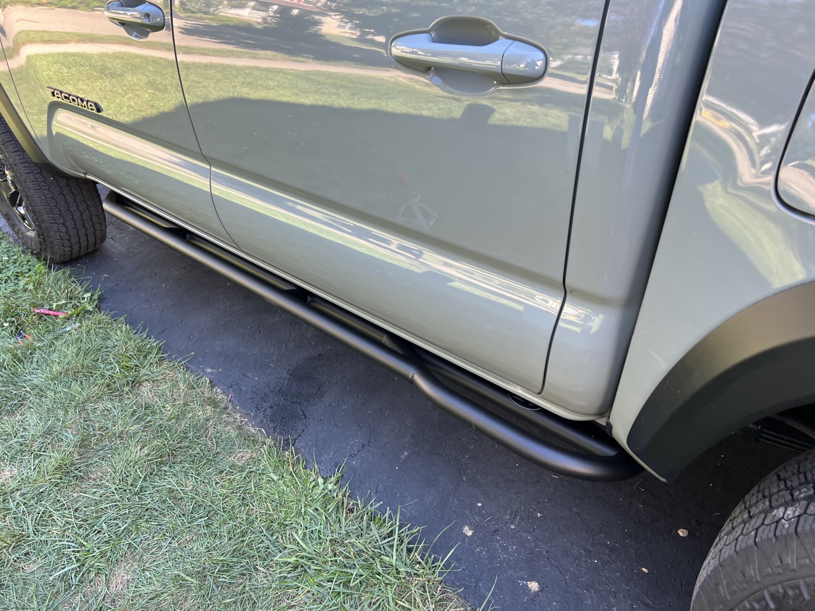

    If you go back to the first page there's a few photos, I'll put some up though so you can see some better angles. I don't have any great ones from the front, but this should hopefully give you a good idea of fitment. For the price, these cannot be beat, I do have gripes on their design and the angle, but who can argue for $760 shipped.IMG_1414.jpg IMG_1417.jpg IMG_1418.jpg IMG_1416.jpg IMG_1415.jpg IMG_1894.jpg

    Very nice man, they look great. I bought the 0 degree with the steps. I'll post pics once I install them.
