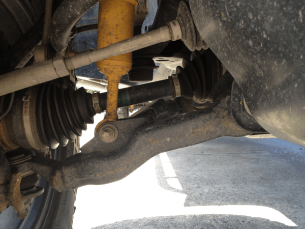

    I have the top plate spacers on mine with the 885's and love it....now my cv's arent at a really good angle...ill post a pic up of my cv's in a few minutes

    Yeah they have actually gotten better....

    Thanks dude. They do look good in that pic. Maybe I'll be ok at three inches. Or maybe I'll do the 2.5 and maybe later Install the top spacer. Decisions decisions lol. What to do?
