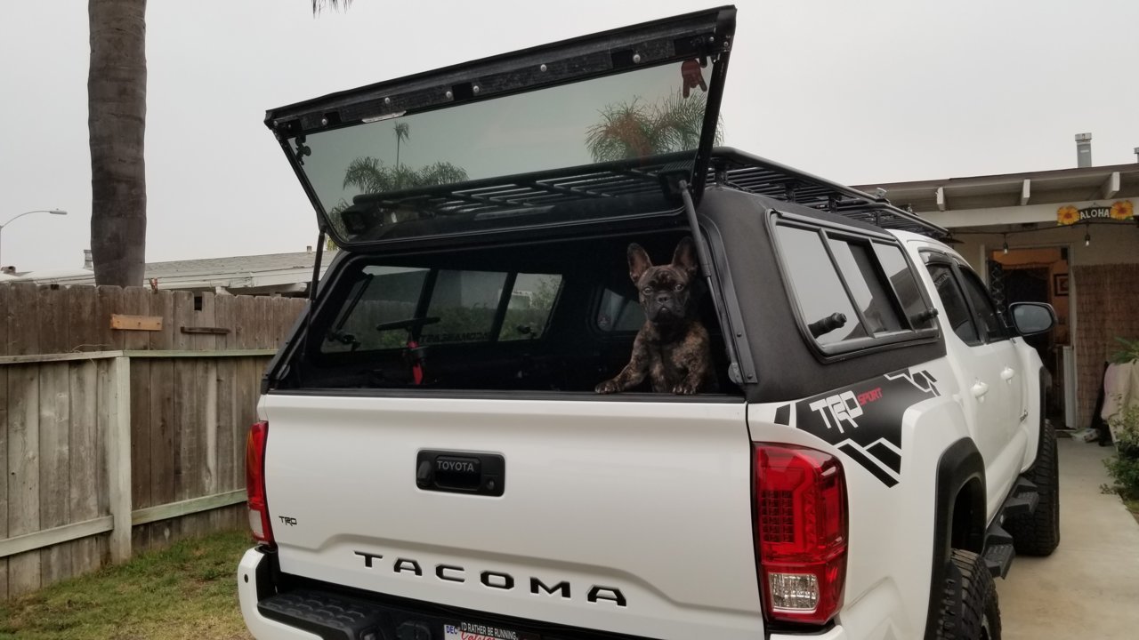

    I left my notched ones on with no issues. If I was going to sell my tonneau cover I would have just asked the buyer to swap out his un-notched ones which is no issue. But I'm keeping my tonneau. The one thing I did was take out all the metal hardware pegs, square plastic surrounds and rear small bumper piece as my ARE shell would have hit those and then I took the original screws and filled the bolt holes in since they would be showing with the notched plastic bed covers open. Now in your case if you swapped yours you really wouldn't have to keep those bolt holes filled. Another poster said the bed rail cover square holes would be covered but the lip of the ARE shell that I have doesn't cover those unlike other shells. Also, the new buyer can always just cut out his original bed rails too if need be for his use if he was not willing to swap his bed rails with you.
  8. Aug 20, 2018 at 10:14 AM
    garbagebarge
    garbagebarge [OP] Well-Known Member
    Jun 4, 2018
    #255487
    114
    Thanks for the reply and pics! That's a great Frenchie you've got there.
    I've got a SnugTop on order, from what I've seen it'll cover the cutouts. I've debated keeping the cover but I really have very little room to store it, and I doubt I'd ever need to use it after my canopy's on there.

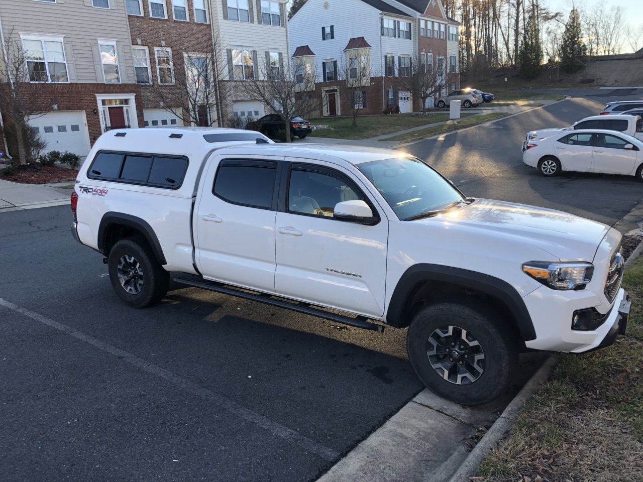

    Still need to wire it up and weatherize/seal it up a bit, but I’m pretty happy so far.
    Is there a harness or splitter that plugs into either brake light socket plug or trailer plug to avoid splicing truck wires? I’ve seen the Curt adapter but that has a logic board/dongle that needs power run to it. I’m basically looking for a splitter that has a 4pin or another light socket I can clip off. EB6E4756-E51E-48D5-9B26-AEC0A86B414F.jpg
