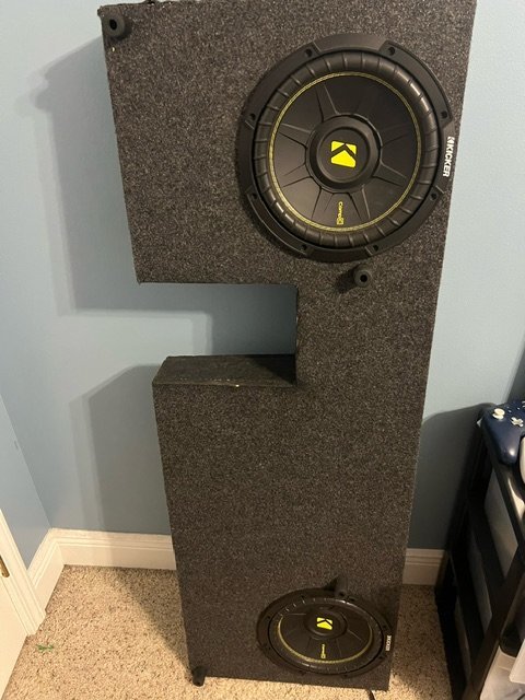

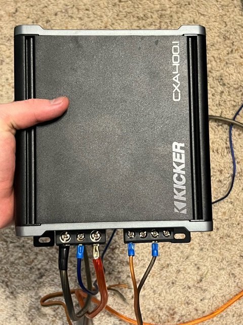

    I'm trying to install a Kicker CXA400.1 amp on top of my current system and was curious if there are any converters for the JBL system or what would be the best way to go about this. As i keep running into the problem that the convert does not support the JBL head unit. 2019 tacoma trd sport JBL SYSTEM

    Any LOC, and even the kicker amp, will work with the jbl system. Just tap into the jbl amp’s subwoofer output
    aside from that, you’re looking at something like the PAC AmpPro, which will run you about $350
