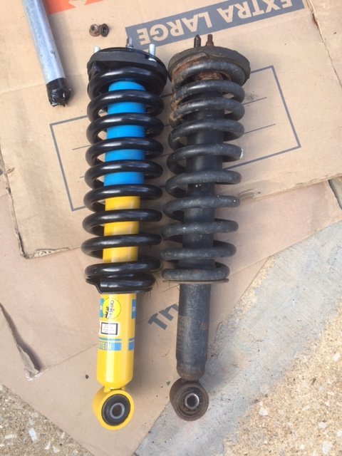

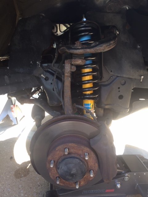

    Installed! Rides amazingly better. Next weekend is LBJs and rust removal/painting on select areas. Alignment coming as well.
    Hardest part was getting the nuts off the top of the shock tower.

    14mm ratcheting box wrench; makes it easy as hell to install and uninstall the top bolts.

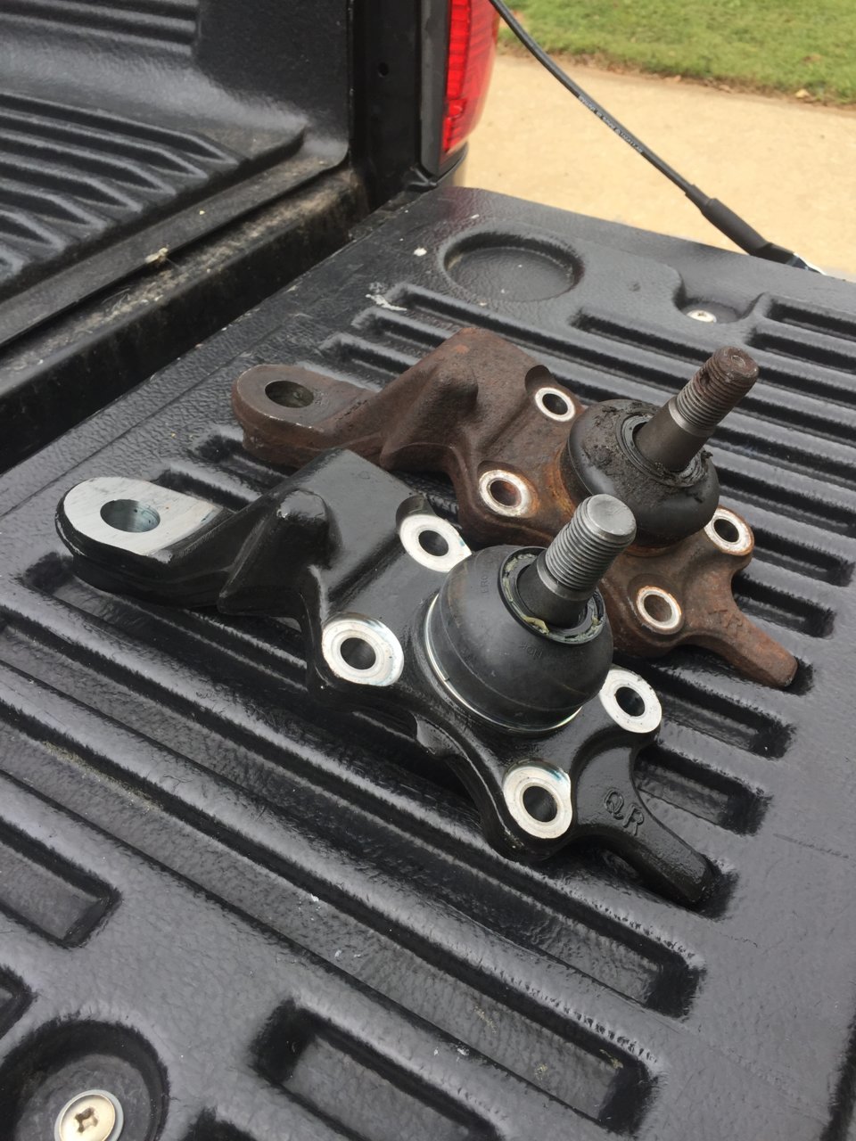

    LBJ's are now installed. Getting an inspection and alignment this week. Thanks all for the help!
    The old ones didn't have much play in them, but I'm glad to have replaced them before any thing happened!

    If anyone else hates the "jack jn the box" surprise from using a puller like I do I have a tip. Once you tension the LBJ with the puller just hit it with a hammer. Combing both methods saves you from a random pop.

    Next time, remove the castle nut and reinstall it upside down. Thread it on until its flush with the stud. Doing this will prevent the outer tie rod from going flying when you break it apart with the puller.
