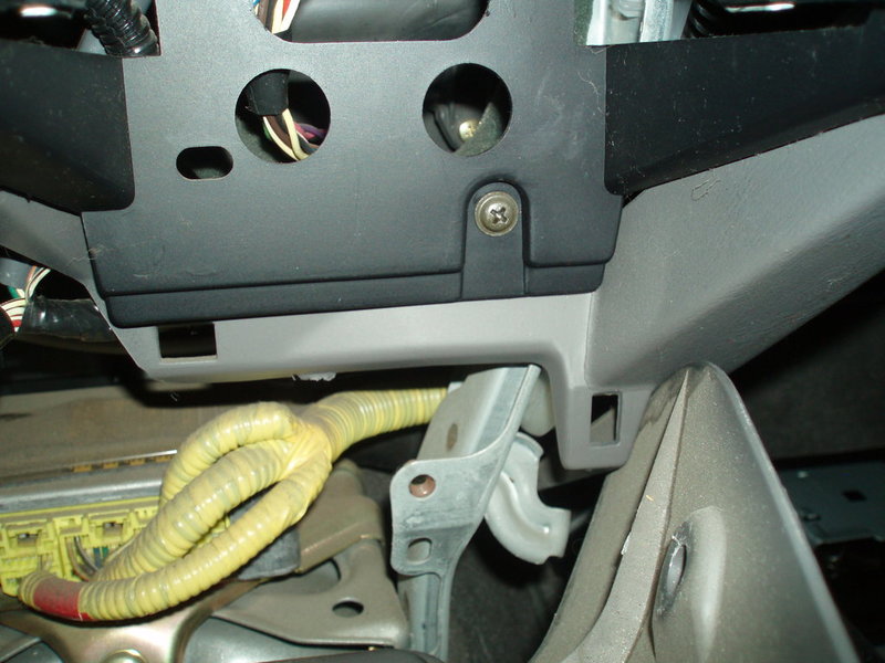

    Next I did some disassembly on the driver's side. The molded plastic panel under the steering column comes off after removing 5 bolts, I think (no photo). The air duct on this side was removed by taking out two screws and fiddling and finessing and doing a little cussing, but that allowed much better access to the pedals. Here are photos of the duct mounting screws and the duct out of the vehicle.
    There is a connector at the brake pedal switch. I unplugged that connector. The wires from that connector need to be separated to find the Green/Yellow wire and the Green/White wire. The red wire from the cruise harness was spliced into the green/yellow wire, and the violet wire #2 from the cruise harness was spliced into the green/white wire (There are 2 violet wires, one for clutch pedal and one for brake pedal. I don't think it matters which of the violet wires goes to which pedal.) I again used Scotchlok connectors, and I should have reversed the direction of the connectors so the cruise harness wires were pointing out the other direction, just for the sake of tidiness. The violet wires from each pedal need to be connected to each other as well. There are very good diagrams included with the kit that show how the brake and clutch disengagement wires are to be connected.
    I replugged the connector into the brake switch. This is when I also did the grounding of the blue Tach wire to the handbrake assembly.
