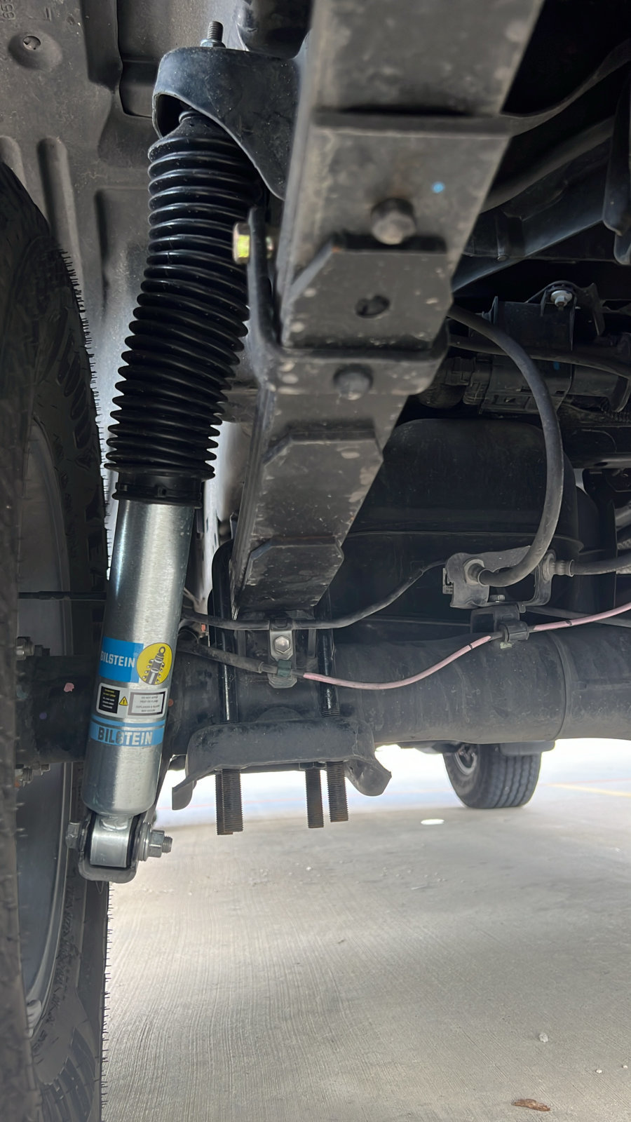

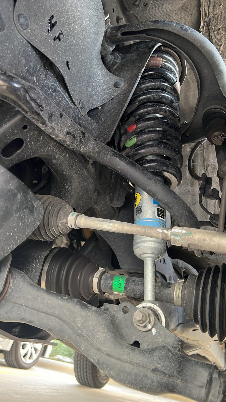

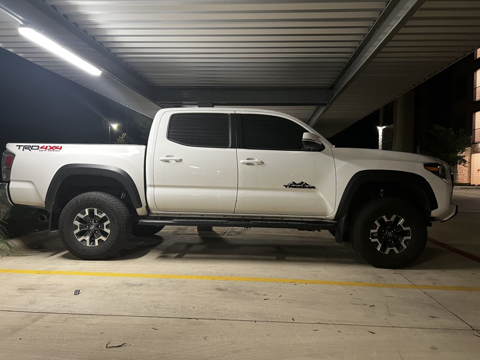

    Fixed the stance, however bilsteins in front into 2 position. rear is ok on icon aal 1.5.

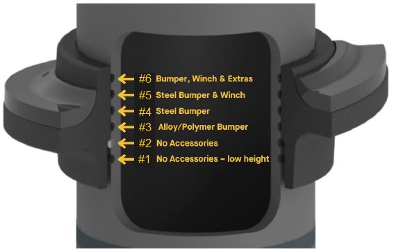

    I was curious because I'm getting some pre-assembled OME MT64's shipped here.
    0-3" depending on the extra weight.
    I'm just hoping I guesstimated right to keep it at 2" or I'll be pulling them back off and adjusting the clip.

    At the moment around 300#'s
    Their clip settings go by accessories and not a number.
    They don't include skid plates or sliders.
    That's all I have right now and it's pulled the current stock coils with spacers, down a full inch.

    I have the icon add a leaf installed and it gave me 1.5” of lift. 23” from fender to hub measurement.
    I had the fox 2.0 initially but man the ride was rough on road !!
    Had to swap to bilstein 5100 to enjoy driving my truck again.
    Icon aal is stiff, especially the first 2k miles. If I have 200-300lbs in the truck or a truck full of gear/people it’s real plush and smooth.
    no vibrations yet at 3k miles in. Going to drive it 2k more to see if it gets any better.
    I used the same setup on my 1st Gen for 40k miles and it was very enjoyable. My 3rd Gen not so much! I’m at 15k miles on the ODO atm.
