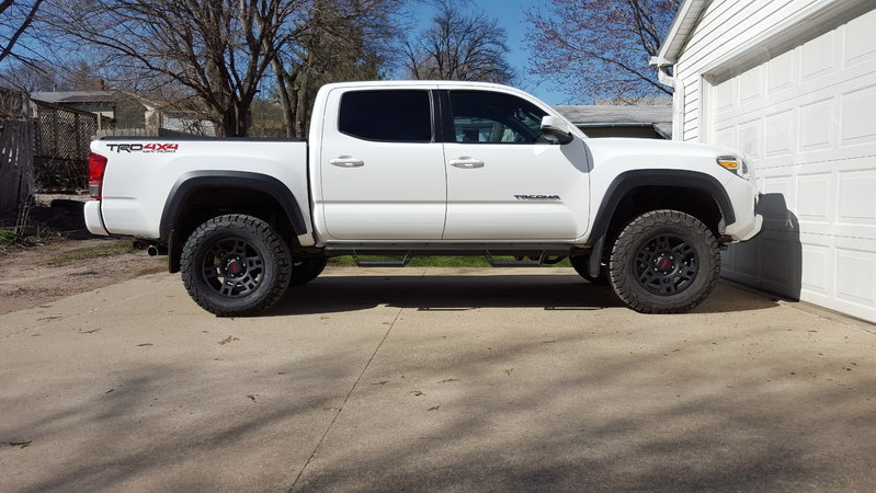

    Well, did a 2" lift here and even did the diff drop and not even 20 miles later noise. Did a lot of research on this. I would recommend people go to http://eastcoastgearsupply.com/i-8536125-toyota-8-clamshell-bushing-eliminates-needle-bearing.html and watch their videos. They explain the issue very well and why it happens.
    I tired it in 4x4 and went away, 2wd comes back. Couple times it stayed away but usually comes right back again. Anyway went to dealer and setup appointment to have the TSB bearing installed. The TSB bearing is a little longer which gives a little more support but I guess I am not going to hold my breath that it will stay fixed. And as others have stated the TSB bearing is for up to 2015 model year however the bearing will work on 2016 also from what I am told. I crawled under my truck and moved the shaft up and down and was blown away at the amount of movement. I guess if it doesn't work I see a bushing in my future also. 999crazy said the dealer did the bushing for him so I guess if the new bearing doesn't fix it I will see if they would do that for me also.
    So are there many people who have had the TSB bearing installed who have not had anymore issues and if so how many miles on it.
    With the amount of slop in the spider gear I can't believe it would last very long. Oh and if any of my info is incorrect please correct me
    so there isn't any misinformation. :anonymous:
