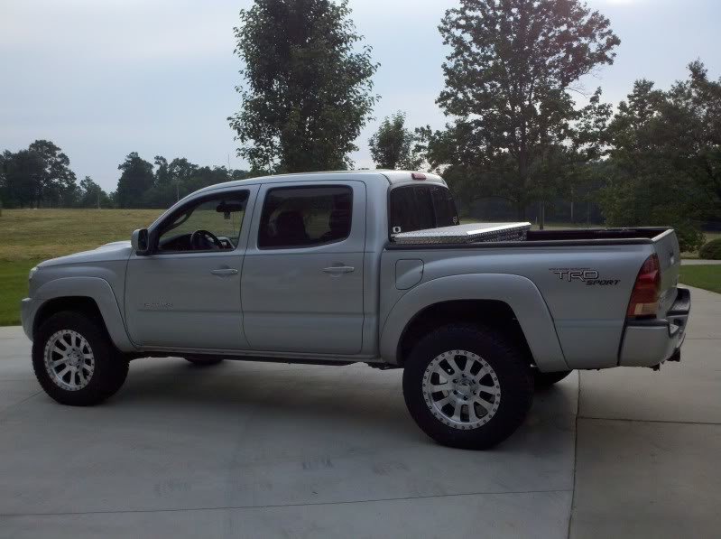

Installed 285/60/18 Cooper Zeon LTZ w/ Eagle Alloy 063 rims and now I'm rubbing

    Not too happy since everywhee I had read said I wouldnt rub with this size tire and no lift. Guess I'll have to trim

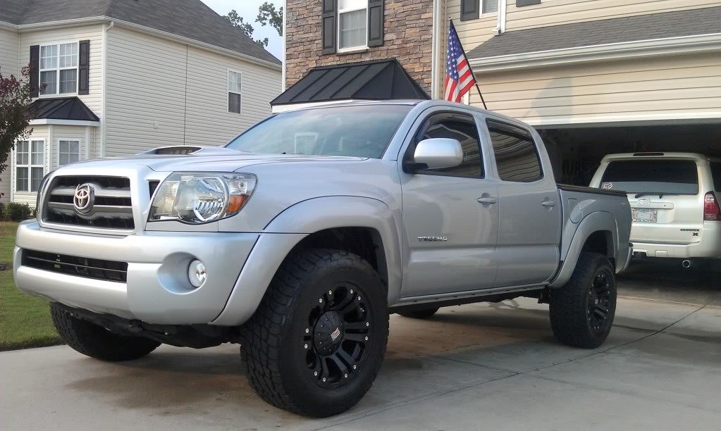

    Yeah its crazy. There's a guy on here with silver doublecab that has XD monsters and the same tires. I thought the offet on my wheels was the same as his cause he didnt rub. But apparently not.

    Don't feel bad because I just put on Monsters with the -12 offset and 4.5 BS with the Nitto Terra Grappler (285/60/18) and I rubbed like crazy before trimming the fender flares on the front and back of the wheel well. I still rub a little bit in the fender well but have not had the time to find exactly where it's still rubbing so I will need to find the time tomorrow to see whats still making contact and start trimming some more. Nothing a heated razor blade won't cut through I'm sure. Still not sure how guys are saying they ran this set up with no trimming and no rubbing. It does not even seem possible. When the guys backed my truck out of the bay today they stopped dead in their tracks before jumping out all concerned. I knew exactly where it would be rubbing and told them not to sweat it as I figured I would be trimming once I got home anyway. I will probably order some 5100s next week so I am sure with that all rubbing will be remedied unless I get it done with trimming. Just trying to avoid trimming the wheel well liner because once that is cut I would imagine all sorts of dirt, mud and who knows what else will build up behind it and could lead to rust issues. Again, I still don't think guys are being 100% honest about running this set up and not rubbing without any trimming whatsoever. Either that or my truck with 15,000 miles has a real saggy front end.

    I ordered the wheels through Mr. Wheel Deal, so I don't know the exact specifications of the rim. They are 18x9 and DO stick out about an 1.5 inches

    According to the Eagle Alloy website, that size wheel is only available in a -12 offset

    Its a mystery I know. But I have trimmed quite a bit and have eliminated 80% of the rubbing I'd guess. I've gotten used to it, but it did suck having to cut up that truck, when I was so sure I wouldn't have to.
